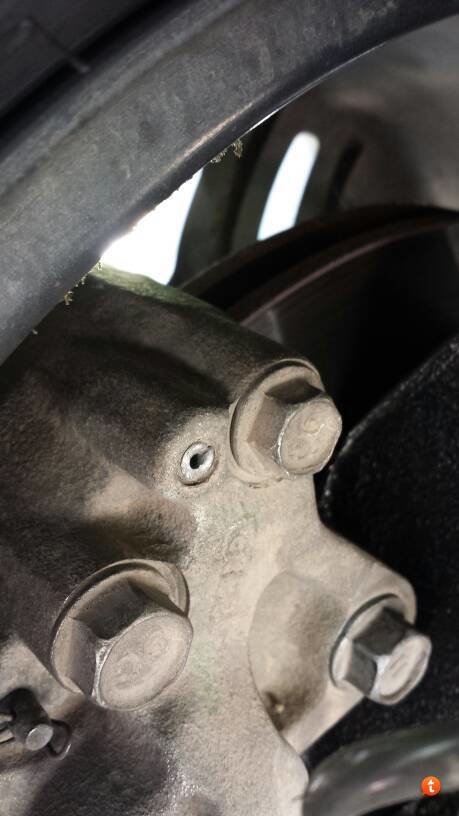

    Its on the inside of the driver caliper. The bleeder valve nipple broke off. Im getting a new oem valve from the dealer this week so if you think you can get that out you will save me over $300 on a new caliper

  14. Jun 8, 2014 at 1:10 PM
    Manwithoutaplan
    Manwithoutaplan [OP] the full Monty
    Jan 30, 2008
    #4500
    54,641
    ID
    I would do this . I had to buy big extractor to remove my diff plug.

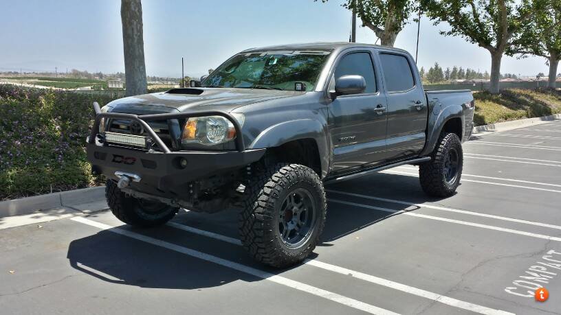

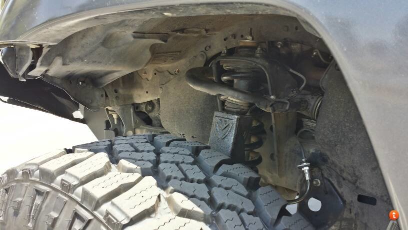

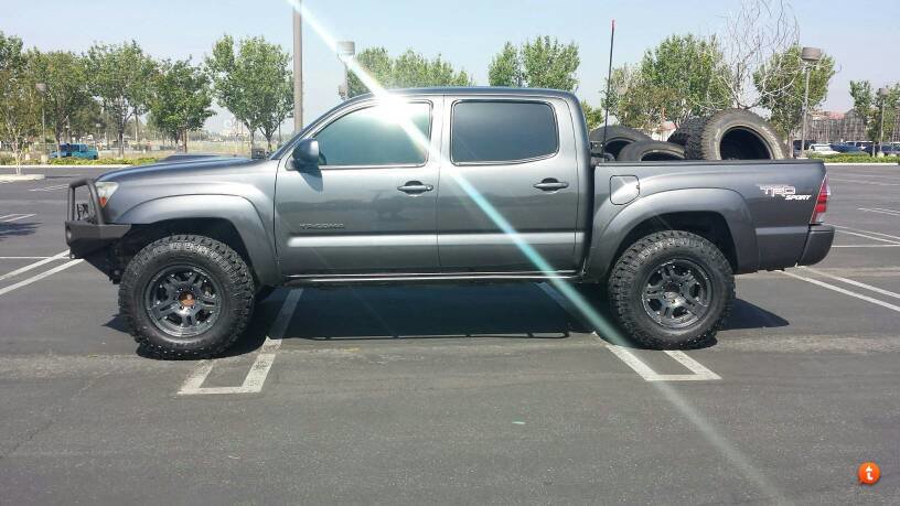

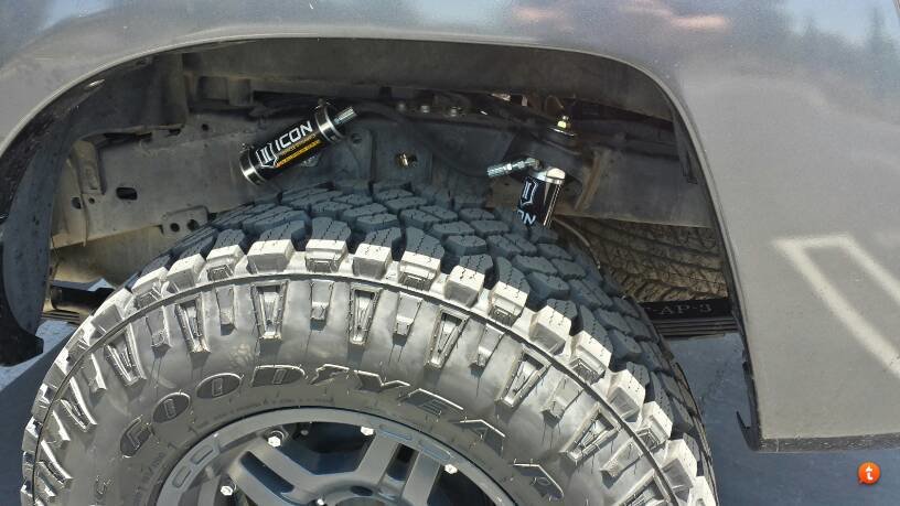

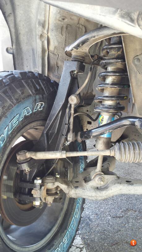

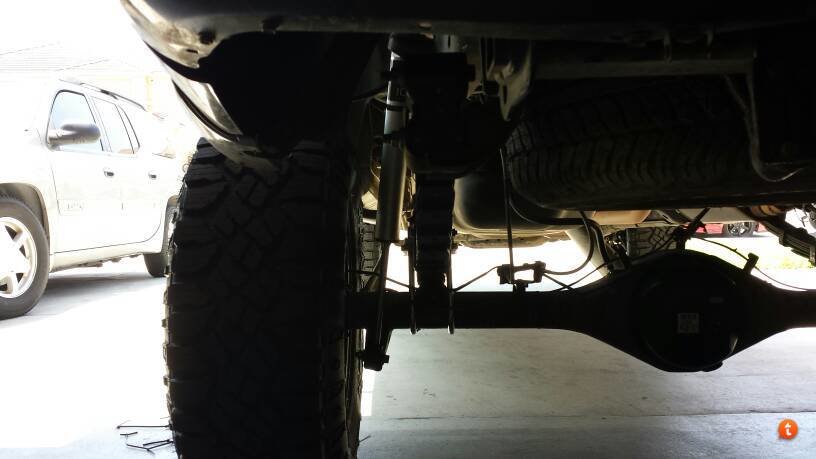

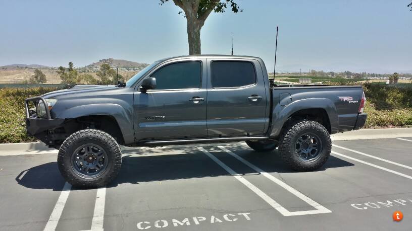

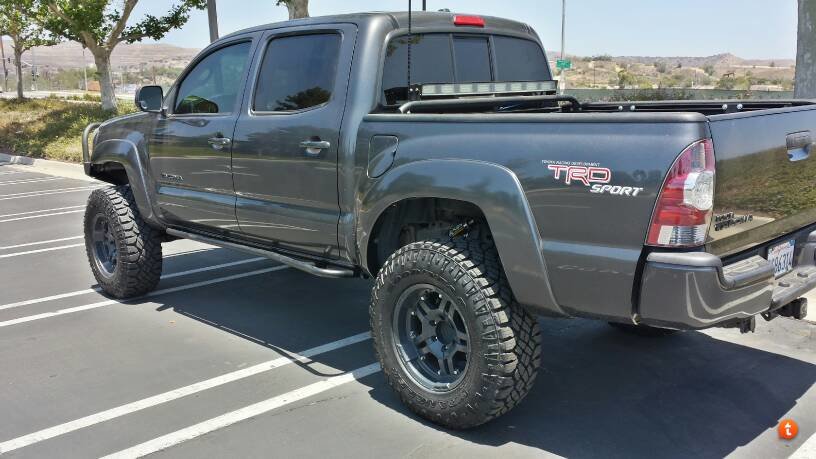

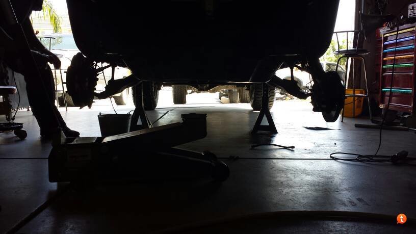

    y4a7eryt_37c2938d4820cf5a20940354bba4290b9005046c.jpgjapavyta_b151255daba81b0b7c8079300bdfb3d3f17b1d40.jpgare6yryz_f05f143a6b2c19c11aef79c67728642044684c68.jpg8apa9y6u_9fcaa31a7fa21f8bae187bdf8caf852237fb7dda.jpg2y4ubu5a_79bb85f1697cfebc053c8417b71857f586267143.jpgvuta5uru_3490eb7ee6423041f4f4265f9f930c40f7f89e28.jpg
    FLEX
    atyhe8ur_d3f18ac1b9946bbc3a534cd23209017b52436aca.jpg5ybaqe3e_dd040921ae13fb9dfab84acc05161e4f1da976cc.jpg
    Right (driver) with Maxtrac spindle
    Left (passenger) with stock spindle
    BEFORE PIC
  17. Jun 8, 2014 at 1:34 PM
    Lpheat22
    Lpheat22 Well-Known Member
    Jun 23, 2012
    #81202
    1,553
    Albert
    La Puente, SGV
    09 PreRunner SR5 DCSB Sport
    DDM Tuning 6000k HID Headlights, Pioneer X5500BHS, CSJumper switchbacks, Fox 2.5 w/reservoirs and CDC adjusters, Sick Nick PreRunner Tube Bumper, 17 in SCS Stealth 6's Matte Gunmetal, Toyo ATII 285/70/17
    Looking good man
  18. Jun 8, 2014 at 1:36 PM

  19. Jun 8, 2014 at 1:57 PM
    Hiatt1991
    Hiatt1991 Well-Known Member
    Aug 19, 2010
    #41917
    7,985
    Hiatt
    Ventura, CA
    2022 Toyota Tacoma SR5 DCSB 4x4
    4" Bodylift 20" Offroad shock spacers Turbo Encabulator
    Damn. Looks really good Anthony, now you just got to get some icons for the front and it will be done. Lol
  20. Jun 8, 2014 at 1:58 PM
    Manwithoutaplan
    Jan 30, 2008
    #4500
    54,641
    ID
    and some uppers.
