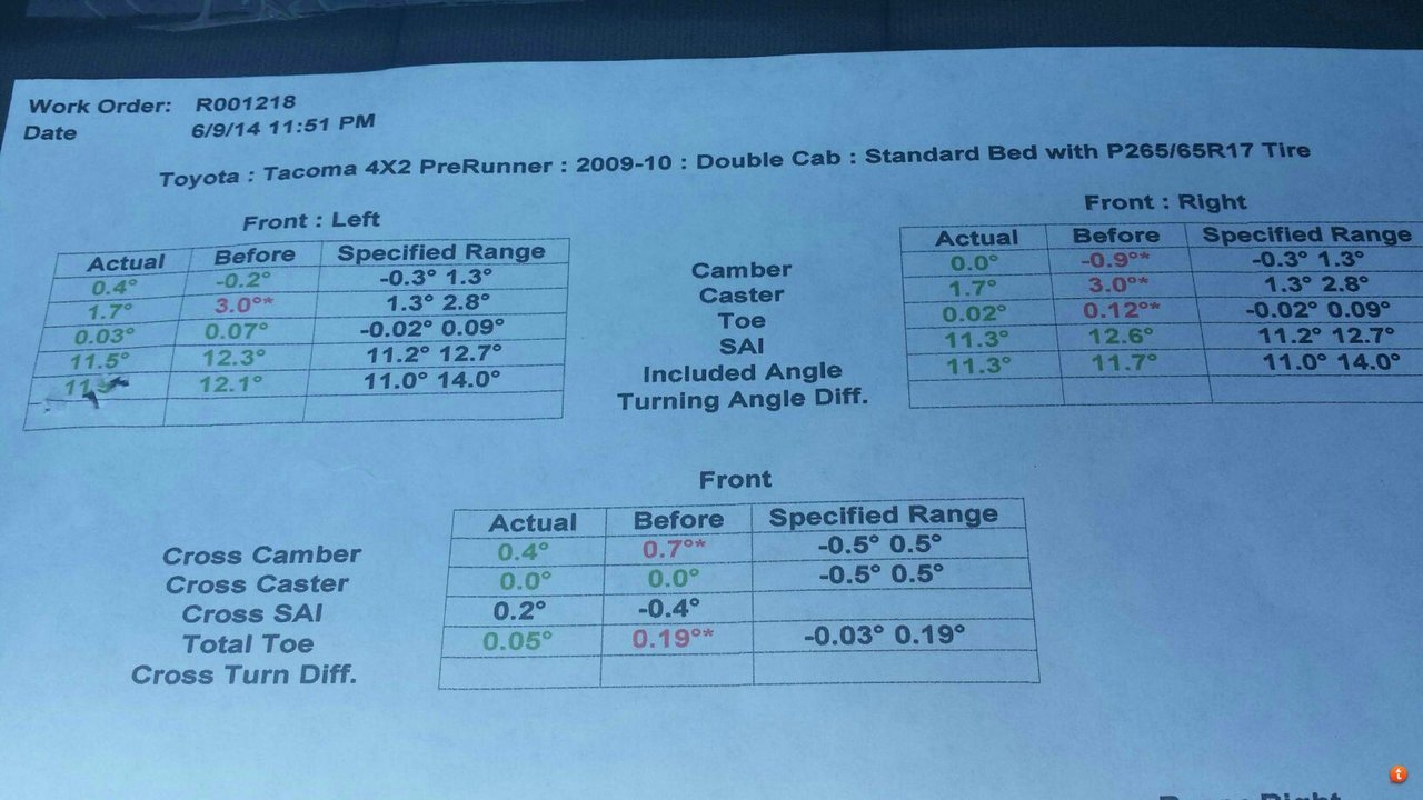

    You get brand new tires, mounted and balanced. Drives perfect for a week. Install lift, still drives great except for a crooked steering wheel. 1 day later you get an alignment. Drives just fine to the shop. Leave the alignment shop and it drives great and straight as an arrow BUT now it steering wheel suddenly has an intense wobble only while applying the brakes between 40 and 60 mph. No shimmy or vibe while driving or coasting, only while braking. First thought would be warped rotora but unless the rotors can warp themselves for no reasom instantly while getting an alignment then I highly doubt this.
    Can a work or loose suspension part in the front end cause this? Possibly the alignment is causing this somehow? What would you check first?

    Anyone have any advice for my wobble situation?

    Anthony, this may sound stupid, but try rotating your tires. It's worked for me before.

    Castor should be more than 1.7° especially if you're running extended coil overs and a aftermarket UCA's ..If that is what your have
