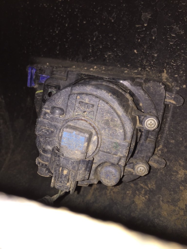

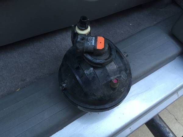

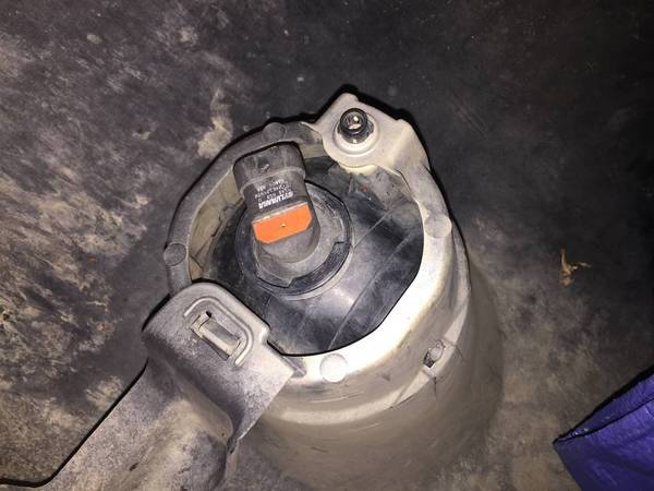

    Estock
    05-11 same fogs (bigger ones)
    12-15 same fogs (smaller ones) like scion xbs corollas and tundras

    And here's how ours mount:

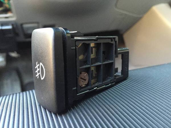

    If wiring is there then you need a stock switch and a oem relay. If its not prewired you can still the oem switch but wiring is more challenging because its a 4 pin switch. If you use an aftermarket switch on the the stock wiring, itll work but the light wont work on the switch because the oem fogs are ground switched instead of power switched

    Which is weird because I got another stock fog switch for my lightbar and I tried splicing into the wire on the existing fog switch for the button light and it wouldn't work. So all I could locate was another ignition power lead to power the button light.

    Thats weird because thats where i tap all my connections for dash light circuit when i install otrattw switches that have a dash light led. It should work but requires both bottom wires for power and ground and the dimmer controls ground

    I thought I was getting a good connection but maybe I wasn't. Do you know if that wire connects back to the relay or does it just ground on its own somewhere? Cause in theory then the button light is already getting power from the power switch leg so you could just run that wire to any ground anywhere and it should work since pushing the button then completes the circuit?
