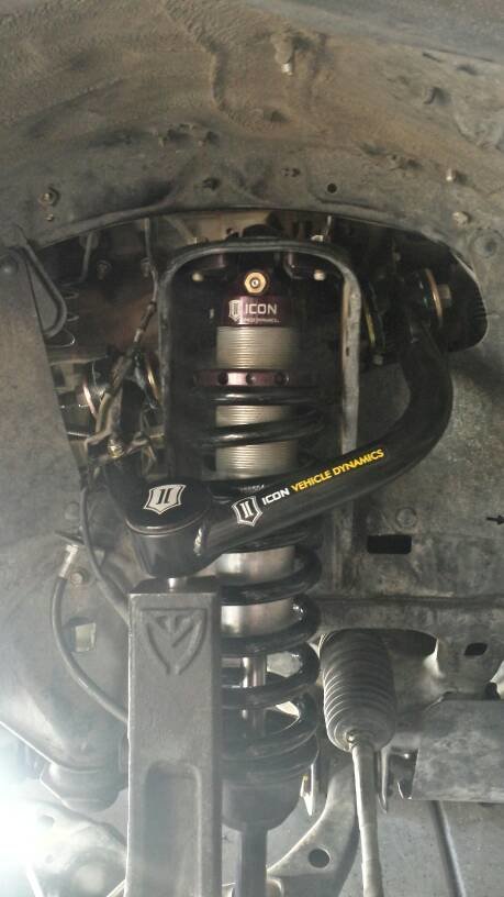

    This is mine and id already prefer less preload (less thread showing)
    I have a 4" spindle which provides the lift. The preload on rhe coiliver just makes up for the sag i get from the weight of my plate bumper and winch. My plan is to up the spring size and rate to reduce preload. Icon comes with 13" 650# spring. Ill put a 14" 700# spring with no threads showing and have the same lift. With stock front bumper you could run a 14" 600# or 650# and lower your preload for a better ride to avoid jacking up the suspension higher.
    But what was already said is true... more lift wont fix your rubbing. You have your caster adjusted forward/backward to help move the wheel away from the problem spot but at the end of the day you'll still need to just trim a bit
