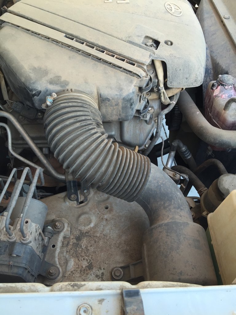

    Ding ding. Any one know what I should cut the hole with?

    Coolant overflow a bit?

    Pilot hole and then a hole saw with a nice arbor. Slow speed to score it or that bitch will jump around and put some nice patterns in your fender.

    Yeah :/
    Okay sounds good. What size hole saw should I use? I was reading people used a 4"

    No clue. Just measure the piece that needs to go through the fender.
    I think miacevedo (sp?) was the local who installed his. I'm sure he'll chime in.

    I reccomended a DreMel or a grinder with cut off wheel better bet then to hole saw

    I have that. I didn't have the whole saw. A dremel would be best I think but I will have to use the grinder and wheel

    When I think of a grinder I think of a wheel atleast 3-4" in diameter...how are you supposed to cut a round hole with that?
    Maybe I'm just used to hole saws. We use them daily at work so I have access to diamond tipped blades.

    I think I'll cut a smaller square and round it out to a larger hole with the grinder?

    I know how to use one just don't have one big enough

    Gotcha. They are $20 at HomeDepot for the regular kind.Good luck.
