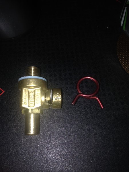

    Dec 26, 2012
    #93790
    4,888
    Tom
    SoCal
    https://www.tacomaworld.com/threads/airdogs-2012-prerunner-access-cab-slow-build.264263/
    Fumoto Valve solves it all. No plug to remove ever!
    MadTaco461 likes this.
  18. Nov 23, 2015 at 10:31 AM
    PerfectTekniq
    PerfectTekniq I'm undefeated in the UFC.
    Feb 22, 2011
    #51683
    9,942
    Pepe Silvia
    Claremont, CA
    2009 Super White 4x4 DC SB Sport
    AllPro Front, AllPro Rear w/ wraps, AllPro IFS Skid, 5100 w/ 885's upfront, Duratracs, Front Superbumps, BuiltRight UCAs, Dakar Leaf Pack, Extended 5100's, AllPro Flip Kit, Rear Superbumps, Extended SS brake lines WeatherTech Floormats, TRD Intake, ScanGaugeII, TRD SoCal, Grillcraft, Wet Okoles, Cobra 75 w/ 4' whip
    I originally looked at those when I first got the truck but thought I read that it will hang lower than my AllPro skid. That definitely looks like it wont.

  20. Nov 23, 2015 at 11:20 AM
    adriancast
    adriancast Well-Known Member
    May 20, 2013
    #104544
    2,310
    Adrian
    Ontario, Ca
    2005 Tacoma 4x4 TRD Off-Road
    -2.5 Donahoe Coilovers -All Pro Standard Leaf Pack -All Pro U Bolt Flip Kit -Front/RearWheeler Super Bumps -Extended rear Bilstein 5100s -Flowmaster 40 Series -All Pro IFS Skid -All Pro Transmission Skid -Bruteforce Hybrid Bumper -30" Double Row LED bar -400 Watt Anytime -TRD Seat Covers -ABS Kill Switch -Locking Center Console Mod -Rear Differential Breather -BHLM -Anytime Fog Light Mod -Toyota Hilux Snorkel
    Yea. They have one without the nipple too so it's smaller. I have the all pro ifs skid and don't even come close to the skid.
