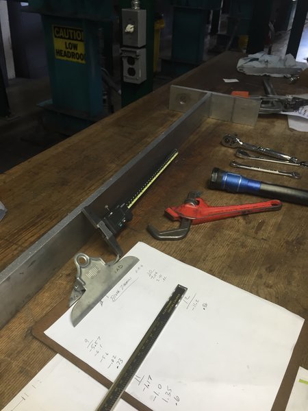

    So weird. I just sat down after spending the last 3 hours doing alignment on our train wheel bogie assemblies. They all gotta be 1mm toe in adjusted by the tension of the side guide wheels using shims. And their are 14 of them to do per train.
    Bogie assembly
    Our tools a long straight edge and depth gauge.
