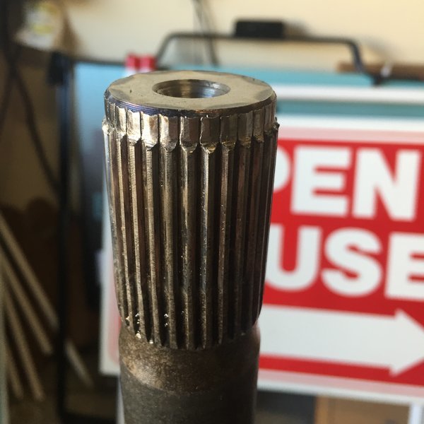

    image.jpg Left side axle :(

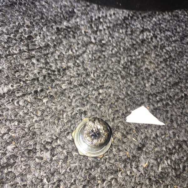

    Getting ready to pull the 3rd now that both axles are removed.
    Drain plug

    Ouch. It is painful dealing with rearends. Weird that it just chewed up the end as if the shaft slid out. Check out wheel bearings too.

    Actually the shittiest part was taking the brake pads and all their associated springs apart. Everything else was a piece of cake including the 3rd...it just slide right out. I did check the wheel bearings they are solid with no play in in any direction. I just got back from dropping all the parts off at Yotamasters. I'll find out soon enough exactly what happened.
    Just a bit painful. On the bright side I'm getting it regeared to 4.56...so this is just forcing me to do what i've wanted to do for a while now. Its just going to cost a bit more. Though Yotamasters seems to be very reasonable and extremely helpful. I was impressed with the customer service so far.
