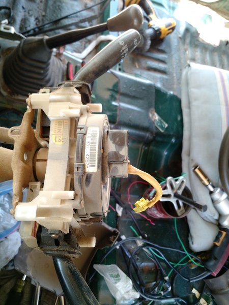

    Not a fuse
    It's the clockspring (spiral cable)
    Happened to mine too a little while back
    Cruise would turn with the steering wheel turned not at the 12 o clock position

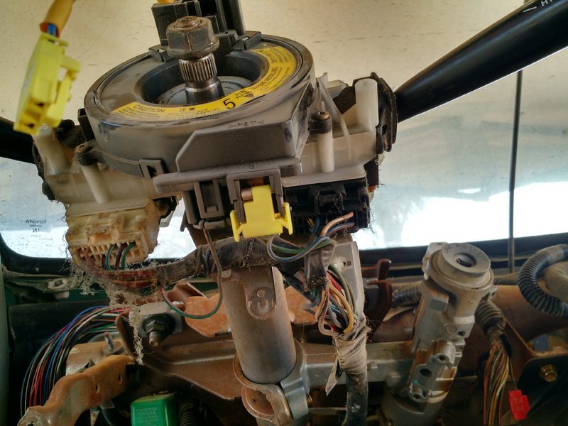

    Well if anyone needs one. I got one. I have a racing wheel so i don't need it. You can check to see if the serial works with your truck. Not sure if they changed over the years.IMG_20160820_155545695.jpg IMG_20160820_155618230_HDR.jpg

    They're different
    Between 1st and 2nd gen
    Even more when they have steering wheel controls etc
