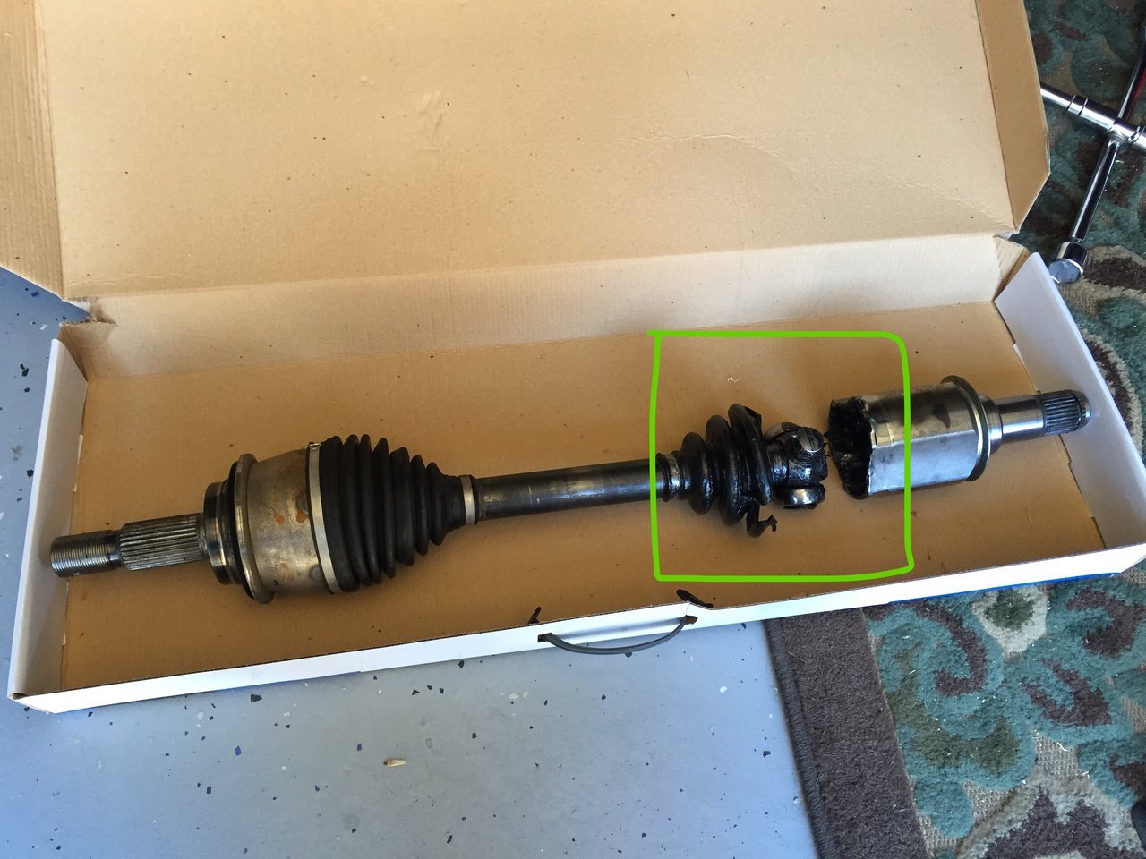

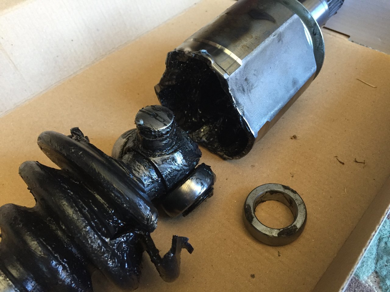

    So I've been having an issue w my passenger side cv axle (vatozone) lately. Went to cleghorn last week and the inner broke. I thought it was normal because I was doing an obstacle. I changed it out a few days later. I test it out the first time and smooth like butter. 1 min later after making a left turn, I try it again and bam grinds and pops out. My only guess is, axles are shorter than OEM, I got two malfunctioned cvs..... or i have a problem with my passenger side differential.
    I just bought an OEM cv axle that is coming tomorrow to compare the size of the new replacement I have. My driver side is also a vatozone cv axle and no problems so far. Put them both in a year ago.

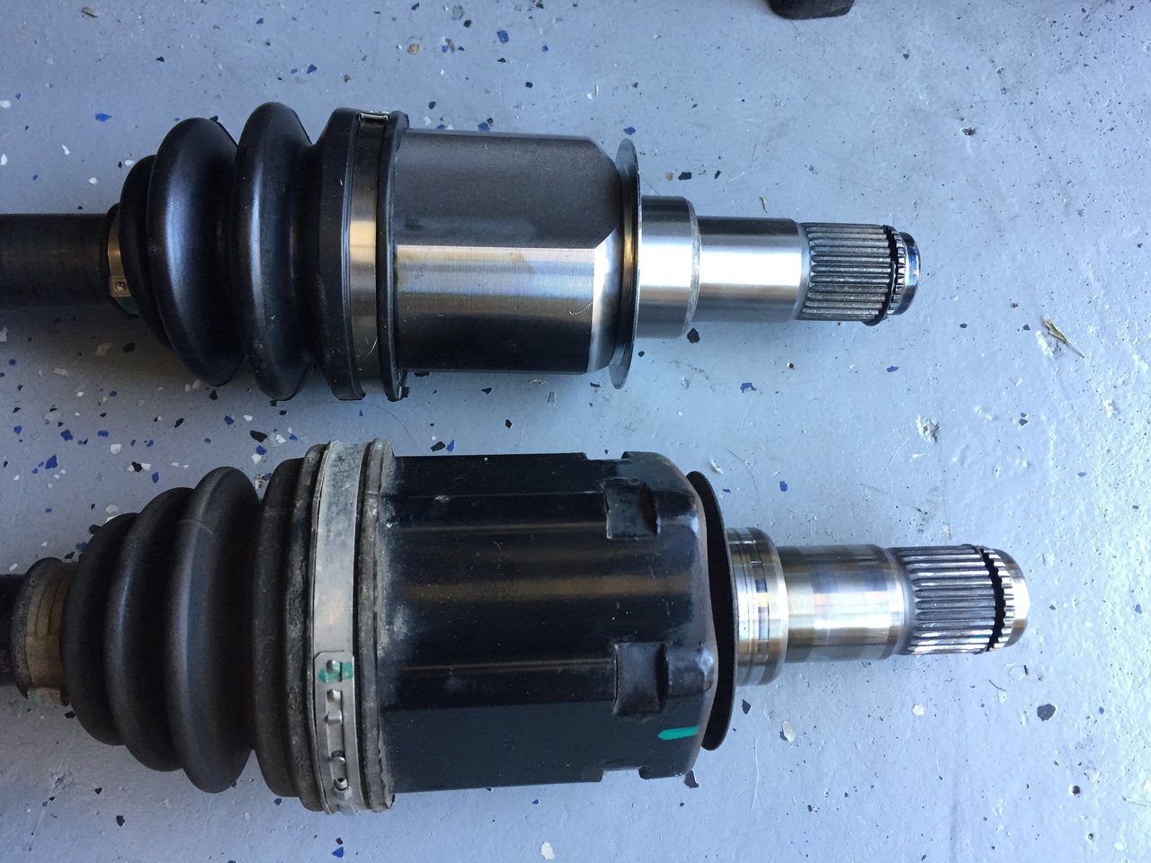

    Well the Vatozone CV axle is half an inch smaller than the OEM and a lot thinner. Pic below is a comparison. The left side is lined up perfectly.

    After checking kragen, vatozone, pepboys and Napa. Napa looks like the only one from their website pictures that has the same design as OEM.
