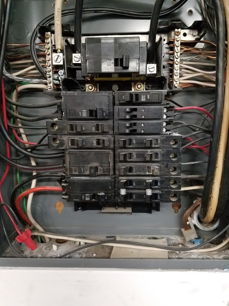

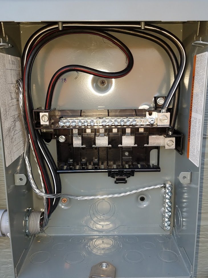

    i have a sub panel for my new air conditioner. I have the neutral and ground separated. But in my main panel bought the neutral and ground are on the same bar. DO i need to link the neutral bar and ground bar together in the sub panel.

    No in a main it is ok. In sub panels they need to stay isolated.

    100 amp main.

    sub panel 50 amp

    why do they need to be separated in the sub if they are together at the main.

    Lools good but need to use electrical nolox when using aluminum, it's a grey wet lubricant, for panel connections.
    Something about how power is distributed through the ground and the neutral in a subpanel when coming back from the appliance you don't want to overload The Returned/unused too much resistance.
