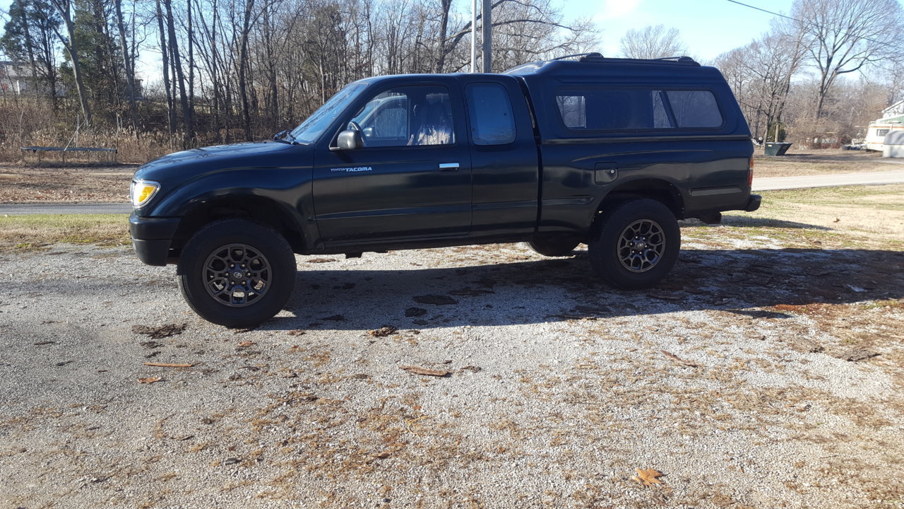

    I rehabbed mine too. Almost same color, but a little different style shell. I used Lexan for a window that was broken out. So far (6 mos) it still looks really clear/scratch free.
    I added the Isuzu Rodeo rack (salvage yard $15.00) to the top mainly just for appearance, but it will carry a few boards or a ladder, but in hind sight, I think it looked better without it. I may still pull it before Winter and just caulk the bolt holes.
    Edit: BTW, I didn't prime it, the paint was faded so thin I sanded all the way through to original primer with just normal prep work.

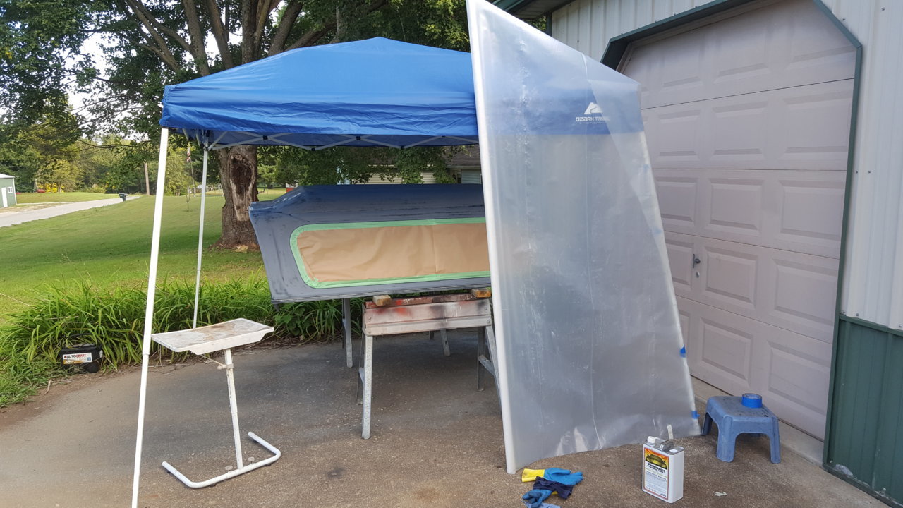

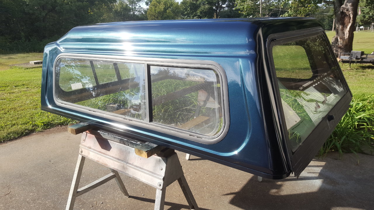

    I wet sanded with 400 and then 600. I used 2 part paint, Nason brand. Nason is some of the cheaper, but professional, auto body store paint. But, I used a $10 Harbor Freight spray gun and sprayed outside in that little plastic tent closed in on 3 sides. So, I was glad is turned out pretty good. I did get one run, but it was small.
