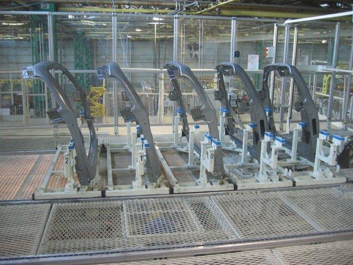

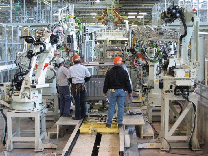

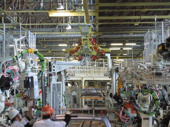

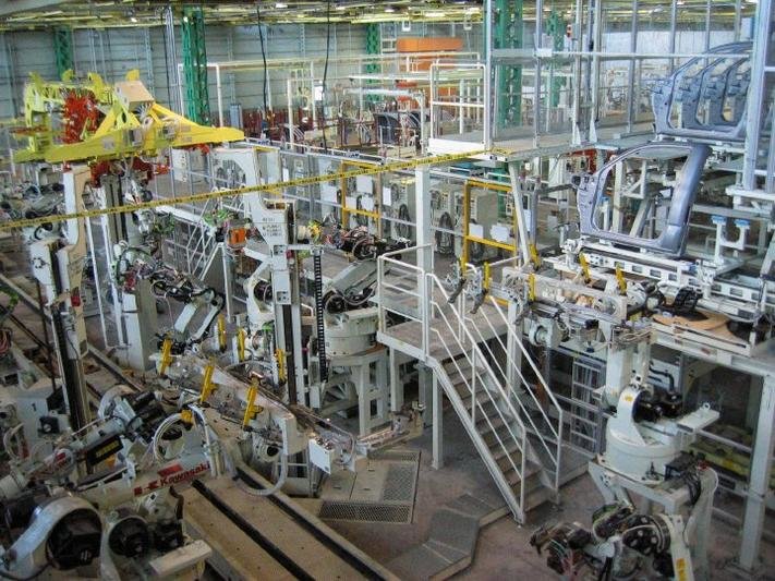

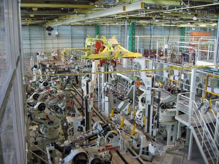

    This is the framing and body tack line. Where all the cab pieces meet and are tack welded before moving on for lots more welds.
    The large yellow thing hanging in the air is the Jig used to hold all the pieces in place while being tacked. There are 3 seperate jigs, B,C and D or Basic, Crew and Double Cab.

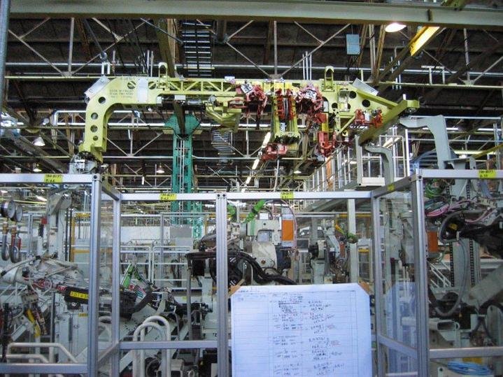

    Another shot of the jig. This method is becoming more common in plants that produce various vehicles on the same line.

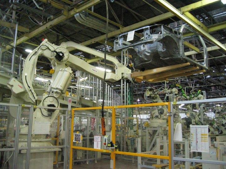

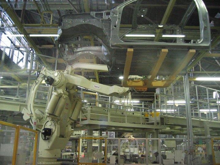

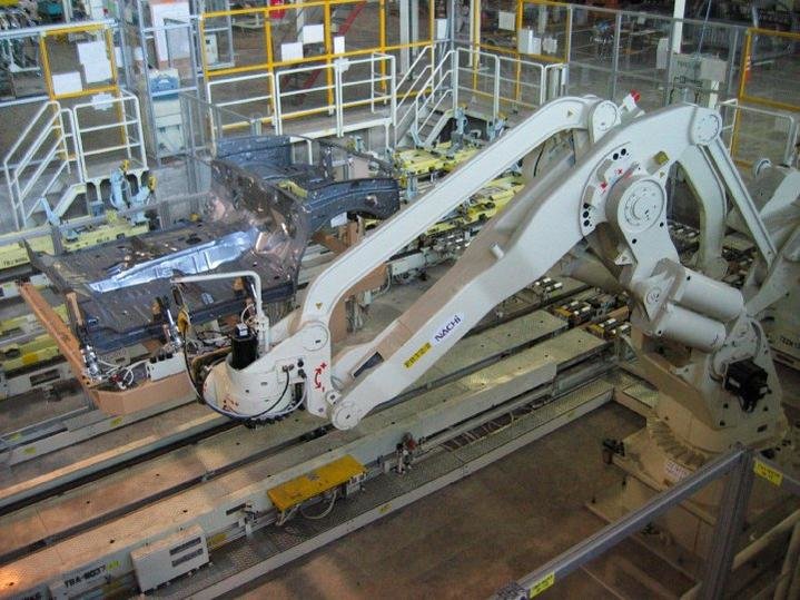

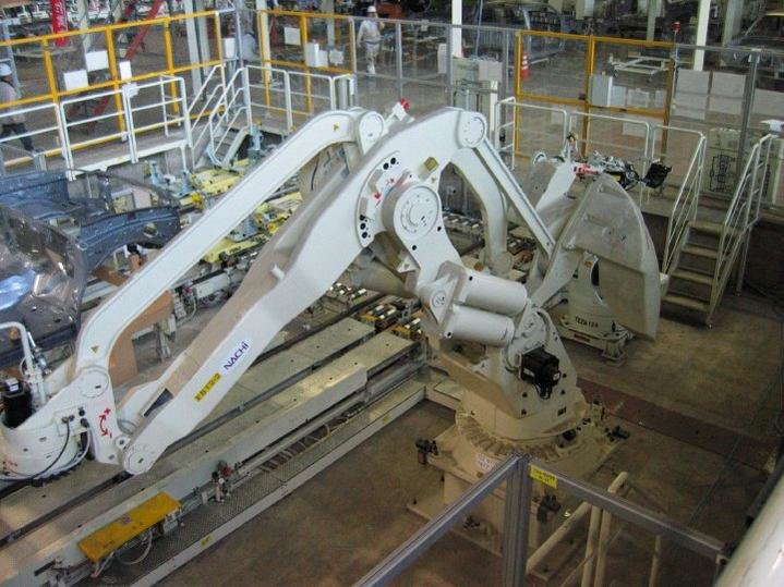

    Nachi D/L robots. Lift the entire cab. Big monsters.

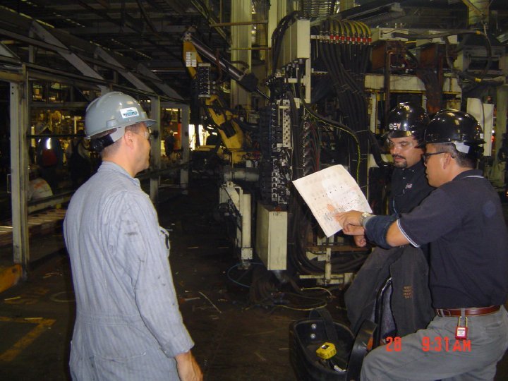

    Me on the left. Yes, I look like a douche.

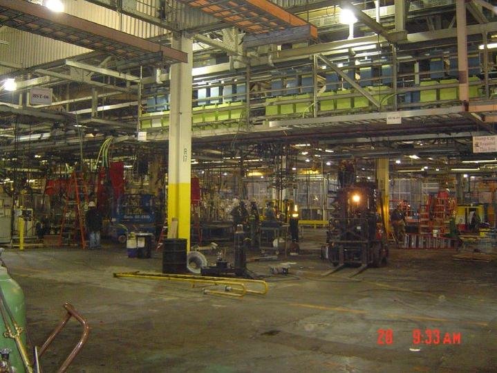

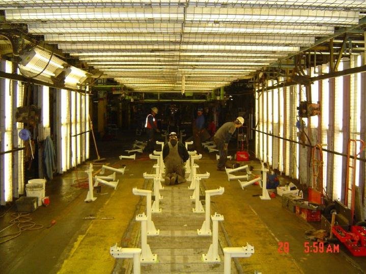

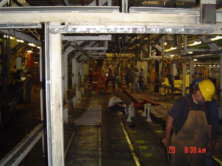

    Old Gen 1 equipment being demo'd. This looks like the remnants of the old door and hood line.

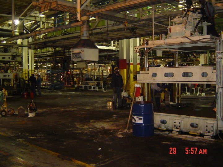

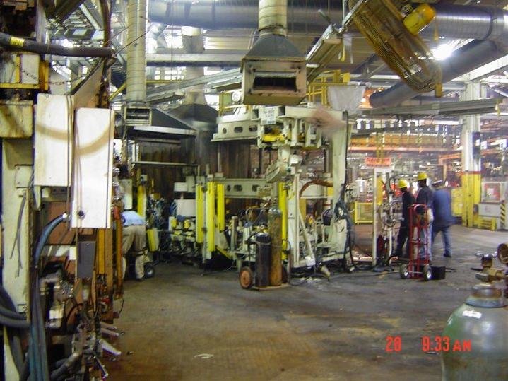

    A hemmer on the right, not sure if door or hood. No dies installed.

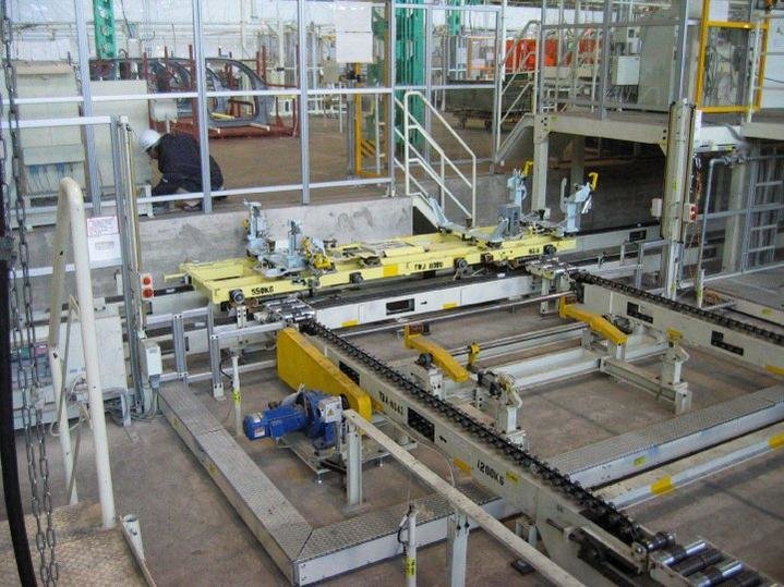

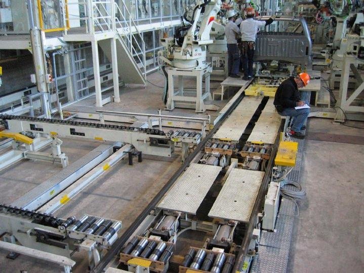

    New Slat line details being installed.

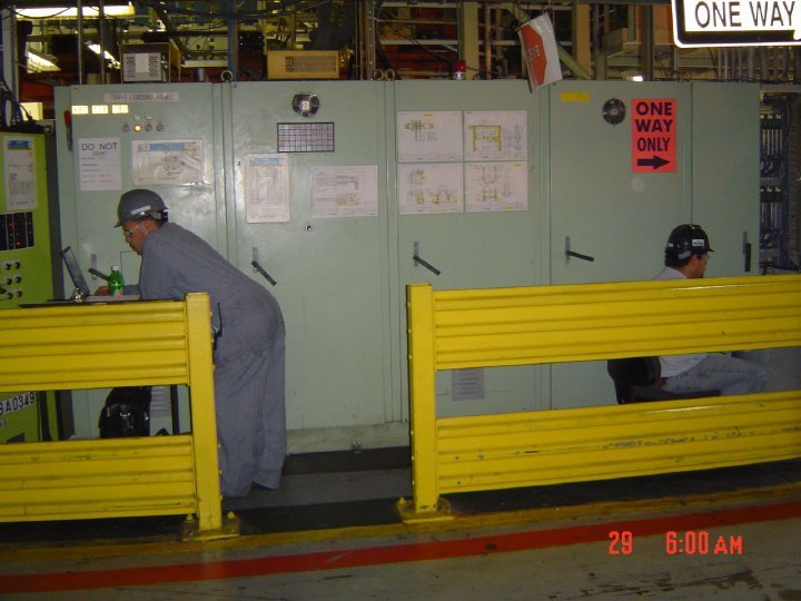

    Me on the left making some programming changes to the slat line PLC

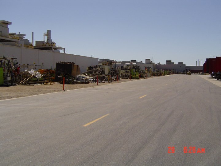

    Graveyard of old equipment and robots from Gen 1 Tacomas. All going to the metal recycler.

    I hope the oxy-act torches are only for the construction of the new facility and not the trucks haha!

    Torches were actually used on every cab for Gen 1. If you open your driver or passenger door, you can see where they brazed in the gap between the roof and the side members with torches. Brazing was also used the the rear pillars but was ground smooth and you can't tell. Gen 2 they stopped that process as the side members met the roof in a completely different way.
