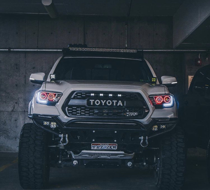

    My cv axles are perfect. Better than 3” lifted trucks shit you not take a look. Literally perfect

    But those drive shafts ain’t. Use your head.
    someone lied to you. Brah.

    Bruh the drive lines look normal same with cv angle and my caster and camber is perfect so idk what you tweaking about.

    What he is trying to say , imho, is a DB lift will maintain stock cv angles but in dropping the front diff it creates a more harsh drive shaft angle. Lifting the rear to correspond whether with blocks or custom springs puts the rear driveshaft at a much more severe angle. Just lifting the rear a couple of inches may create vibrations in the drive line unless corrected with a Carrier bearing drop or changing the pinion angle with shims. Strangely this isn’t consistent truck to truck. All of this can cause premature wear on driveline items like u joints and the carrier. Am I saying this is an issue or will happen? No I see lots of DB lifts around here the guys drive for years with no issues but they don’t off road either. There is a thread in here for guys with DB lifts full of some knowledgeable people may be worth a look.

    Yes. Tons of people drive drop brackets lifts around. On roads. But the guy was like “bet it does better off road brotha”...at that point someone’s gotta point out that when you lift like that, your truck becomes a liability off road compared to even no lift at all. Dude got took by a snake oil salesman.
