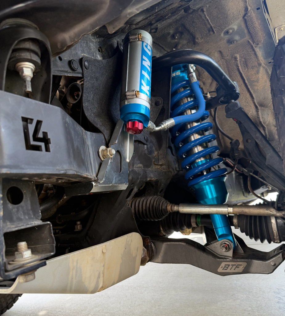

    It is current truck weight. Can't say for sure on measurements since I've trimmed ~2.5" off the fenders/flares. I think I can confirm it's not more than like 2" of lift given my CV angles. Springs are King 14" 700# variety.

    Just went out and measured. Driver side is about 10.25 and passenger 10.375.

    So C4 didn't offer powder coating when I got the bumper like 4 years ago and I got it coated at a place in Danbury, CT called https://chem-tron.com/ that was fantastic. They did my front and rear bumpers back in 2021 and they're both still flawless in places not directly stripped by rocks and trees.
    It's a ways from Maine but if you're in the area I would trust them to PC absolutely anything I wanted to last.
    Edit: one thing I don't like about the C4 bumper is the position of the recovery points. They should be positioned on the front of the bumper by the light bar, but as they're positioned downward now they wind up becoming an obstacle on the approach angle. I had this happen multiple times in Moab.

    I have similar mods on my truck. C4 bumper, lights, winch etc.
    I am running nearly zero or 1" of lift (as measured from hub to cut fender) and my kings have 600lb springs. It rides like a couch, I love it. I have adjustable shocks so turning up the compression damping helps when I am on the road, and turning down when I am on the trail.
    600lb x 14" springs measure 10-5/8 & 10" (huh, found that lean I was trying to fix)

    Everything is a trade-off. C4 positioned the recovery points to be in line with the frame and bumper mounts, so they don’t create an unnecessary moment arm for recovery forces that could end up bending things. I forget who does it, but some company recesses their shackle mounts so they don’t take away from the approach angle. Notably, pretty much every off-road bumper for Tacomas creates a moment arm against the bumper mounts when the winch is used. The difference there is that force applied by winching is usually slow and steady, unlike a quick pull from a kinetic rope or (worse) a tow strap or chain.
    My bumper sticks out so far I end up dragging the corners up steep climbs, e.g. coming out of the last hole on the escalator, on the passenger side of the line to keep the truck fairly level. (But also, I’m on positive offset skinny 33’s without long travel, which is probably the absolute minimum build for trying that obstacle in a midsize truck.)
