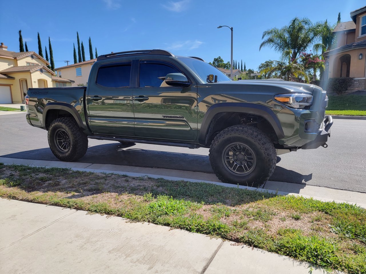

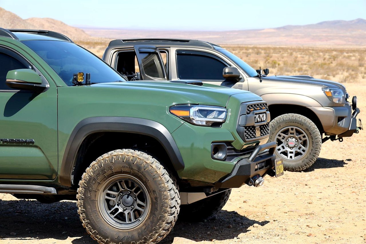

    Here is 6112s on 5/6 setting with 600s. Fully armored underneath with sliders. 285/75/16s
    Here it is with bumper. Same suspension. You lose about 1 inch lift.
    Here it is with 6112s on 5/6 setting with 650s.
