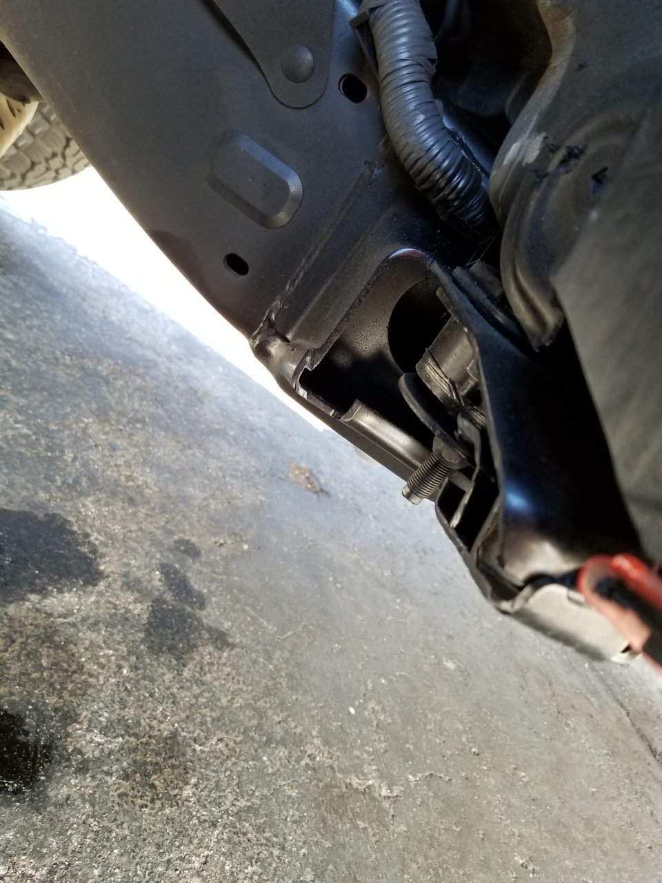

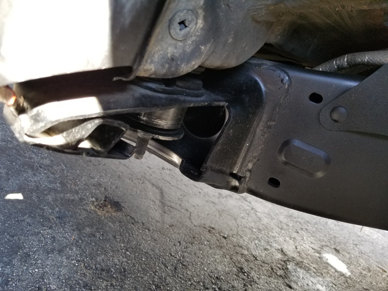

    Looking for a shop to assist with some rubbing and repair a "semi-hack job" another shop did with my cmc. Need fill plates welded in and to figure out where I'm rubbing and fix. Yes, caster is maxed out around 2.7 deg. I am located in the Mojave area.

    What size are your tires? Do you have a pic of your cab mount/ inner fender. I do 1-4 cmc's a week. Getting to caster closer to 4* will make a big difference as well

    @glorifiedwelder
    285/70 17, 2888+5100's

    That's cut pretty far back. I cut back a little farther on part of my top cut
    , but that should be more than enough to clear 33's even with caster a 2.7. What are your wheel specs? Are you running spacers?

    17x8.5 4.3bs -10mm os, no spacers. I do need fill plates welded in though, I think its hitting the plastic between the cmc and fender.
    wheels are 285/70 17, roughly 32.8x11.3
