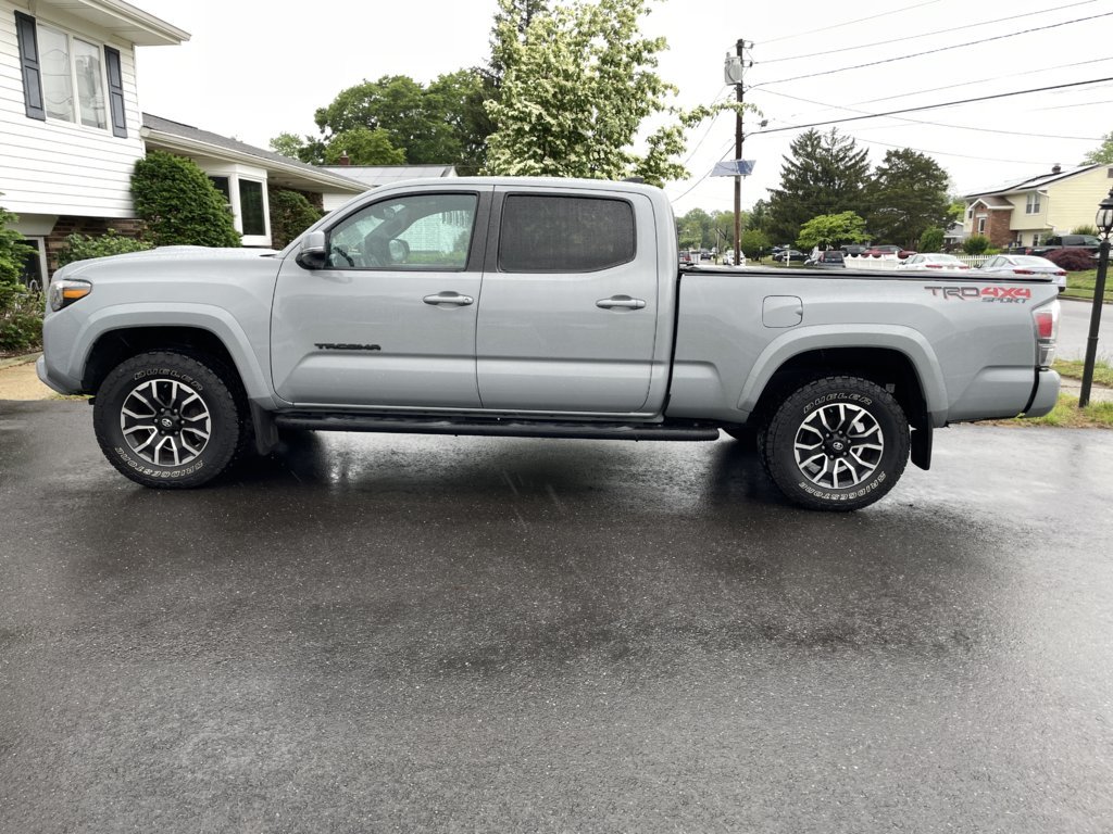

    This is the 2020 Cement DCLB I picked up to start this build with.

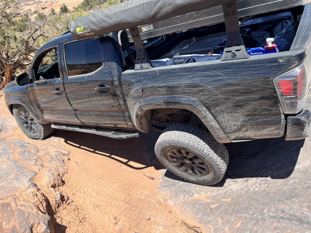

    Correct. The cutting of the crossmember won’t have any effect on wheeling on the rocks. It is bad for resale value and if the third gen ever has a frame recall like the second, it could potentially disqualify a new frame replacement.
    That comes with experience and good spotting. I’ve never been in a situation where my skids (same height for engine skid no matter what lift is installed due to the front differential being the limiting factor for clearance) would clear an obstacle that my frame or drive shaft wouldn’t. Not saying it is t possible and I’ve seen plenty of turtled trucks on the trails but stacking a couple rocks could easily clear that obstacle.
    I see no point in lifting a 2WD over 3” when wheeling either. The only plus I see about any 6”+ lift is it looks pretty bad ass with some meats under it. But not practical whatsoever and the OP mentioned rock crawling and trails with this truck so I stand behind my statements.
    I also would never suggest anyone wheel with blocks in the back. The amount of axle wrap you get from blocks under a leaf is ridiculous and dangerous. A true 6” lift in the back requires cutting the bed up to put a shock brace in the bed. That’s why most are 4” and 6” rear with extended bumps and med travel shocks so you don’t get any more travel than a 3” like said above as well.

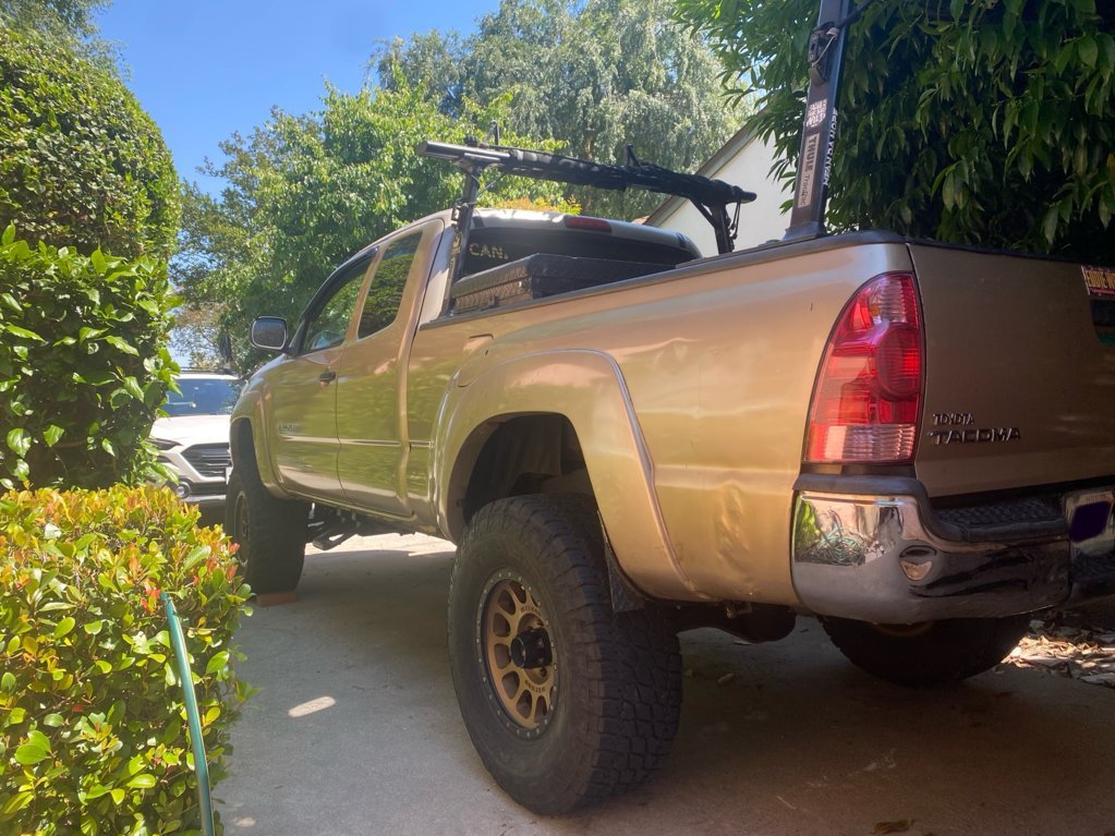

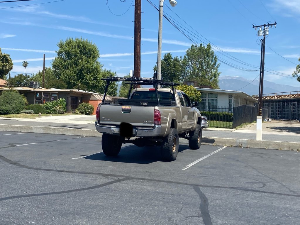

    No pre runner trim, no mud flaps,no step ups,I do have the Deck plate though. Kings @ 0 and 5100's in rear. stock leafs. Total chaos UCA.
    6” on 35’s
    3” blocks
    Swapped out for icon rxt setup 3 and it achieved same lift if not better and more functional.
    Front next looking to get the icon 6” lift coil over
