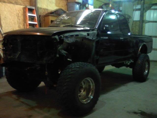

    Selling my 96 Tacoma to fund the FJ80 build up.
    Chevy 2wd 63" rear springs (With NO BLOCKS)~ $20 from my U-wrench It.
    and just right for a 6" lift + you can adjust to taste with shackles.
    Ruff stuff or Poly Performance has a nice 63" chevy weld on instal kit for around $120.
    http://www.ruffstuffspecialties.com/catalog/63-chevy-spring-swap-p-279.html
    Poor cell pic of my 1st gen build in progress / 6" TM kit on 35's and 63" chevys
