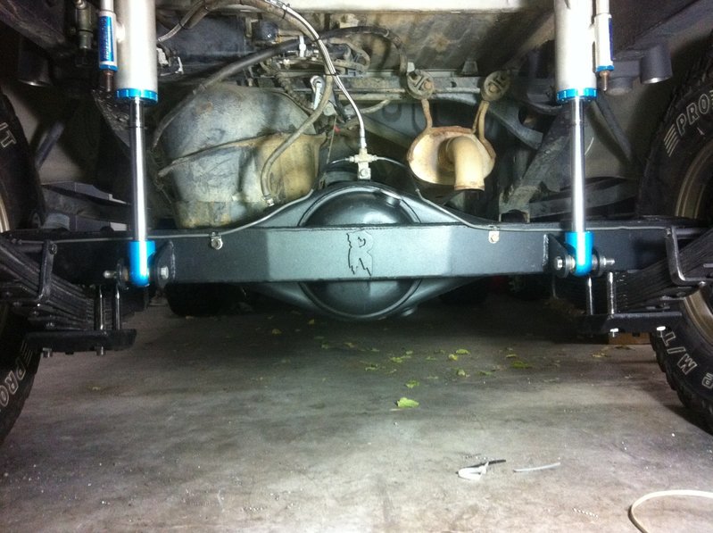

    I like this idea too. Again, new to Tacos, so I like the constructive comments. The stock housing wall is .2" so even trussed can it crease on impact? Does someone make sleeves for the housing arms?

    Relentless truss? Digging the setup too.

    Yup. That was the prototype built off a first gen tundra axle. He modified it for 2nd gen tacos as well since they are only 1" narrower and sells it as a WIY kit.

    I like how the fill hole got relocated to serve as inspection hole too
