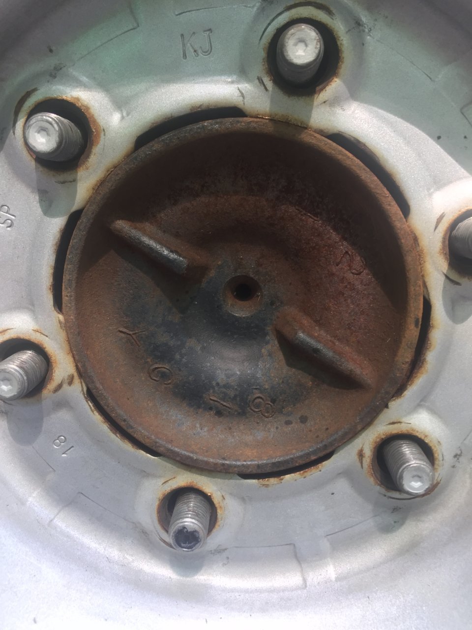

    Did an experiment this morning...
    Put the truck up on jackstands, with the rear end supported by the axle. Started it up, turned off the traction nanny’s, accelerated to 70mph. Shaking was present - and this is with the front wheels at a complete stop. Working on the assumption that my issue is limited to a rear tire, I removed the rear wheels and reinstalled the lug nuts on the drums. Ran it to 70mph, no shake. I have long suspected one of the wheels as the problematic one due to the number of weights on it. I left that wheel off and installed the other rear wheel. Ran it to 70, no shake. This further confirmed my suspicions. I used a marker and marked the weight location and values on the suspect wheel (just for future reference) then I removed each weight - no weights at all on this wheel. I removed exactly 6oz of weights from this one wheel. I reinstalled the wheel, did my test again and observed no vibrations.
    I’m going to take it for a jaunt down the highway in a bit to see how it fairs. I know my above experiment is Mickey Mouse way of doing things but I really had nothing to lose. I’ll report back after a road test.
    And just for kicks, the below is a picture of the wheel resting on the hub. It is in contact all the way around, this is hub centric wheel. The lug nuts would center the wheel rotationally around the hub (you can see where I placed it the studs are not centered in their holes). However, the wheel is centered by the center bore restings snugly on the hub.

    Just a follow up note, the truck drives considerably smoother with the rear driver wheel relieved of the 6oz of weights. It is no longer rattling me, but is not glass smooth. I’m more and more confident that this is the result of improper balance work and not a bent or damaged wheel or tire.

    Your making progress, but honestly it sounds to me like you have a faulty rim or tire,
    If you were my customer I’d remove the tire altogether and check the rim.

    Following up:
    I picked up a Harbor Freight static balancer, assorted weights, and a hubcentric ring to adapt the Tacoma wheel hub bore to less than 4” so it would properly fit the balancer cone. That worked well.
    I won’t go into detail about using the balancer. There’s a ton of YouTube info on it for anyone interested. I will say, make sure you have hours of time and patience. On/off the balancer so many times is a back breaker, these wheels are heavy, 2 people makes it lots easier.
    Just returned from my test drive, happy to say it is improved to the point where I really have to question whether or not I can feel anything. I wouldn’t call it perfect, but it’s within my tolerance of acceptable.
