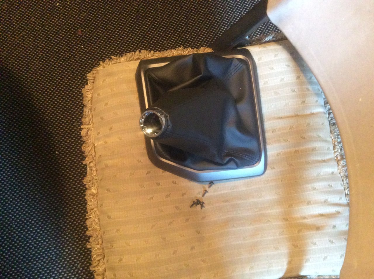

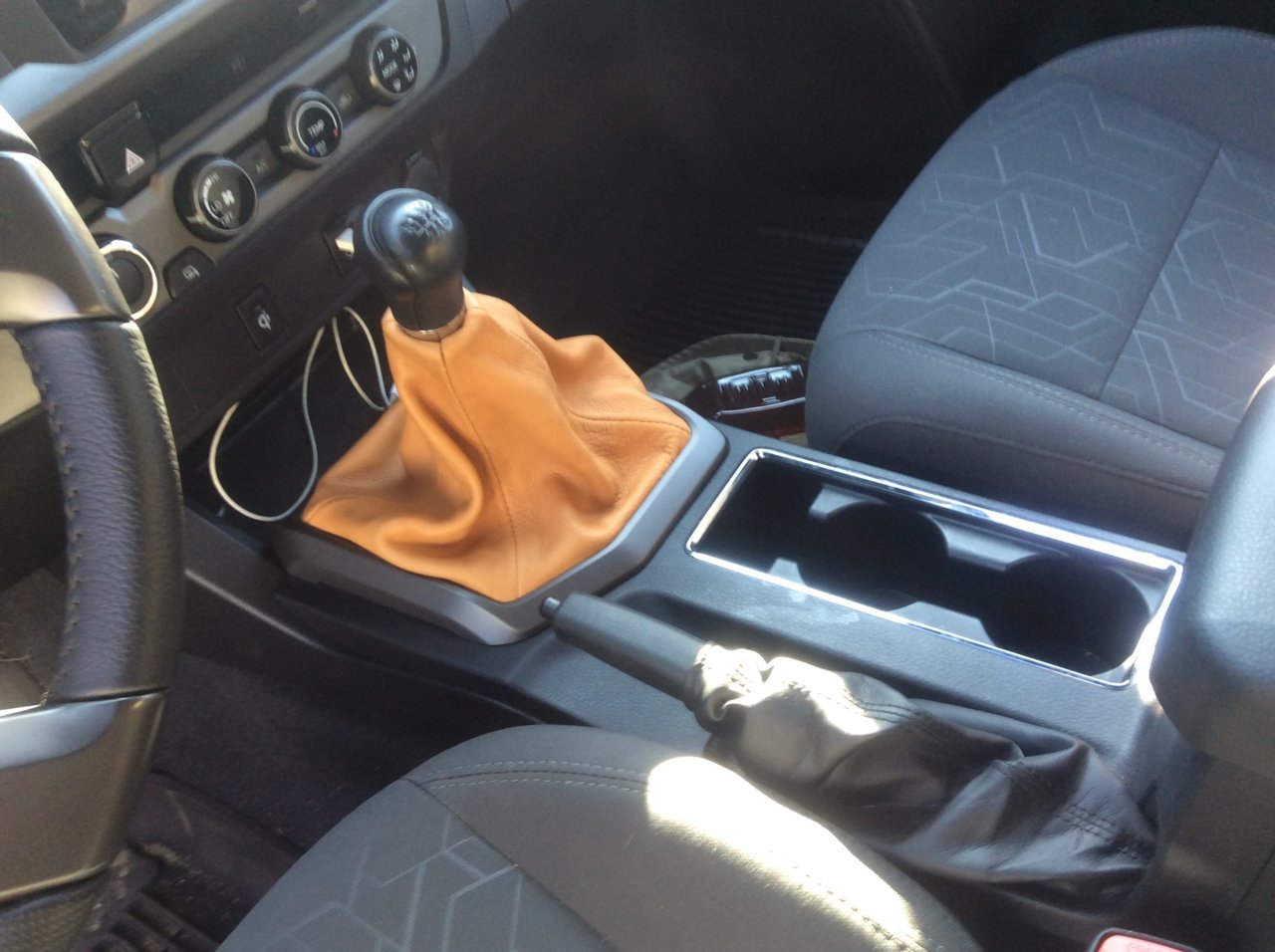

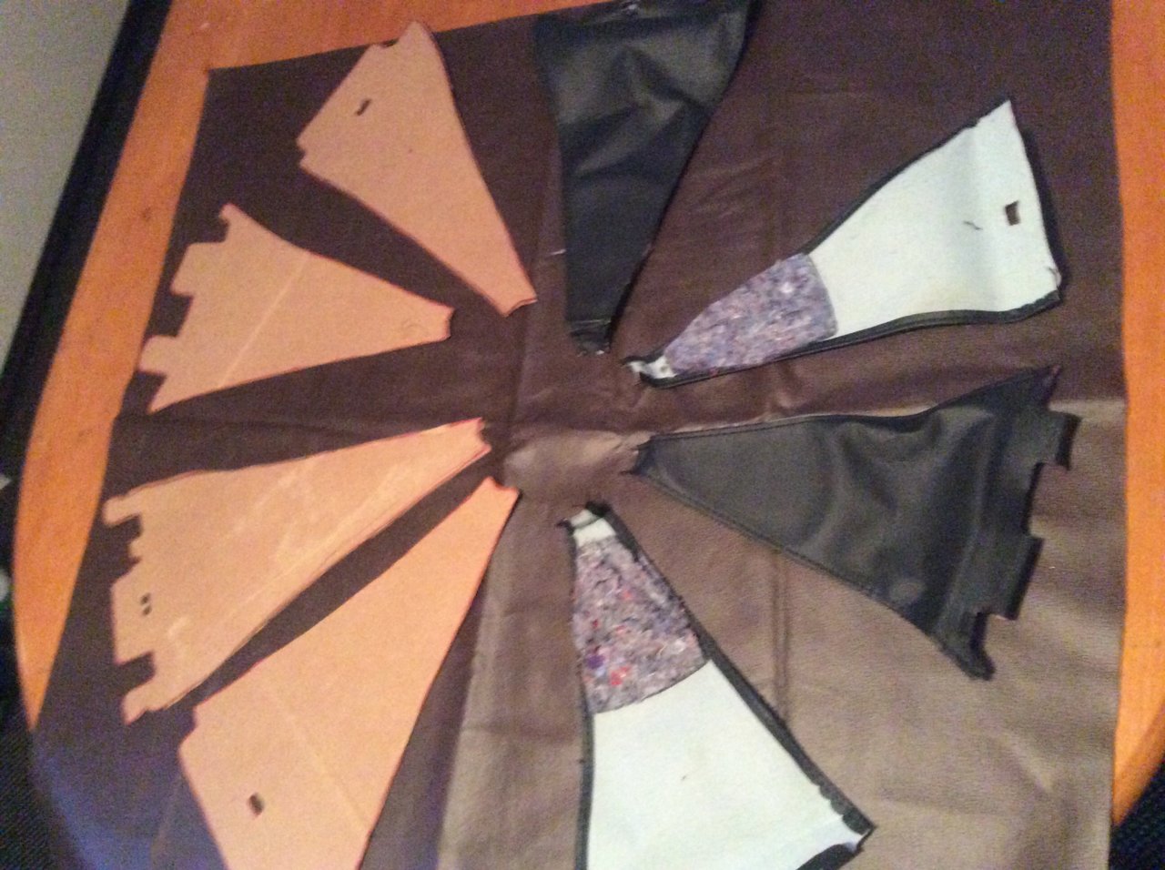

    1C8D846F-4495-43DF-9BEB-B34ECA0AB63A.jpg This is the best place to put this. Leather shift boot. Yes it’s a little saggy. image.jpg Leather is a little heavy. Any takers on both boots once perfected ? Black,brown, tan, you tell me a color. 379540C0-FF87-4B04-BE00-41321009F67C.jpg
