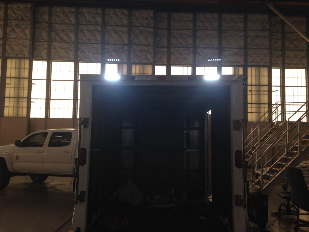

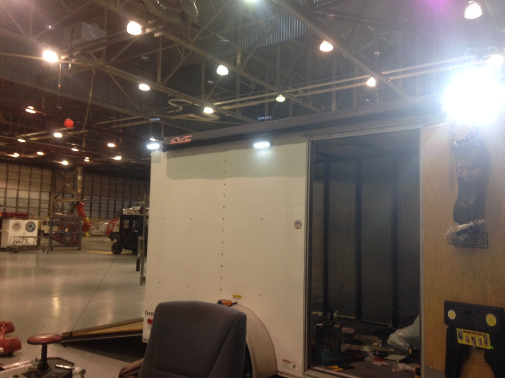

    So ingot my exterior lighting planned out. Blitzpro was having a killer deal on lighting switches and free shipping to boot. I also got a switch holder and a double USB port for charging phones and what not.
    So I will have 3 lights on the right side of the trailer and 2 off the rear. Now I just need to order a couple dome lights and I'll be ready to start installing everything. I have a blue seas 6 spot fuse panel and battery I had in the garage that will hold me over till I can get a deep cycle.

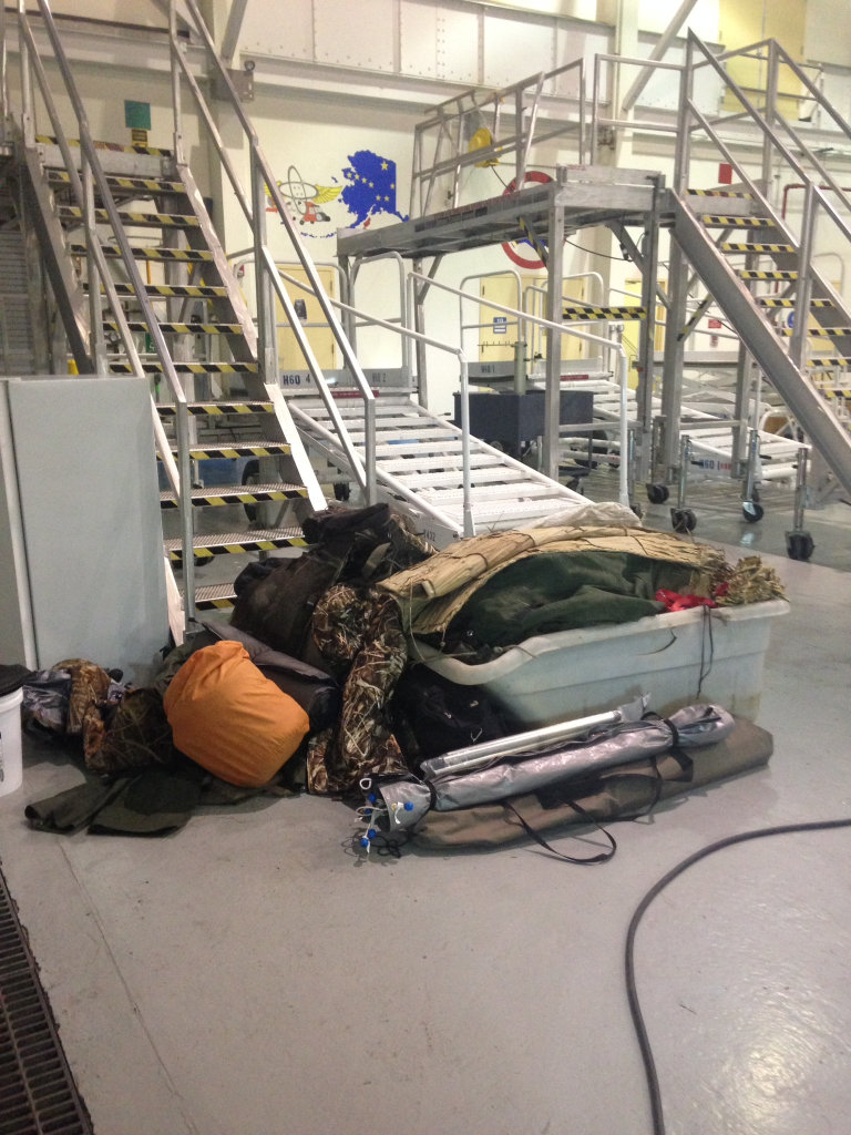

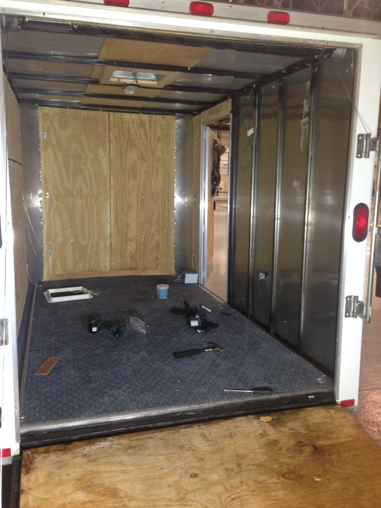

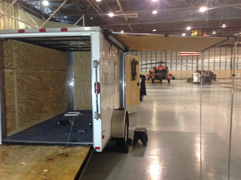

    Got some work done on the trailer today. Pulled it into the hangar and pulled all my duck hunting gear out of it.
    c90e3feba595d1b4bb3b84d0fa8927f3_zpsf5b5_b1f10a270926441e42573f8e6bfb2b62349b8fec.jpg
    45bbf0599652b3ba1fc212a996b4accc_zps8bd7_687326de41af46f60251a3af2dc1d62bdd457795.jpg

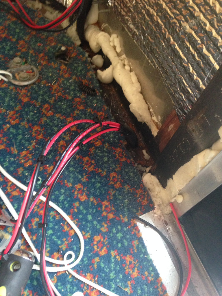

    Started to take all the panels out. Man was there a lot of gaps on the floor and frame
    a0e24a7cda8bd392fd2f7a5714ba6c18_zpsc340_9c1f98835458454ecd75438bfaa5ca1e7ca02f1c.jpg
    8ccdb6d82b74f33c7d96d18f6235709d_zps9c26_48289d3a4b47de4e25de6c4bc73333956d1e8fec.jpg

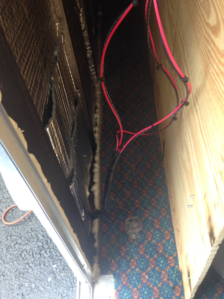

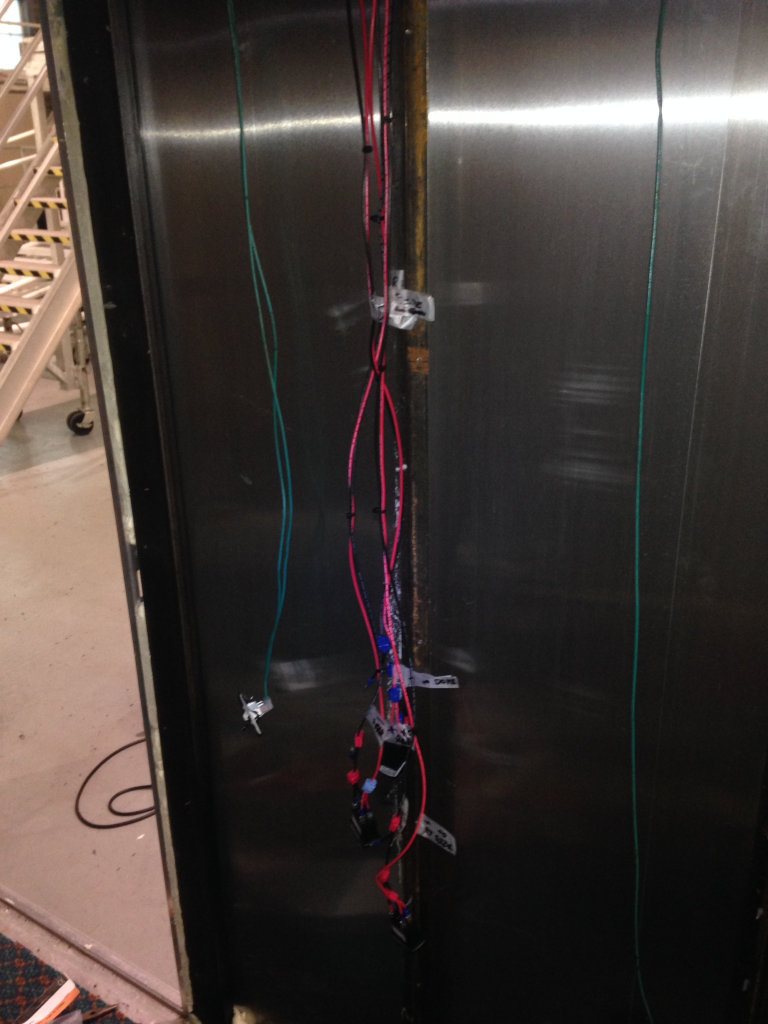

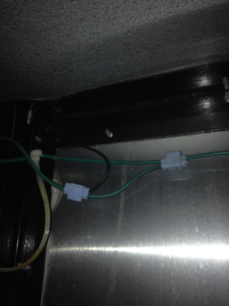

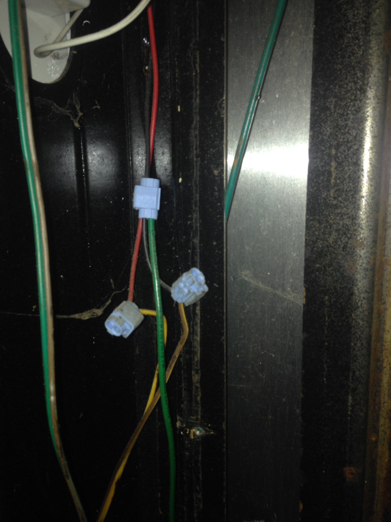

    And check out this wiring
    45223ff00c873787422bb5d4d763c642_zpscb65_d635f386d78873208fe8e9c3f94f473279f65a55.jpg
    ab749ba63d2a3c420d2aa02c0156d6fe_zps5044_a71d686b2c742ca4946cba5005253449ba6f1791.jpg
    Took measurements for insulation, haven't decided on which kind of insulation I will be using. But, I will need to spray foam the edge where the floor meets the frame of the trailer.
    Next step will be to mock up where I want my lights and start mounting them and do some proper wiring.

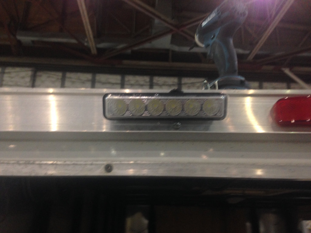

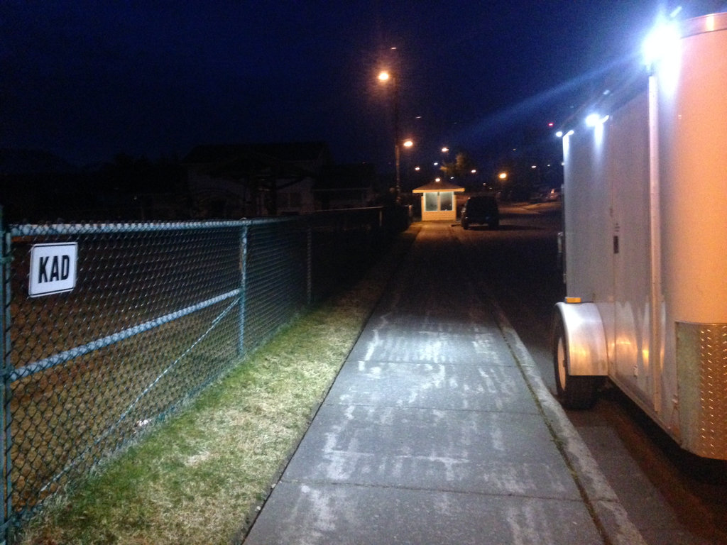

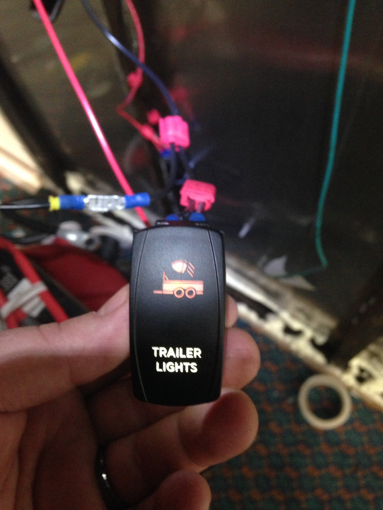

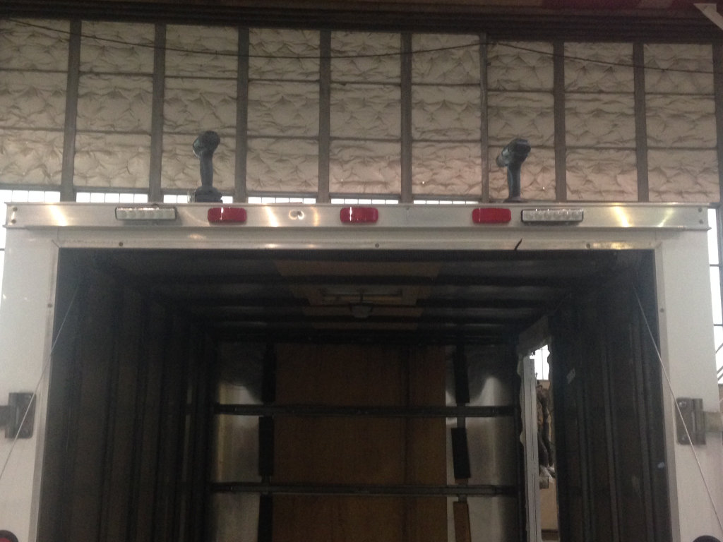

    Well the last couple days have been productive. Got my flood lights mounted and wired up.
    e4197bf1c7ec7c7169a3f1d504f77bf4_zps870e_877c997abfe465f7dfa541ac373ec58c6c002377.jpg
    966c0665b15cc2393f01e03a5129f7eb_zpse03a_029ce1c584174c26f689dd3dfd9e9a4bbee9c222.jpg
    Two off the back
    c8956d035f5f369b9837d8707f1a100f_zpsc552_e4eb5f76d1b3dc99c6dbfa9a783865e33862e2d0.jpg
    a54042eaf3868914da41de206fed6cdb_zpsa05e_d1fc92be8b4663270675cff2f18f60be9dd1f526.jpg
    And three off of the right side
    8ce18b2f472b081ddf52491f6a0bb425_zps1f84_73b0513c6a0d3385f0b96e9605131e3975915951.jpg
    14f06ede1b51cc86d9a4ee18def153cc_zps729d_39984d0b3ca9bc62f07b58f1c3b478eb0cbefae5.jpg

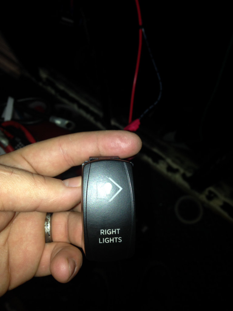

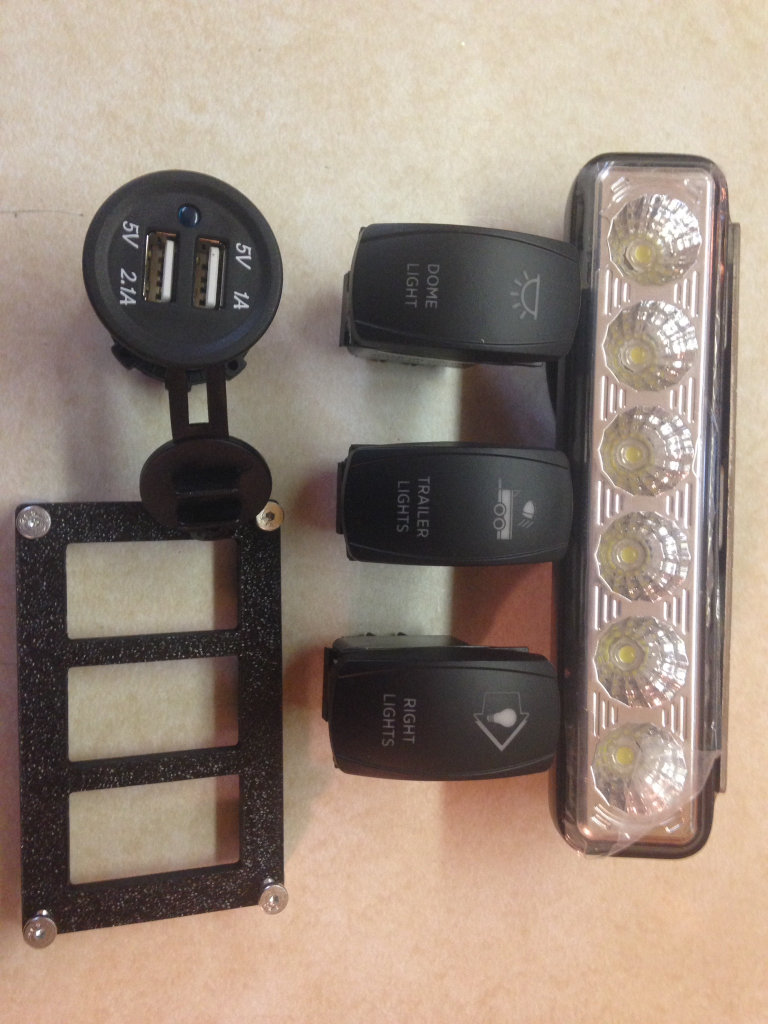

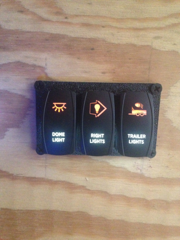

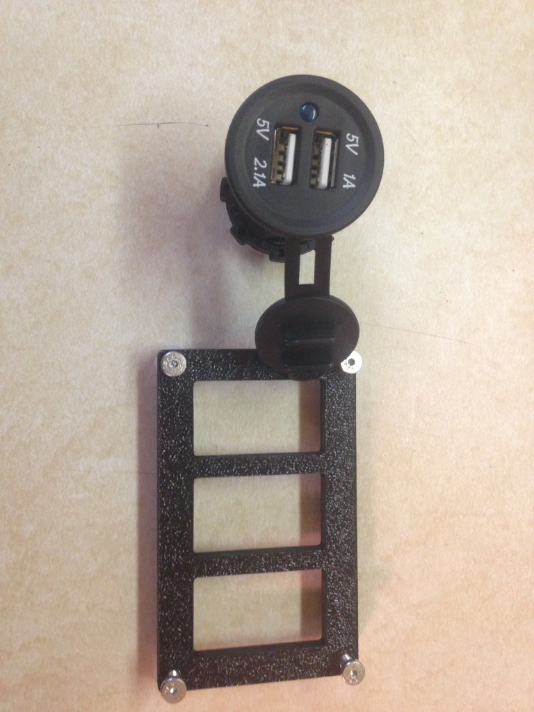

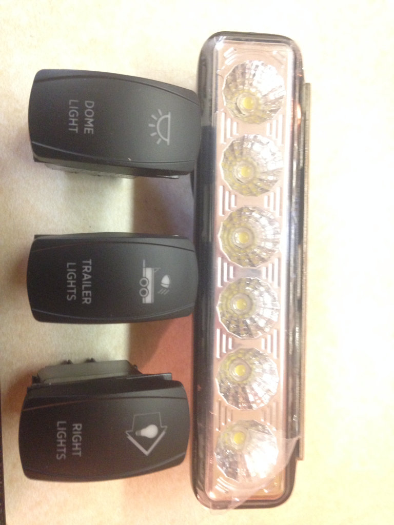

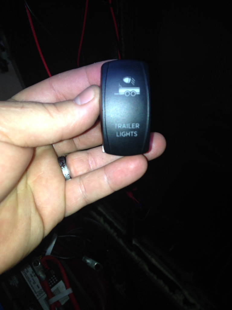

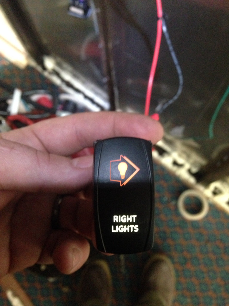

    And here are the switches I used
    Power off
    f3dd96d5b6414cd5a76066eed599cb80_zps6242_26f5834c8d44d9dc006ee185194f3fd2e2f095b2.jpg
    016a2f0ea89a5804e7920e45f9eb731a_zps6f83_a3bf6cea1edbcb1a0a699d38f27d7a8375c8d927.jpg
    Power on
    e5a47700d71cef0e2694adc9e7dbdb55_zps2451_3cc02aa1c099c67642c02cd2c6dfff4ee4ebb397.jpg
    16d94fb26d7a97460faeee377dee78cc_zps7c1a_21ce42c5ec3446d1f0c467515a3c0e62fc023026.jpg

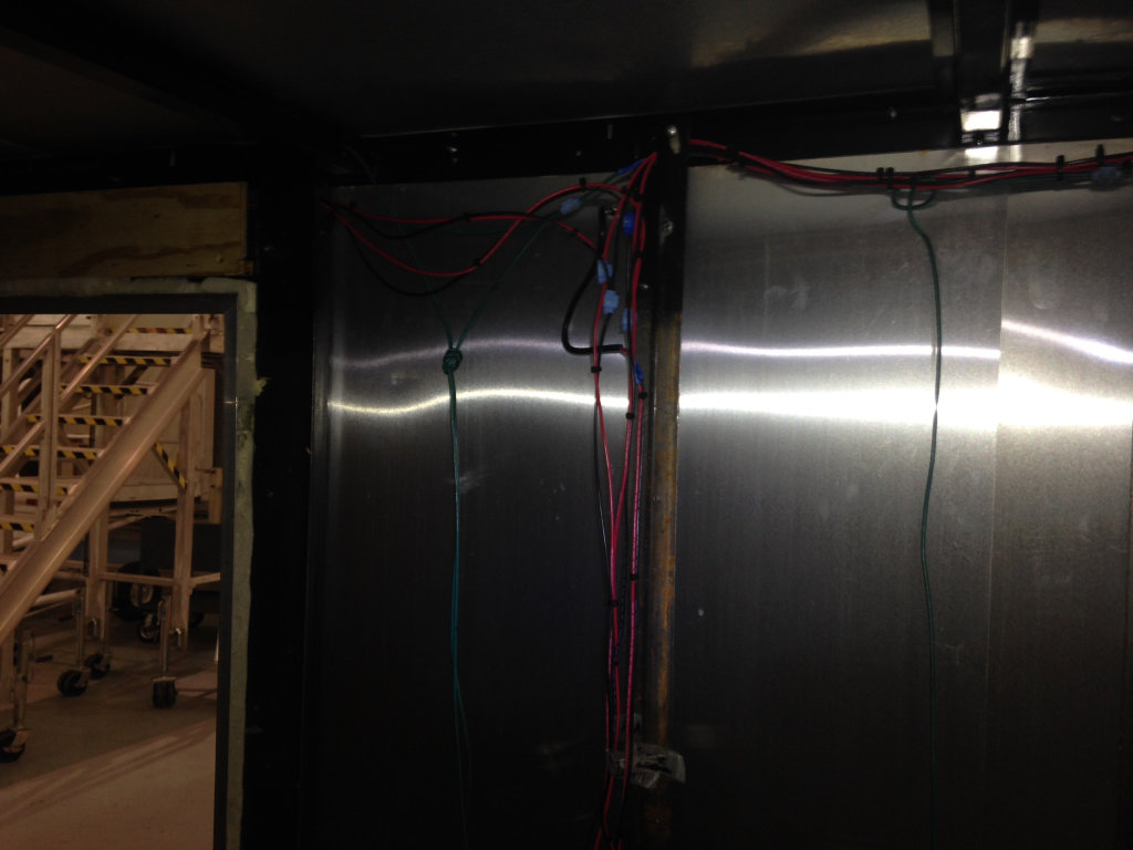

    So here is a look at my wiring.
    63ad4346cf8e0b98900d99ddeab723c6_zpsa8cc_faa8339930bd2a32961b6af0bc70d66bfc4ba924.jpg
    51d677891b43ca444b8076105fe1c2dd_zps229b_98359196a7836fbb20de5ed2d9c7644b1fe380ef.jpg
    93392f63e8ffd0f4c25d5b1651545689_zps6f5b_aa54e0892afdf83bbc0b74ef2f7a94c49c961bbd.jpg
    I also ran wire for two dome lights that will go to a third switch and power for a fantastic fan that im still waitining to get. But, this will make it easier for me to add those in the future by not having to remove the side panels again. All i will have to do is hook them upto the power and ground then add a fuse in the corresponding slt. As well as a 12v socket and a duel slot USB charging port up forward. Just waiting to figure out what kind of insulation I'm going to use and I still need to get a battery box to mount on the tongue. It will house the old spare battery that I will use for now and my blue seas fuse block. All switches will be held in a three switch holder made for the OTRATTW switches.

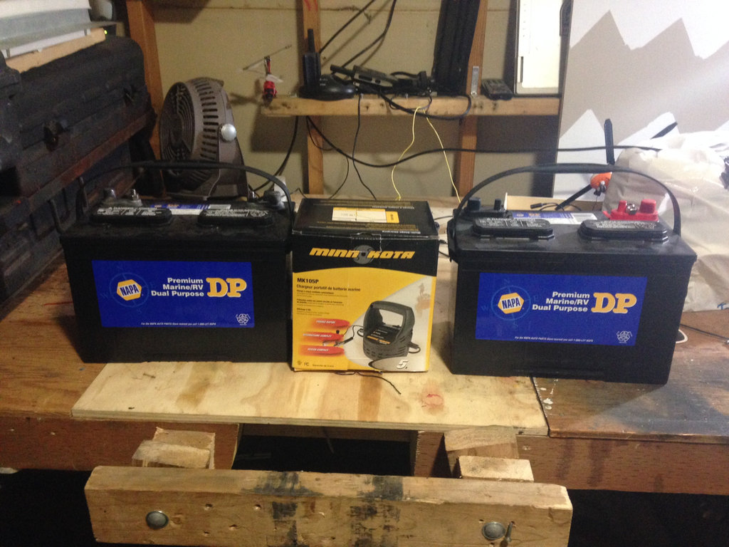

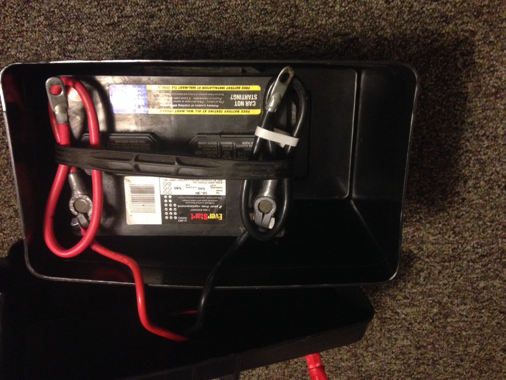

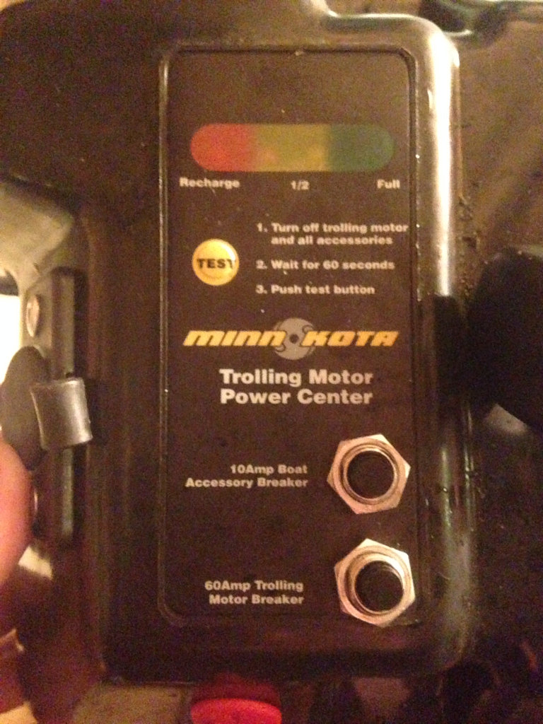

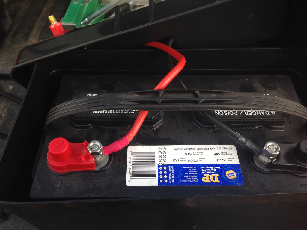

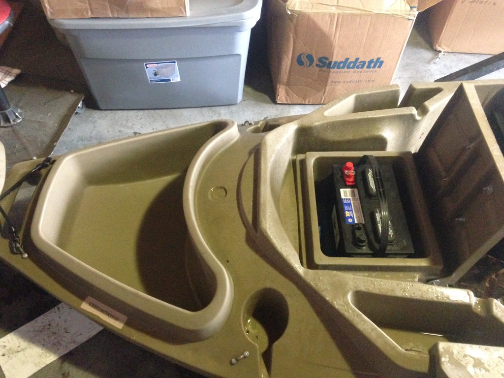

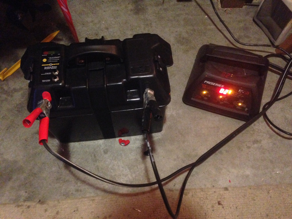

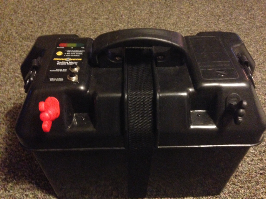

    Got a new battery box today from a buddy. It's made for a trolling motor battery but I took it off of his hands for him. It has some pretty cool features.
    013846b4d7cc35cfd2b3f0b4483400ce_zps6527_70779b4dc2c5369f32b3713b7aa39f2a43d628ba.jpg

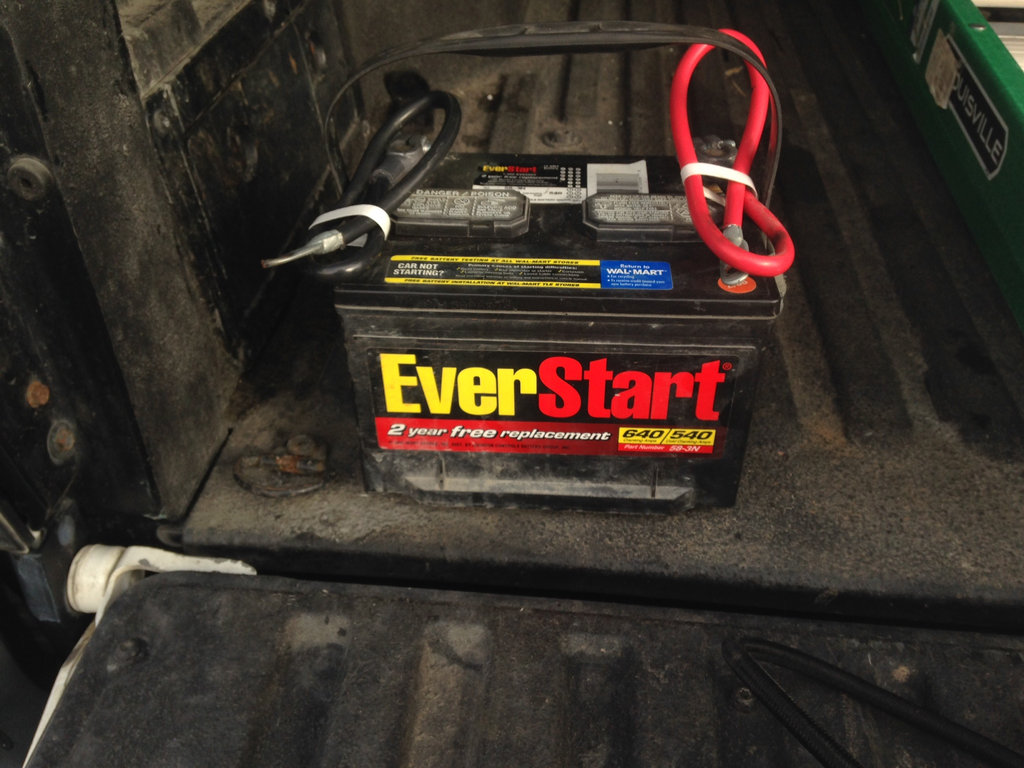

    My temporary battery. I will eventually upgrade to something better. But I will be mounting my blue seas fuse panel to the top off the lid.
    33ef3836c15b5940b98ab986265e8891_zpse35b_8949d068801f771678a30ccf3594f05d802d9b80.jpg
    It has tow integrated circuit breakers. A 10amp for the two cigaret lighter slots on each side of the lid and a 60 amp main for the exterior terminals.
    f6a2661389a55bee63615f2680c38d52_zps0807_d32f588bb66db822a755d0b3efc98af2a9ed617e.jpg

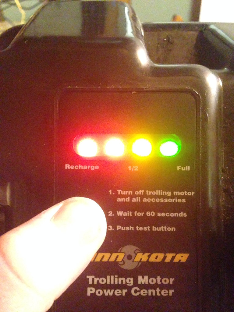

    Has a push to test to see the level of the battery
    ca0cfbff28a0c000a80e0d33e78e17a5_zps673f_9d5f6a722af373e9d9802c77073ed14f47ac64af.jpg
    The external terminals make charging convenient
    98b0b5ce80f861424a9f315577ec99f5_zpsac0c_38c16b60608a0712de5f6d623dd9faf705e23249.jpg

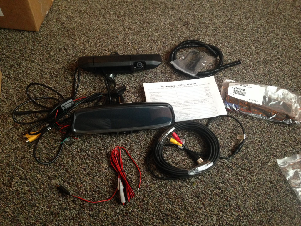

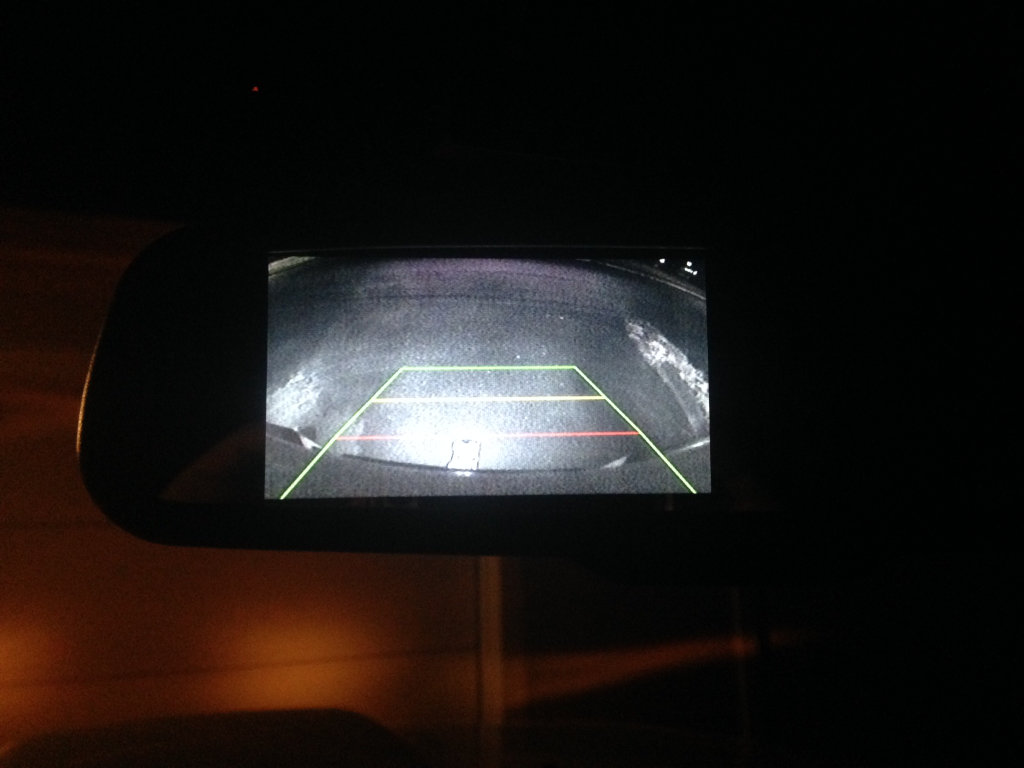

    This should make it easier to back up now, I got tired of just guessing what was behind me at night. The problems of having tinted rear window and tinted shell windows.
    3f3dcdd6b130295184b2b0c293a6790f_zpsdf29_50665c93e30bb79e5d3c9019894a850ea24295f5.jpg

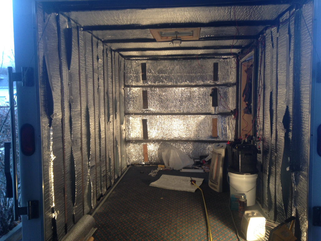

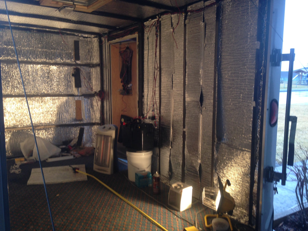

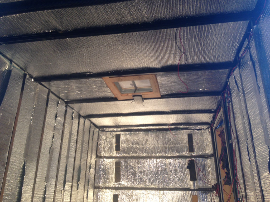

    Got my Insulation put in yesterday, I used sheets of Reflectix that I got from home depot. I didn't need anything more than this since the coldest it gets where I will be using it the most is into the 20s. I already have a 15* sleeping bag plus the mr buddy propane heater. I run that a little bit before I got to bed and when I wake up as needed. I put it on the walls, ceiling and rear ramp under the plywood deck, and all of it was put up with 3m spray adhesive to hold it in place. Still kinda in between on whether or not I will put some under the floor of the trailer..... I guess I will have to wait and see what it is like when it is cold out.
    05978ed16ed98e730c9cfa41e4c655c2_zpsb480_1e009b8cafbdd7d37b37acd12c4632c4e7c01796.jpg
    1b0610951c36f06ace65f776ccf8d1ba_zpse50b_060c298630b61c71b5af870ae8181e1ab81d607a.jpg
    61ccf354aca6fb8b711ccf893fc5c0e2_zpsdd32_cd2f2f75b31de45f671da46ea6186ab18d1dce10.jpg
    e28062a1093adfa80e07ea5ffd375f5c_zps457e_e41968abf1c2d76d50dcff374f44ccccd88559c1.jpg
    Toyko Joe likes this.

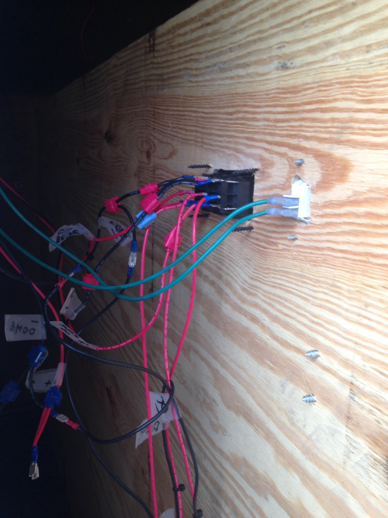

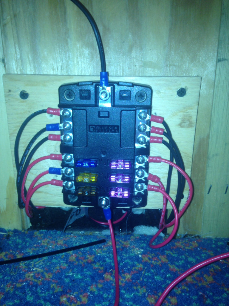

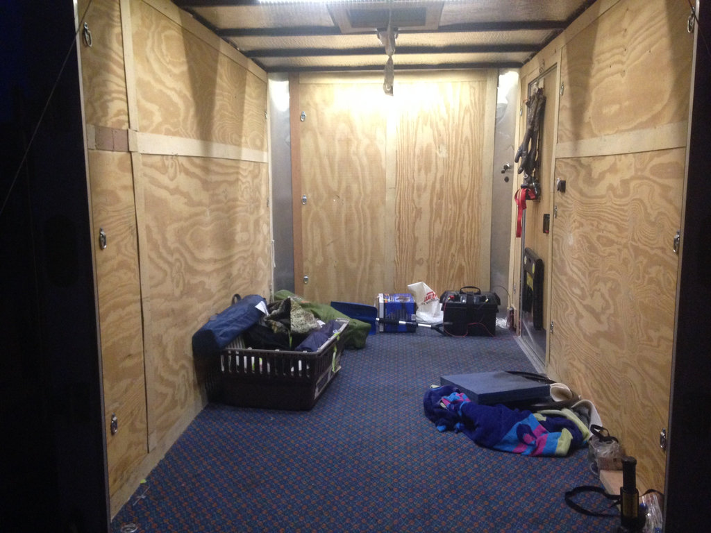

    Well i finished up the trailer today, I fiinished all the wiring and got all the panels back on.
    Back of the switch panel, looks kinda messing but everything is labeled
    daf7bef649be6fab613bbf80d5bce548_zps8ba1_2f60497cf96cb621ecc1643d68f79f85dbf6ee5c.jpg

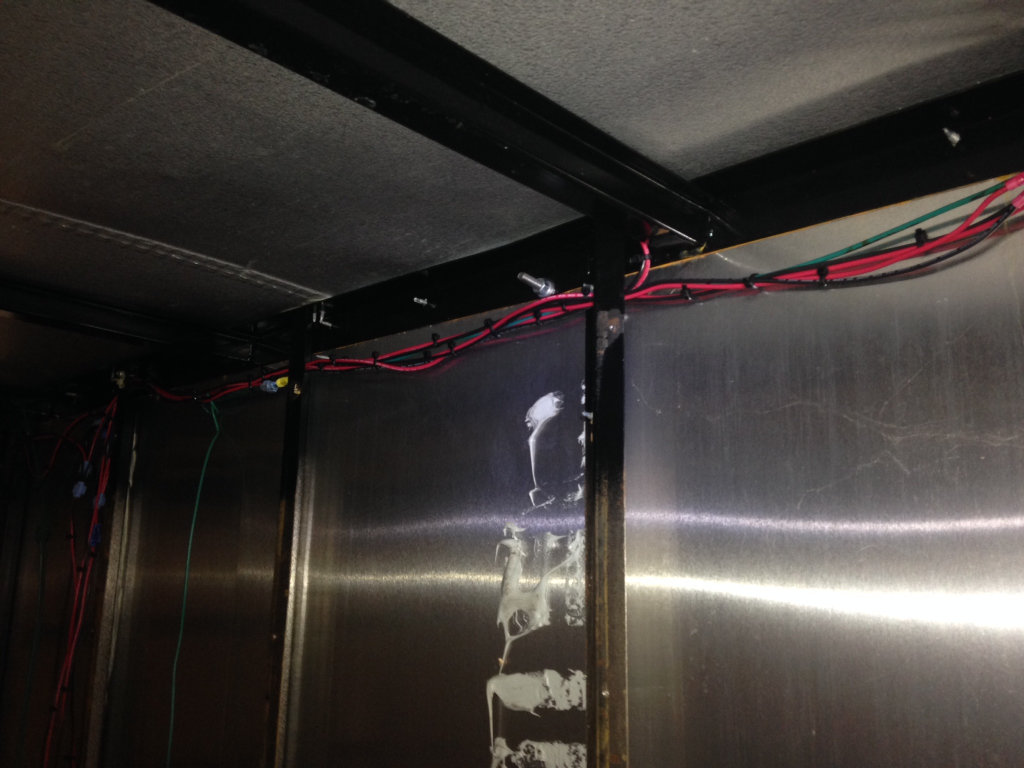

    This where I ran the wire up from under the floor
    6b4d9ea732de8b268e4731f1ccd5fce9_zps4928_7397905b0a2d314395aabcba813be876b92b4c73.jpg
    This is where it comes out so I can mount it to the fuse panel
    e26a50153ff0591a949e8b921ec01bf1_zps859c_e0198176d2cab21ac9a2c527900d0567e7d95e41.jpg

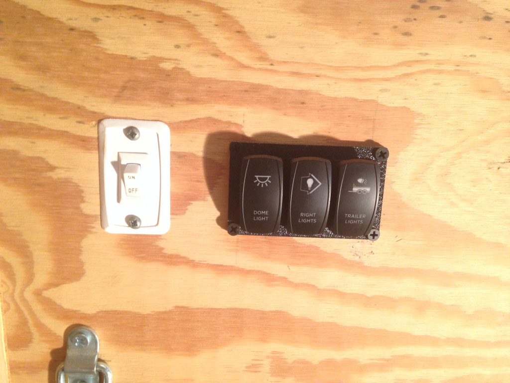

    All the switches. The white one is for the dome light that runs off of the trucks battery while hooked up
    628d7705ea645506a80189edcbc1eec9_zpsbd0f_0446e792709aaf6c4775da293210d90bc8e9944a.jpg
    911ca80db726537e5e28250889690ccf_zps2c82_7960675f9a3214d41697aa6c7e9055cd4684fe84.jpg

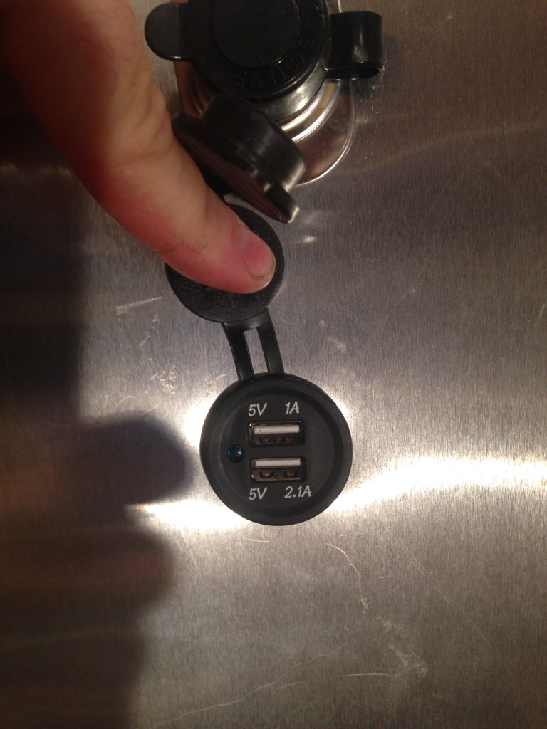

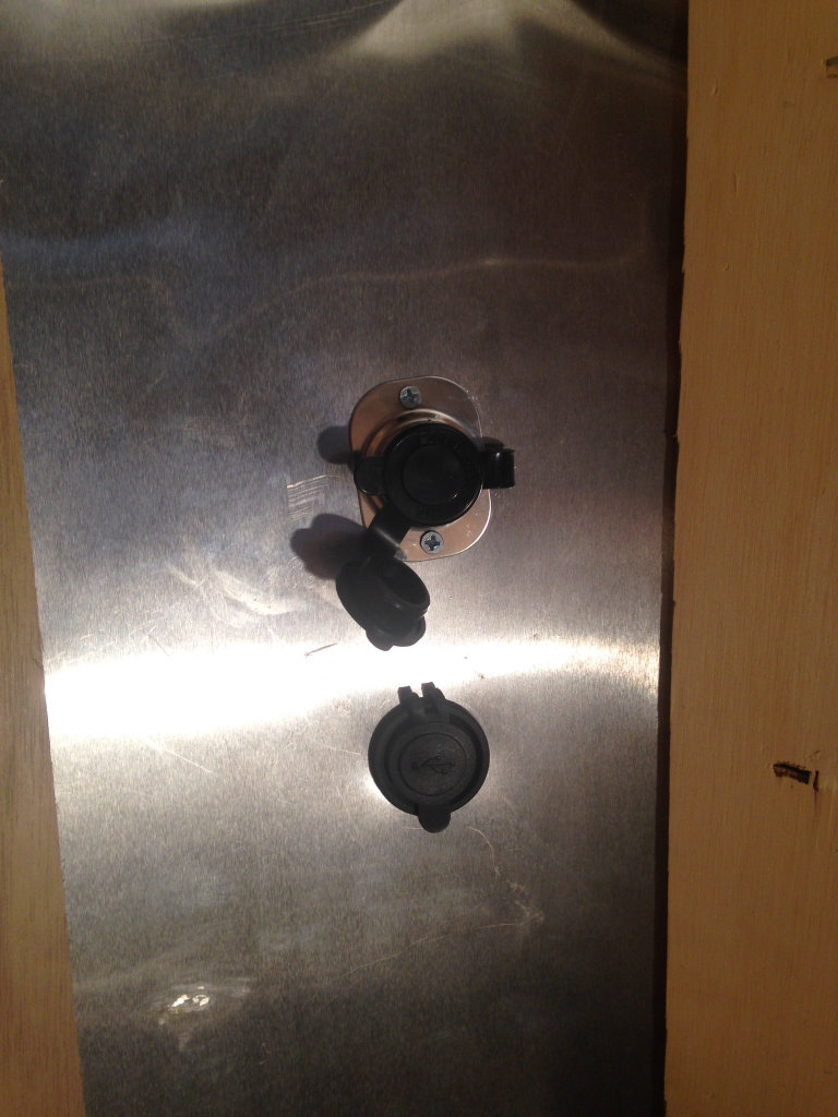

    Cut two holes in the trim and hooked up both outlets there
    cc2ea16b60c82e245e5678f23ff58297_zps17f8_32ac73d4310cc467543579c62a492750c1b899fc.jpg

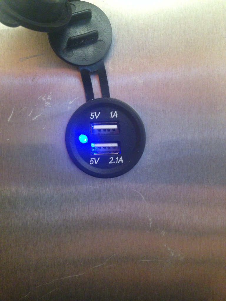

    One is just a 12v socket and one is USB
    388328023f03c88652b76c923c1b5f9f_zps9150_c718de93ae2c3765806c99e573df6b9c69006182.jpg
    And with power applied
    d4aea0bb0c580622d1b34a304c3a45df_zps6c87_d5c54ed160df69f7559022c61ba44f595f59f8a2.jpg

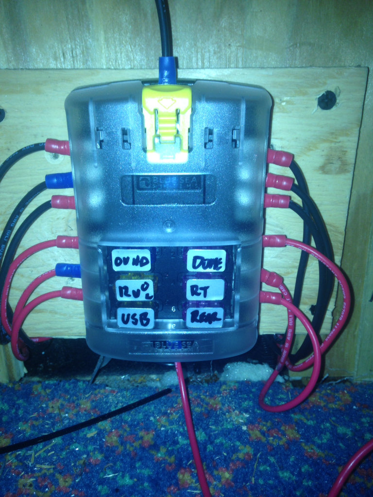

    The 6 blade blue seas fuse panel all hooked up
    bdb015fe904aa26decd7e8fb9a3e74cb_zpsbd58_bb8b13400d829b74c206594b084c9bd890abf549.jpg
    14a62e87d117a801f848104b4f8affef_zps5aec_74ce04e01c66dd5808047006cae18774b668541d.jpg

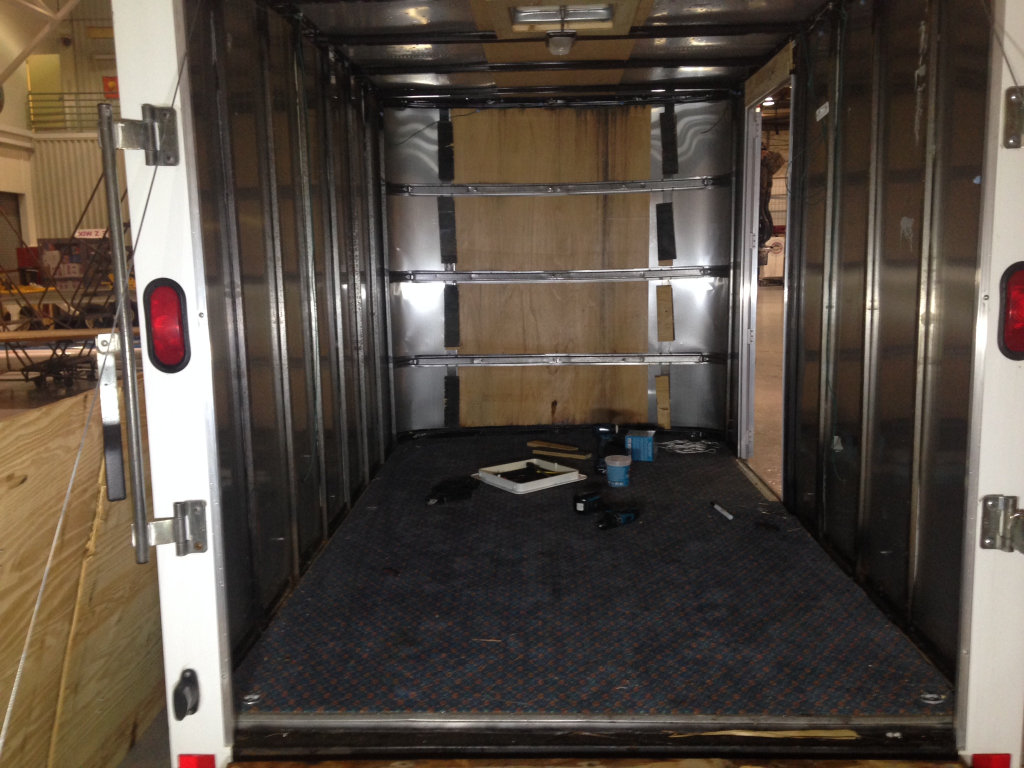

    With all the panels back in place and floor a nice and vaccumed up
    fbda8b5453a7ca7e42d0afabf0e17000_zps4bad_c98e0665224ee522f92a9ebfd8382f5ae5460ea4.jpg

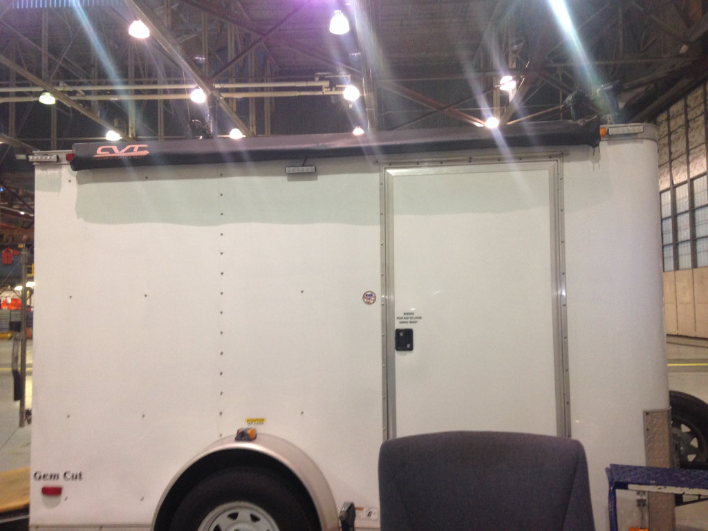

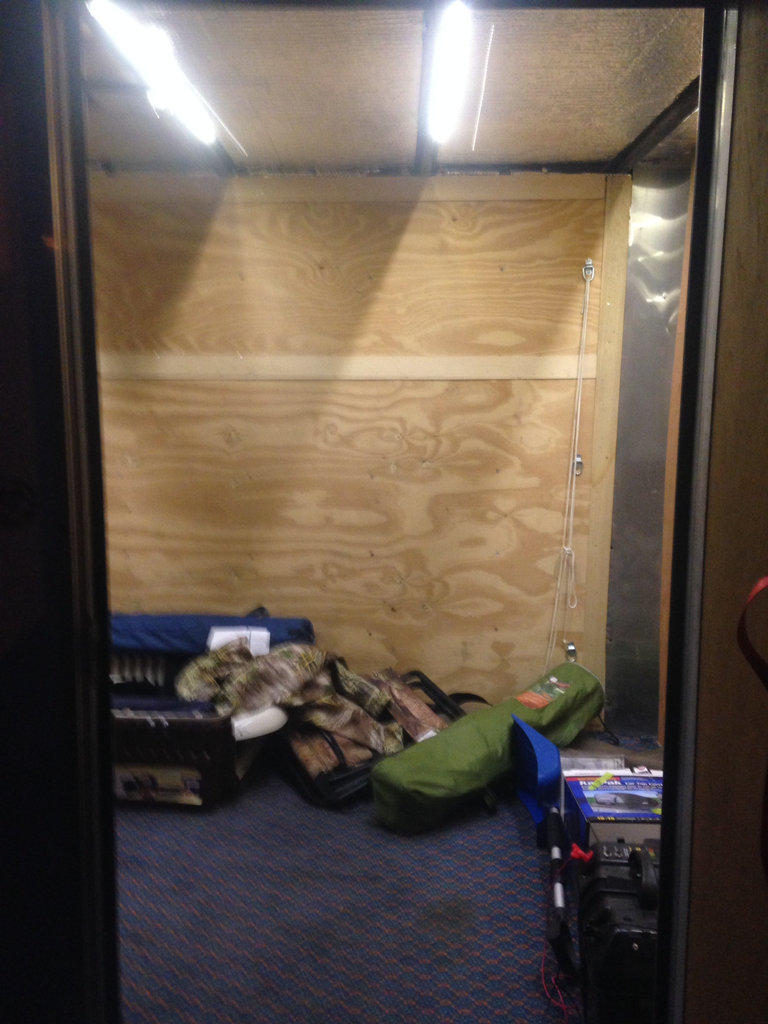

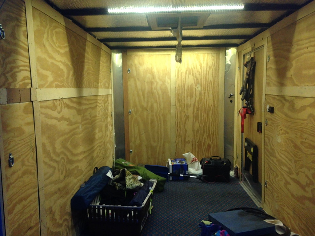

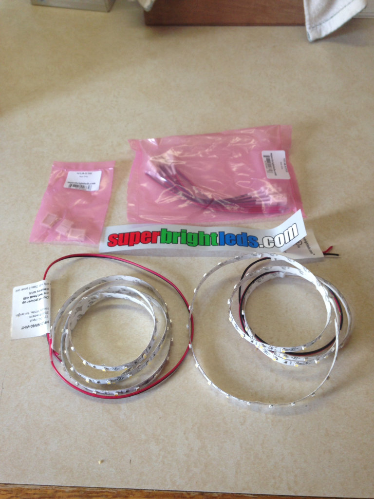

    Got my interior lighting in today. With two 6 foot sections, if I need more light all I need to do is attach more with the special no solder connectors that I got.
    16bfd1336e859721a5fe352b7b438e6b_zps53f4_d45d3157525dfd9511d54162084f120aa9579116.jpg

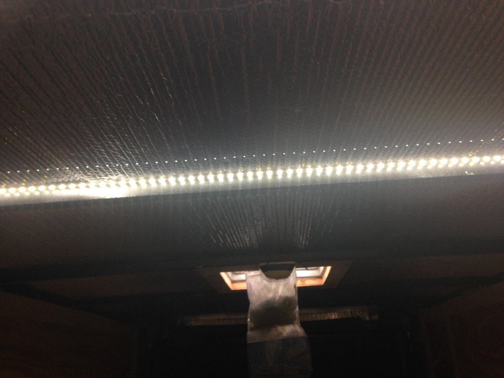

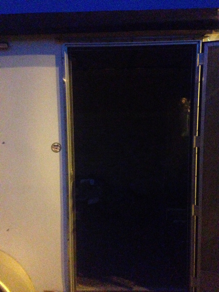

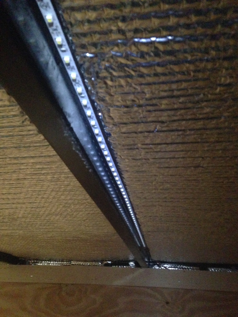

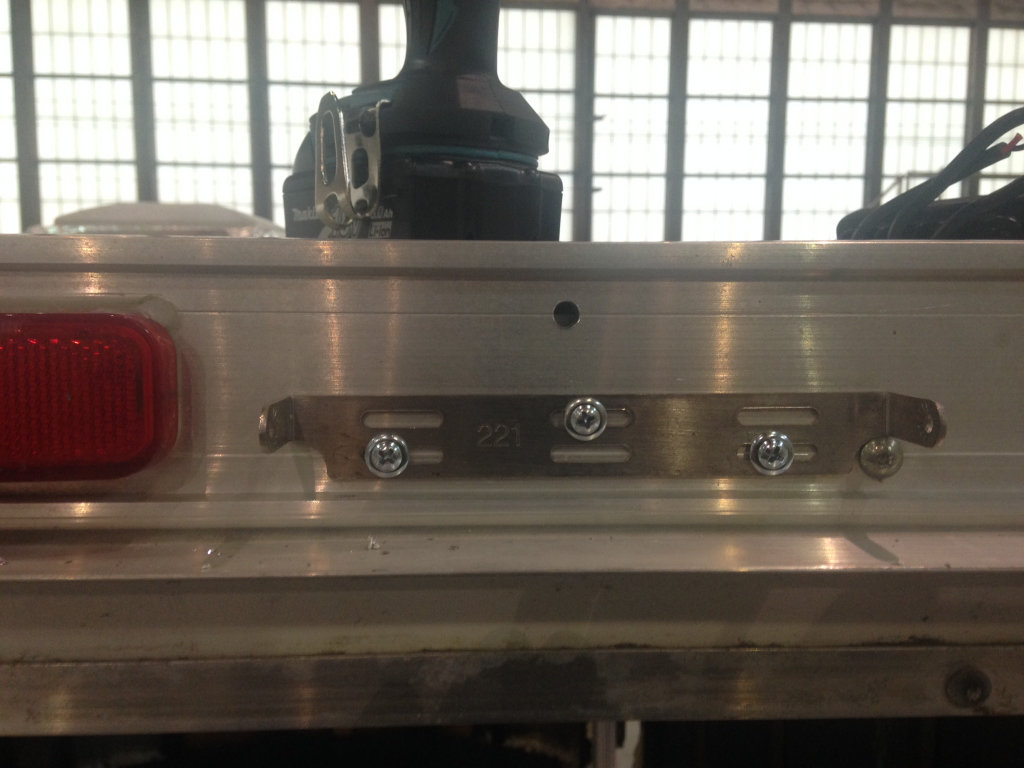

    So I finally got around to mounting my lights. They come with double sided tape and I mounted them to the roof ribs. Now they are bight but not blinding which is perfect.
    c6cc605b41f77ebf98c6c95610fca5ce_zpskpkn_0598d31bc2ab164922f1ee5672806e749597e9bd.jpg
    Lit up
    b8776070614e26df3e835b68984d76b2_zpsqksj_49bd394b4658153e4d4ad1f34dd17420f3fb64d2.jpg
    This is one strip only, you can see that they put out a very good amount of light for only being 3 feet long
    6a301a5bc2e86b08bd7ecc9fe936c7ac_zpskp9x_00568cb0c9dd7800129085aeabb0c4eaac2bbc0a.jpg
    Lights off
    af1d184e61eaaffc203cddac5b98aed3_zpserxy_d9983da4055688f1a3d420ca4f13ca0c55f03d1f.jpg
    And on, let there be light!!
    429a15f041f6ef391d79cea7836ae164_zpso2iv_b262fde62c6f05ce485b02961bdb20af250fbd63.jpg
    acd00dd23de721fcf6e825e5b91d9503_zpsvso1_98c9524c915528e4f9743a78ec7286896e0f81fa.jpg
    From the side door
    6351061d5e04fa4ac8a52434199061fe_zpsnib7_2e73fc3999a2346f5dc6057d413c33429f6d1b17.jpg
    4528d52aec5350b0ed22e281215f9db6_zpsopof_54df400f0d68fd2a86c87058d7b5580cd393175f.jpg
    And some night shots of my exterior lights
    Off
    281ac786f9861491fc51f0375bed64f4_zpshfcw_d2c749fd8a69278886194aee16f42137c3f0df75.jpg
    On
    50f26e66a1d379749542549a6460599a_zpsn6vk_9b2d0cb76aeda0604fadaf881bc83f3e7fe0c386.jpg
    4357bcfee055c45e9860bf9d45bcbd40_zpszcvv_f0eb9c22d0d7526df4b5bd347ec32b3d996bba26.jpg
    55a0d96ed9ba9cb727bf516d9d95462c_zpsdcil_45b436f4b062b82d0c61fa29dc0c5467387d4cad.jpg

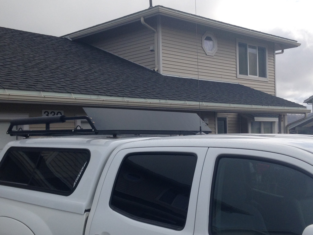

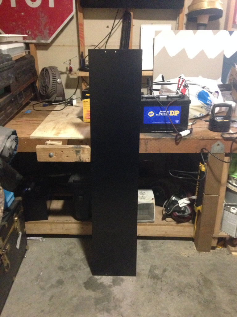

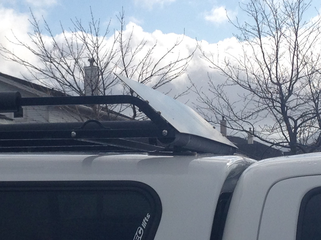

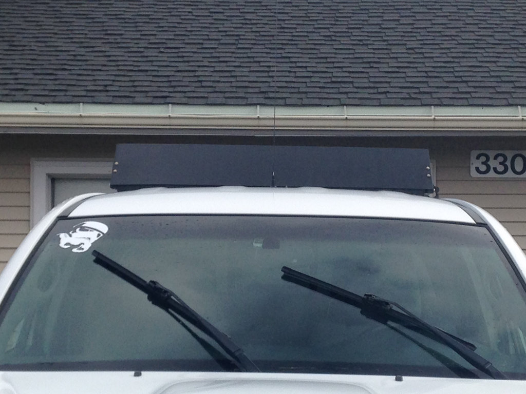

    So I had an early Friday today so I got some stuff done. I made a wind deflector for my roof rack out of some scrap aluminum we had down at the hangar. I put it in the paint booth and gave it a couple coats. I also got a pair of free napa deep cycle batteries from a buddy to replace the old truck battery I had been using. One 180 min reserve capacity should do fine for my needs, with the ability to add another one. The other one will be used on my new beavertail 2000 sneak boat.
    Wind deflector.
    caf7faf2f674ba832c76aa938832a496_zpsgzd2_f3de007db8c15b9c007786cd3cef125076314eac.jpg
    bcf91f13e8ddcb7adbf849ced4bf6815_zpsycri_1ab4a7a1667a1ed68b0f295622a29e82f74865c1.jpg

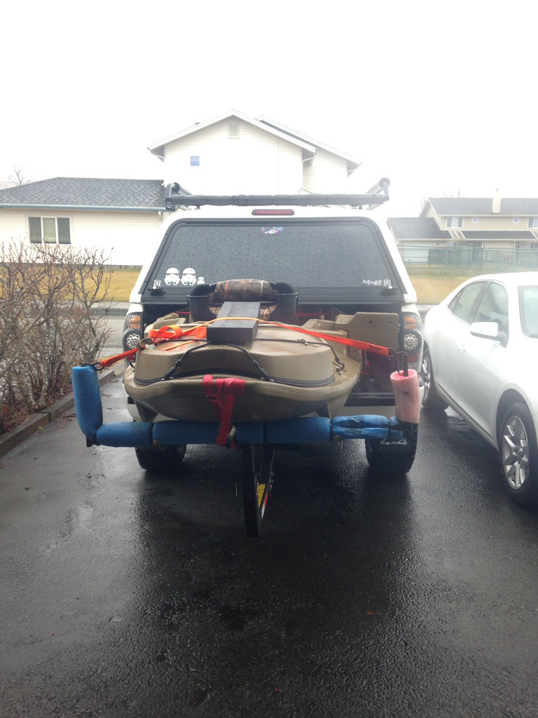

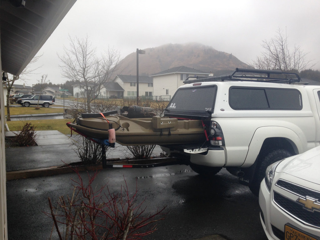

    New digs. It will fit in the trailer at a diagonal or with the bow up on the front wall.
    9147c75bdabe5080c5f1d7977a59f531_zpsxsax_3c5d4bda9c932757278bf6597ed9823c801ef03a.jpg
    This one will be used with a Newport Vessles 55lb thrust trolling motor
    8c540682c3058ebb1579676ca81fdd13_zps2ce9_0f7a912c7939e3d6c60f917c94a3fb682725cfae.jpg
    Or I can put it in my truck bed
    28365e3e1fb2c4b38e1ff82f7000570d_zpslb90_fb797ebad1a13acf964c86d92941ef0da8b88b56.jpg
    96ac7aff257cf08384f894b0519928ef_zpsau3e_5f6d4c89791f40d120fbf1dd6fc2eb625f7b8076.jpg

    So I mounted the wind deflector to my truck today, I just bolted it it to the rack.
    c3badf58cc577154260ff1f5df630371_zps950m_e78923bfd4889a393c1b547f17c95a0f883a1be9.jpg
    2ee0f00d5ac50824d47dd3407f5e7a1b_zpspypk_76202cc2871e6990944454347a03142b7abf4003.jpg
    And with it mounted, it's the perfect width of the rack
    34e19a87c82e39db06d921050321701e_zpscbda_c5db0ca1f2ec43017131c8a57a19ae2cd0ec9124.jpg
    34748d06377eb6140ace007904febc33_zpsw5yx_6765a5e8b4cf8fdd1d07ae543a8c21935cddbd58.jpg
    2265c55d81feec0216ab7fad8e4df021_zpsufee_fe49c96075179b3de391db95fd38aac0341c40a9.jpg
    I also replaced this battery that I was using
    1b558b05748d39fa222420b58e78a109_zpstm5q_7c7a04c510d130fb985e4f120fa24b5c08bd6bcb.jpg
    05a3279edac45433a95d30864242784e_zps5v26_d741f81031a50b0614897a61552f9aaed91478b8.jpg
