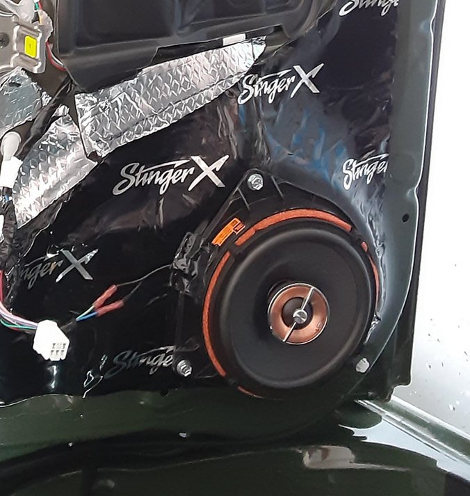

    As dumb as this sounds. I had 2 sets of speakers installed in my 2012 DCSB. Kenwood and JBL. And a set of Infinity's in my current 2020 Pro.
    All by a local sound shop. Total installed time right at 10 years with never an issue.
    This I'm sure will draw some negative comments. But in both trucks for all three sets they used the factory speaker as an adaptor.
    Simply knocked/cut the cone out of the factory speaker. Screwed the replacement speaker into the factory speaker frame.
    Then remounted the factory frame into the door. Here's a pick of the back door with the Infinity's mounted in the factory JBL frame.
