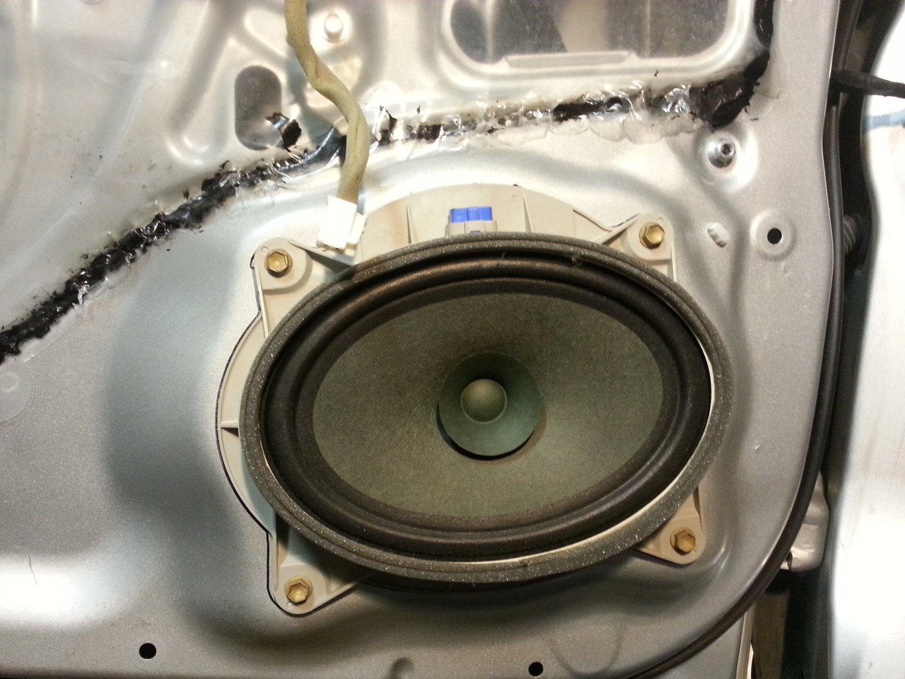

    stock setup in front door, outlined with sharpie

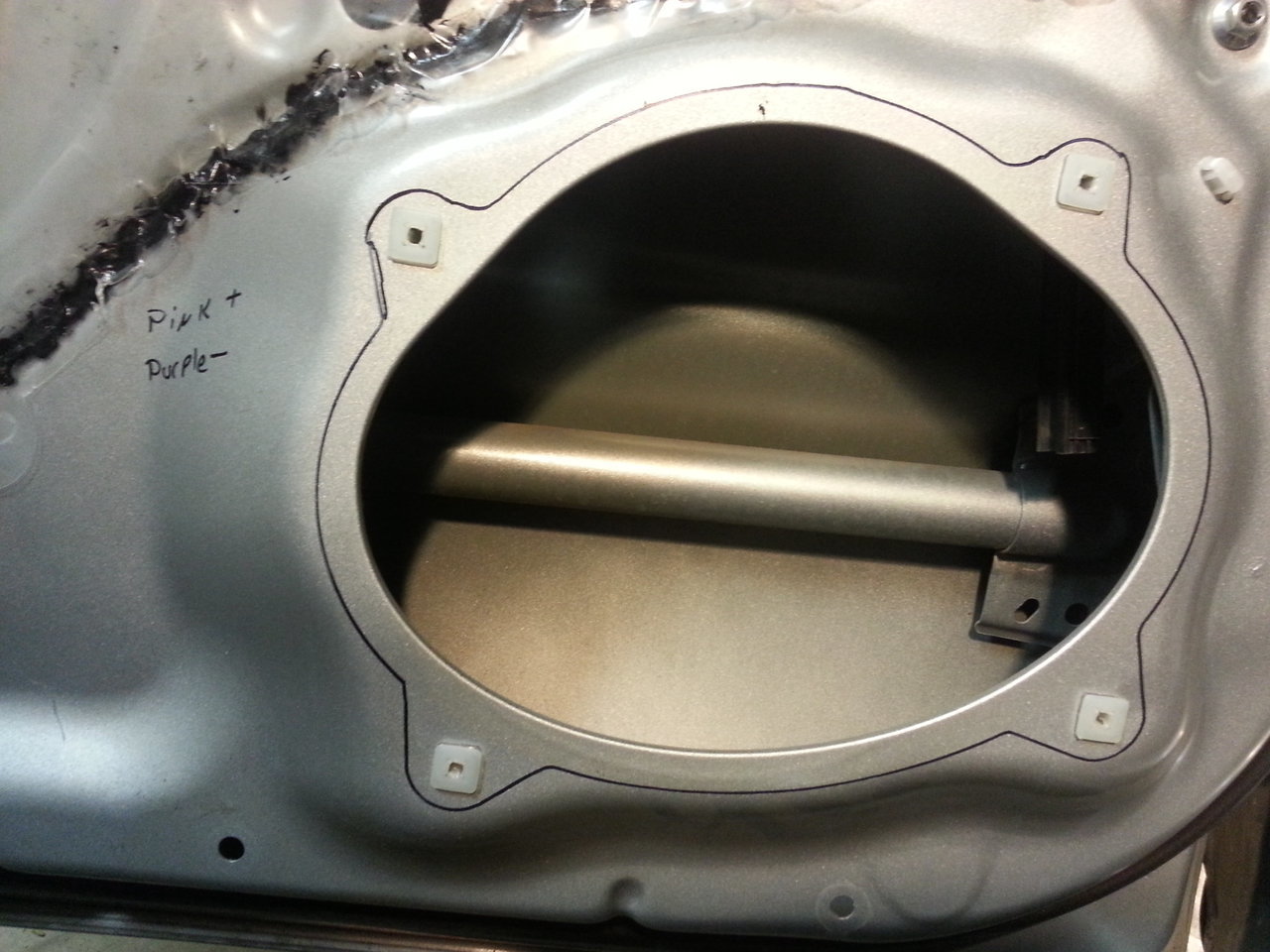

    what your left to work with....... nevermind my color code cheat sheet... I hijacked the signal further up the line because the stock setup runs signal to the tweeter first, and then to the lower driver and I wanted to disable all stock crap

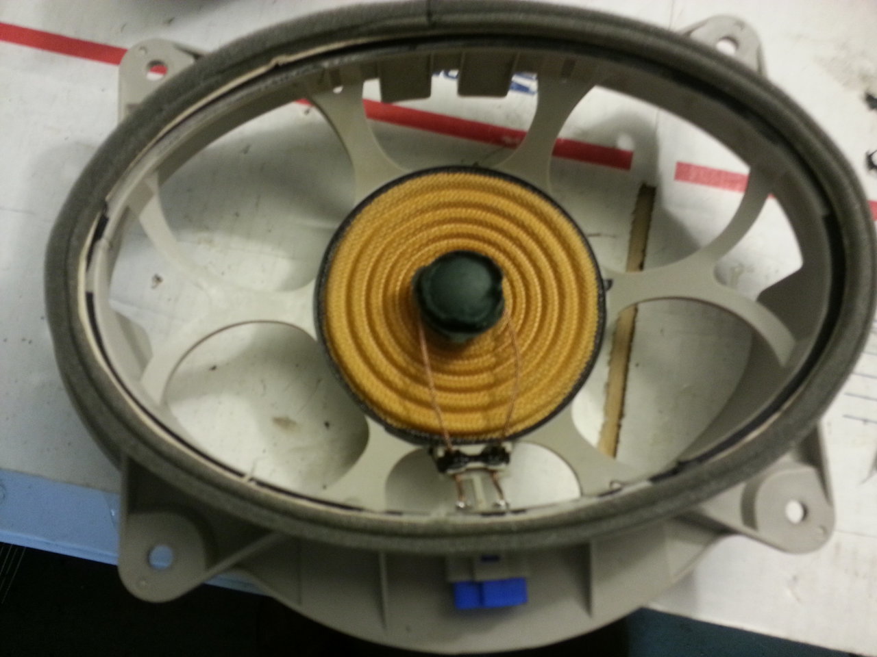

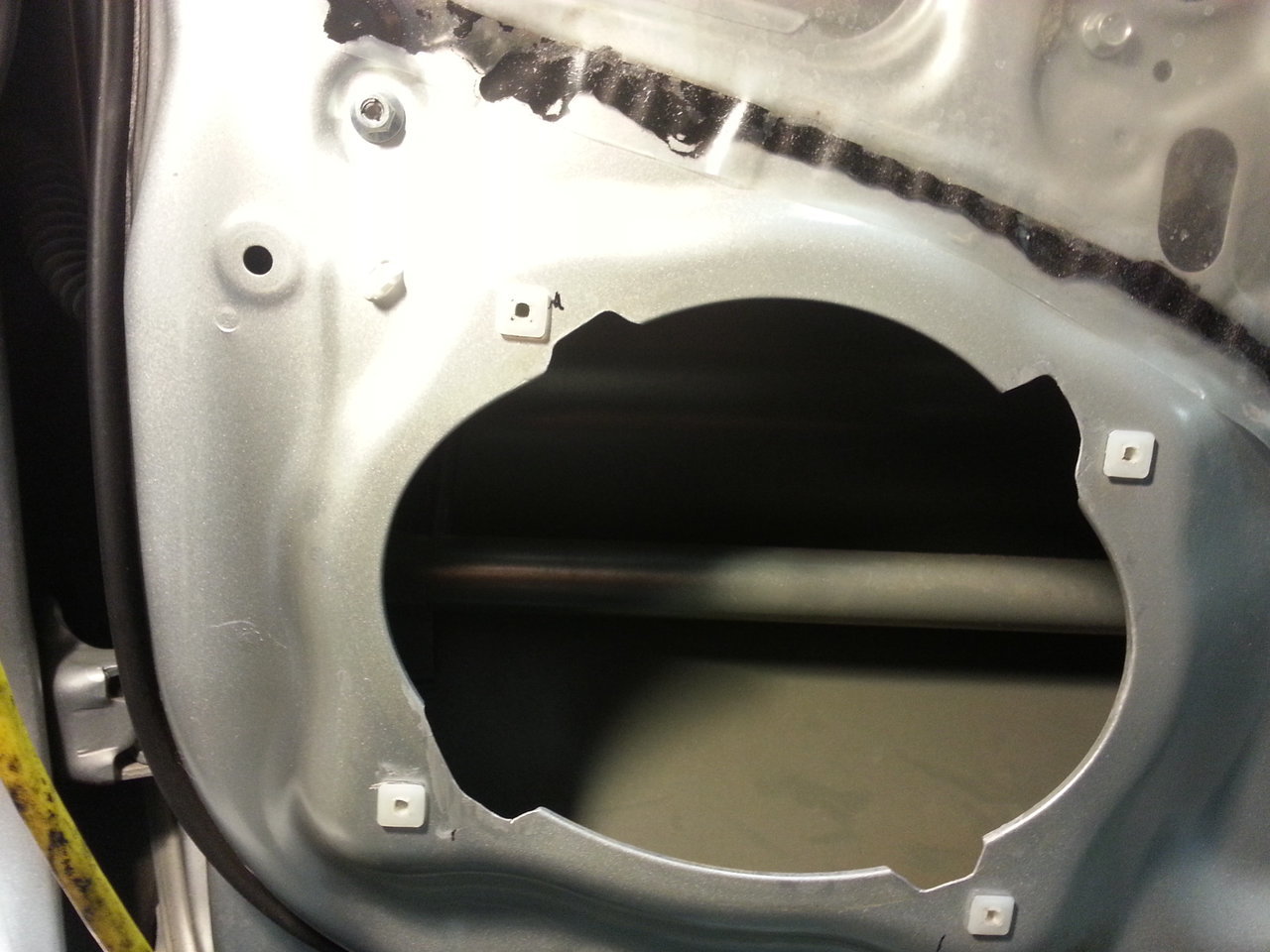

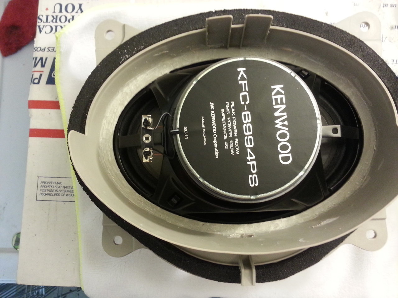

    heres the factory mounting bracket.....what can we do with this?

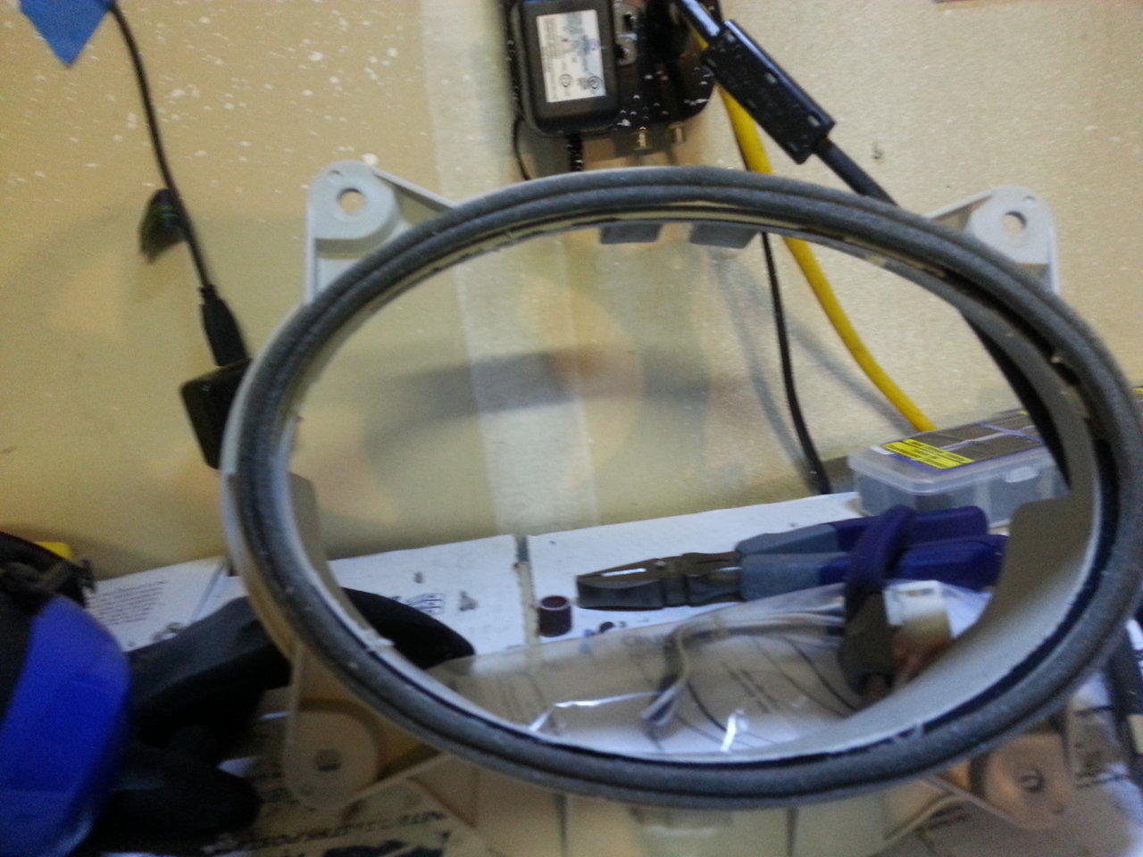

    well I wont use the drivers anyhow, so lets open things up a little using razor knife
    and now for the dremel
    needs some more massaging, but its getting there
    better

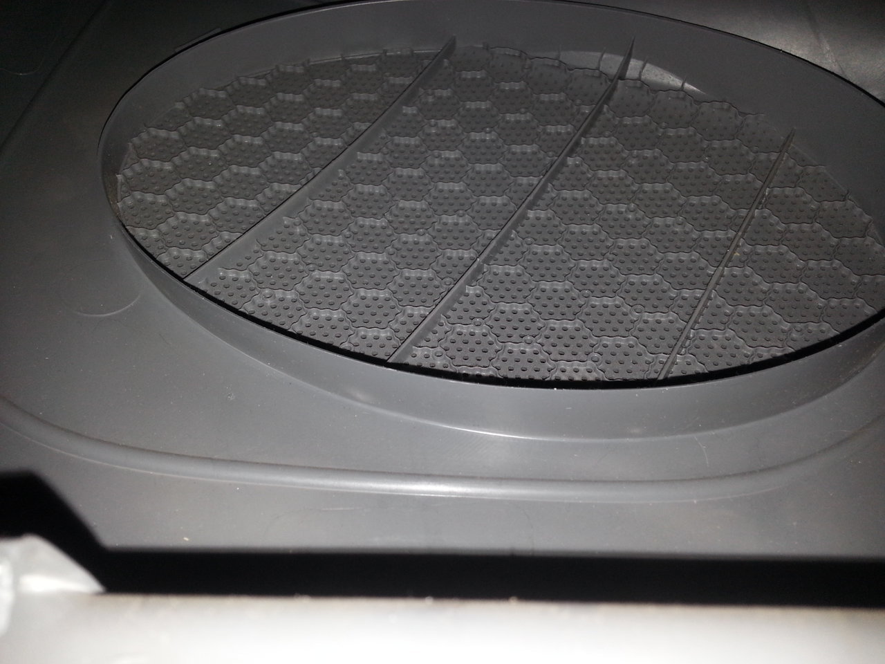

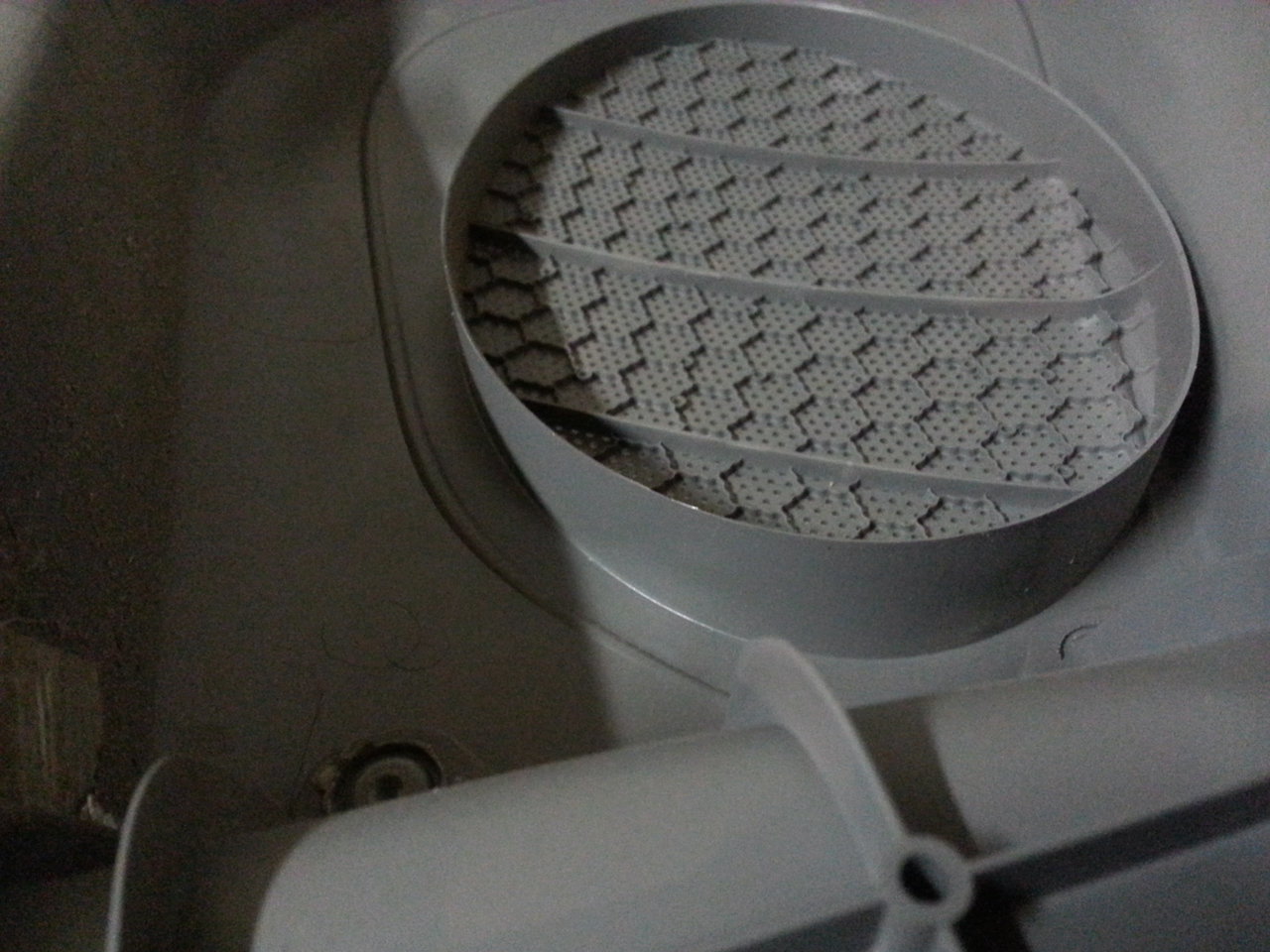

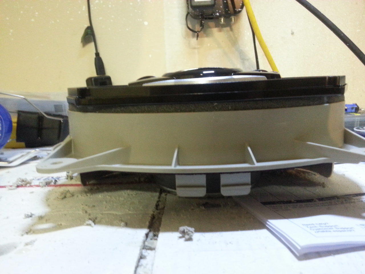

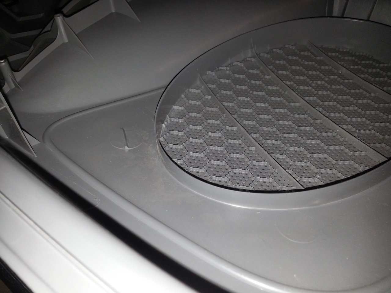

    Time to move onto that large lip on the door panel that would hit the speaker.......yeah, we have a little bit of space to work with here :D
    time for some more dremel action.....almost done here, but it needed to be completely ground down, including those 3 vertical ribs, those touched the plastic bar that goes across the speakers midrange just a tad

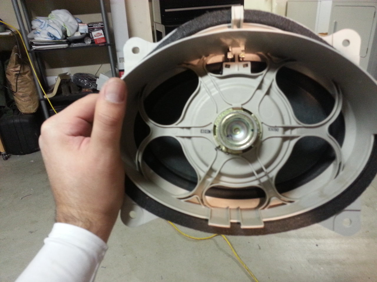

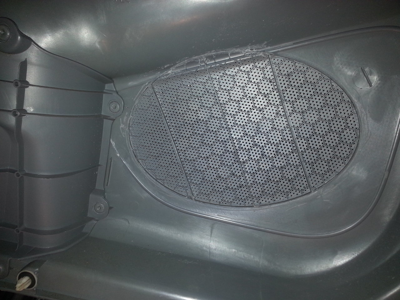

    After some more work with the dremel and a composite cutoff wheel, a sanding drum, and finally a fine grit stone, things were smoothed out and cleaned of debris with air compressor nozzle. Sorry forgot to take pics, but basically like I said. I had to bring those vertical ribs flush with the rest of the "grill".

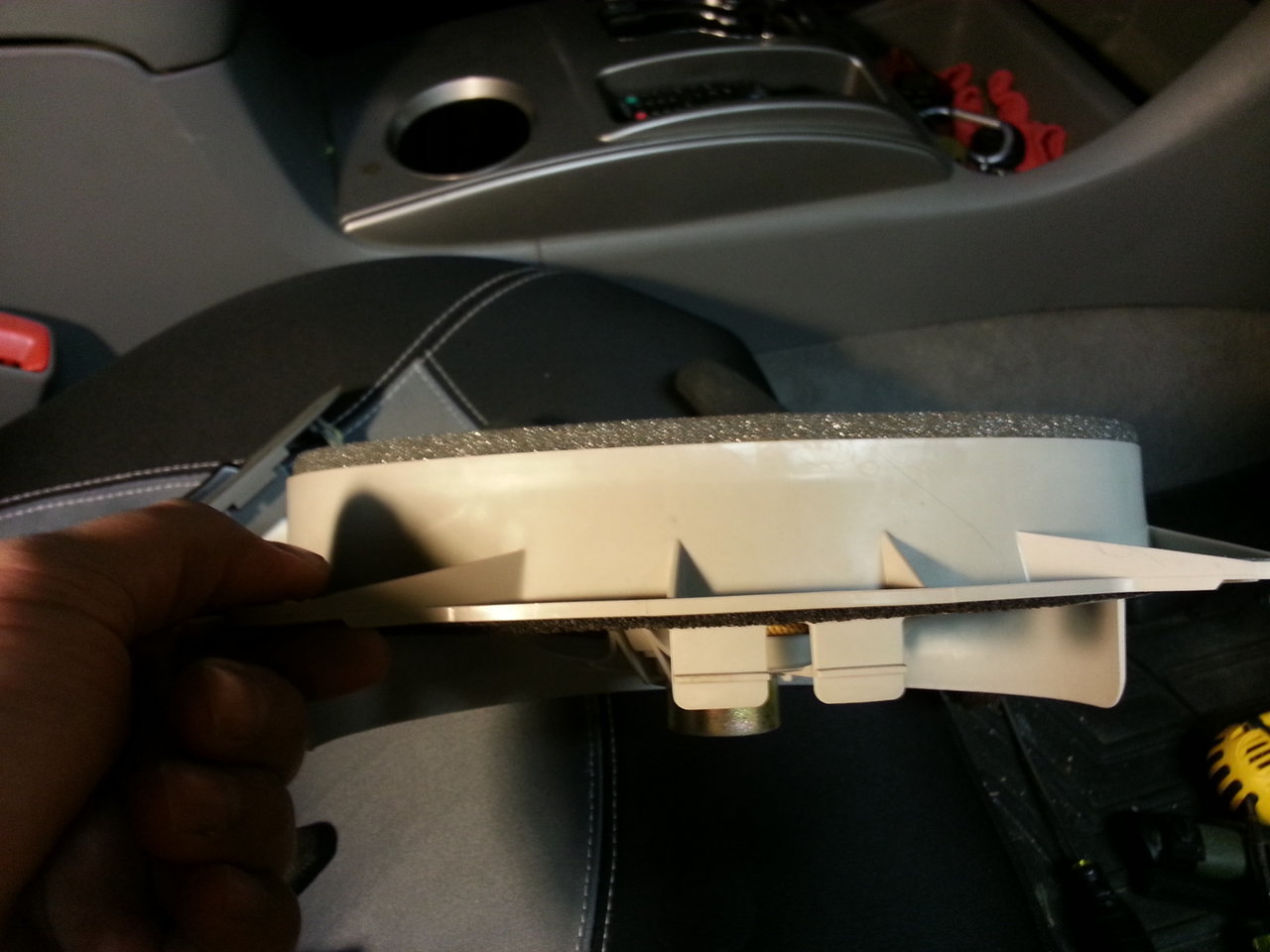

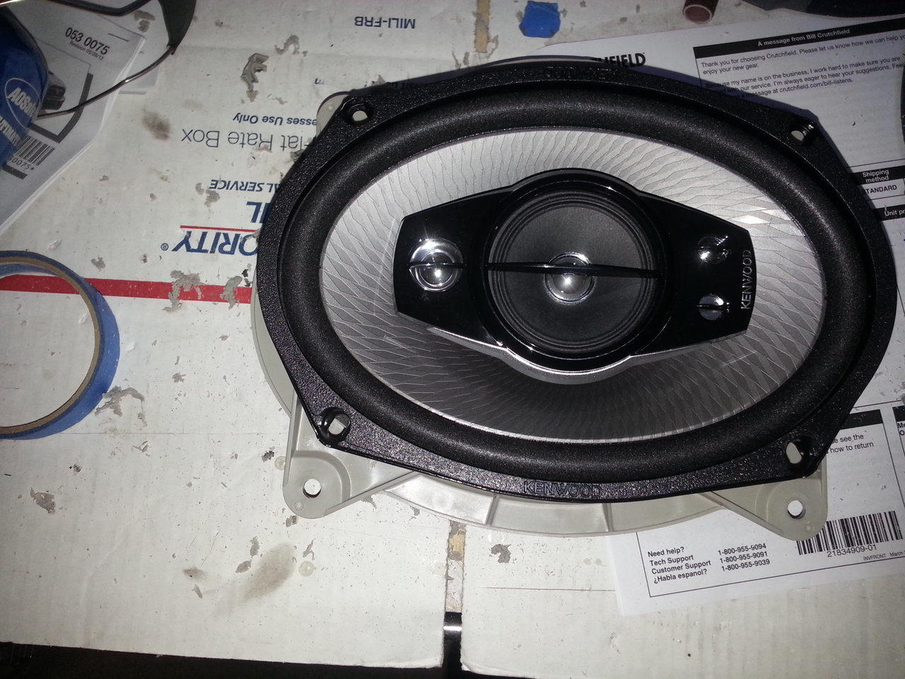

    Now, test fitting showed I was all clear EXCEPT that the screws used to mount the new speakers onto the factory housings came into contact with the doors sheet metal. The screws I used were #10 x 2" and only extend past the brackets less than 1/4"..... Between the factory brackets and the speaker depth, these screws were a good fit. I tried nuts and bolts, but only had 1 bolt that would have worked... If these screws loosen up over time, I will use that 1 bolt I have for reference and buy enough to replace the screws.
    I ended up marking the contact areas with a sharpie (love them damn things, and the ink comes off with a MR.Clean magic eraser).
    I then picked up my trusty Dremel, a few cheap cutoff wheels, the sanding drum, and fine grit stone grinder... Went to town and made my notches.

    used factory screws to mount brackets to the door, and I used that 1 bolt that I said ended up fitting on this speaker with a nut, washer, and lock washer for safe keeping (top left). I used the #10 x2" screws in the remaining 3 mounting holes

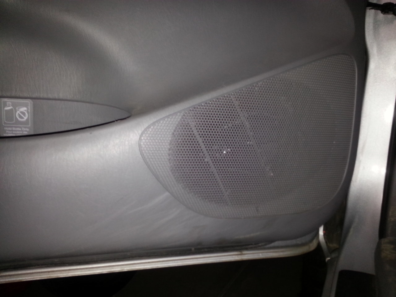

    nothing to look at when ur done really, looks factory....... pardon the scuffs, I wasnt aware how often I make contact with the door and my foot before I took this pic :eek:
