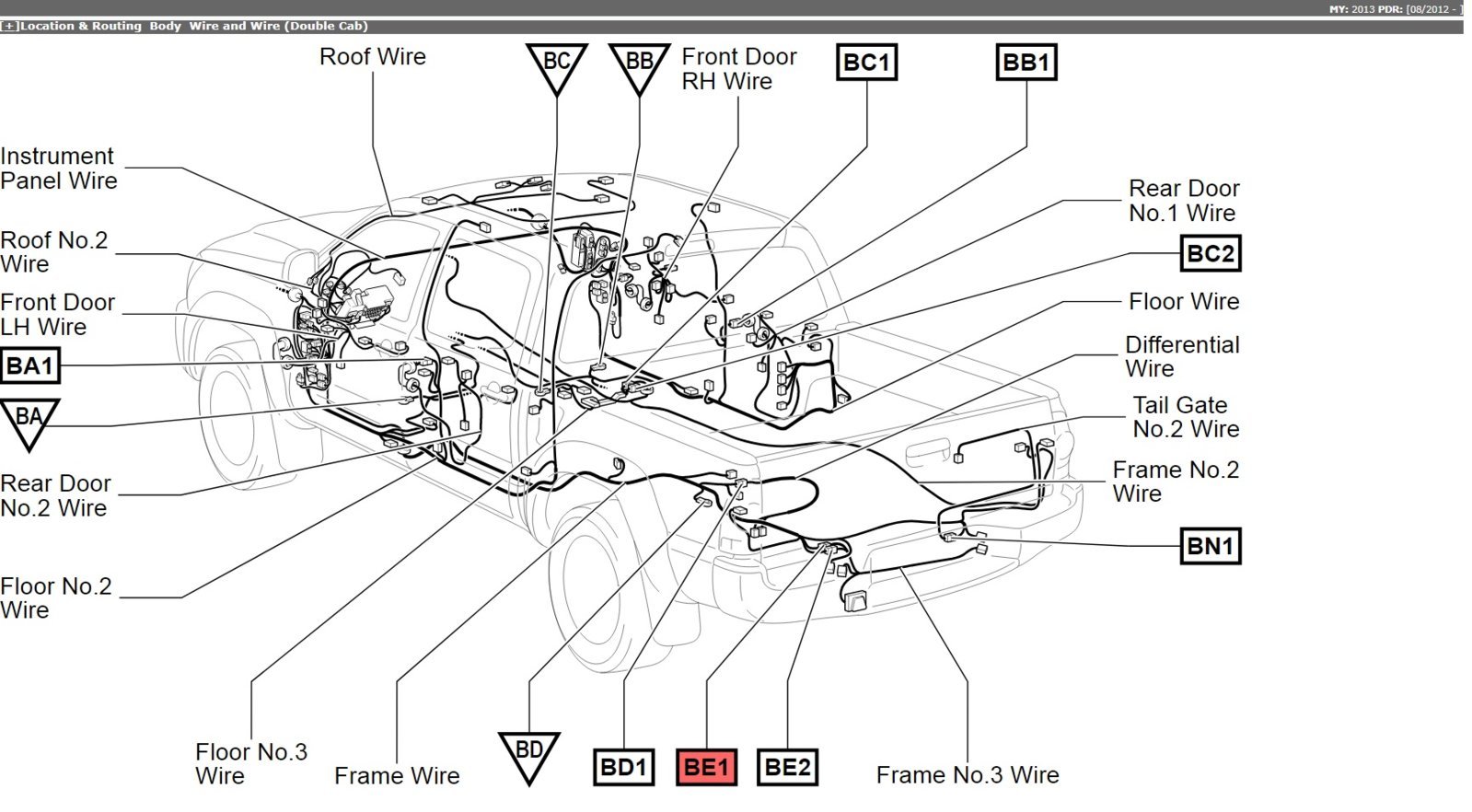

    Check Connector BE1 for corroded pins.
    No converter on a 2013 with the factory tow package, the turn signal feed for the trailer plug comes direct from the flasher relay.

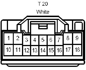

    Test the output at the cab Haz/Turn/Tow relay (red wire _9 location)
    Sequence looking INTO connector, probe wire side.
