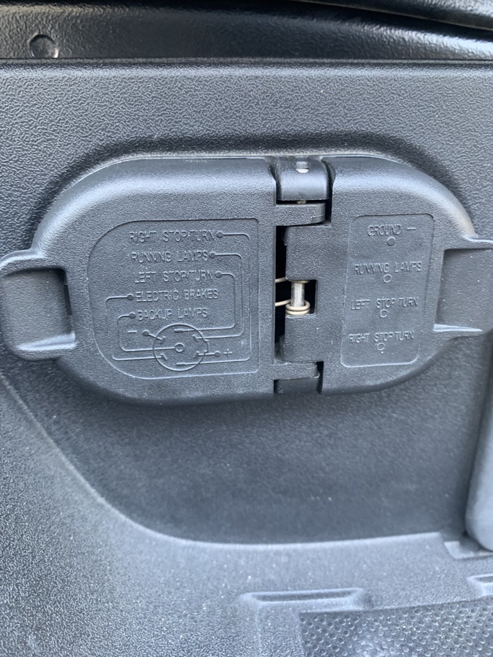

    I’m pretty sure there is a pin out on the 7-pin cover. The one you flip up to insert the connector.
    I’d start by seeing if you have power to the pins that a labeled.
    I’d have to take look at mine, but I think it’s the one labeled “Battery” that has constant 12v power. Start by seeing if it has power.

    I believe Curt told me it's the pin that is in the one o'clock position

    Well if it’s the pin in the 1’ o’clock position, the running/head lights would need to be on to have power to that pin.
    The pin at the 4 o’clock position is power at all times.

    Ok I just checked the postive pin....no current at all when the vehicle is off AND on.
