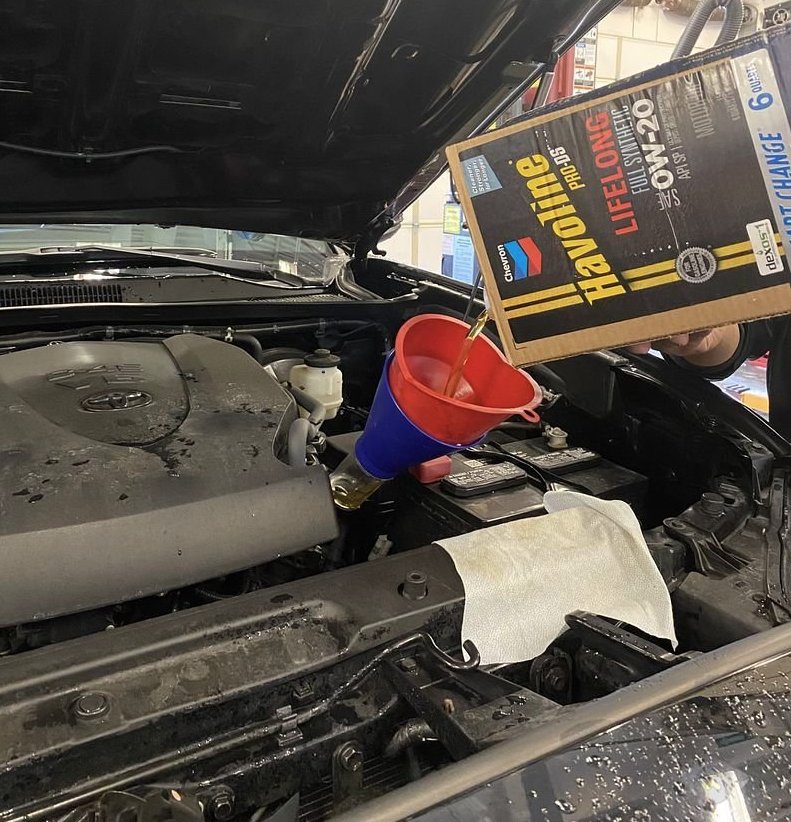

    Got this OIL suggestion from Chloe Kuo!
    6 Quarts in the Box!
