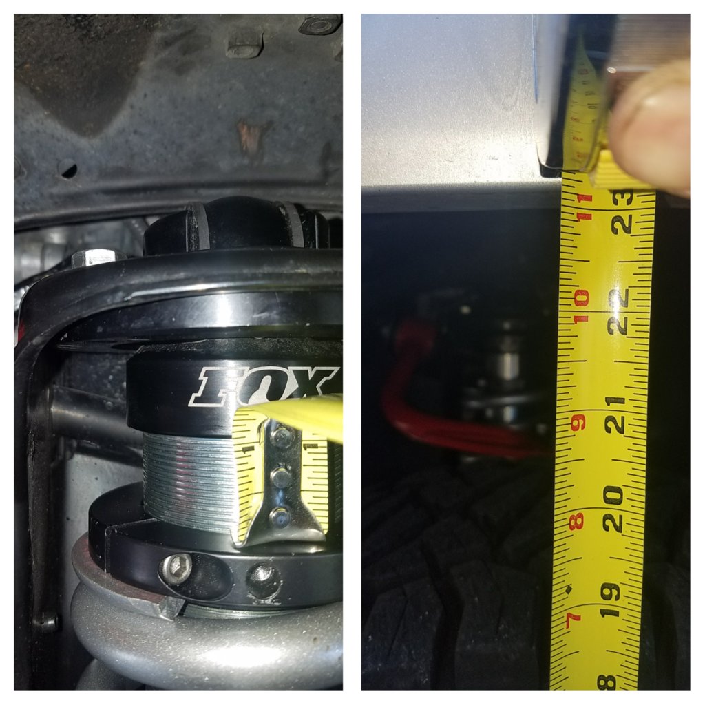

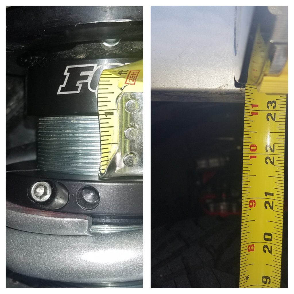

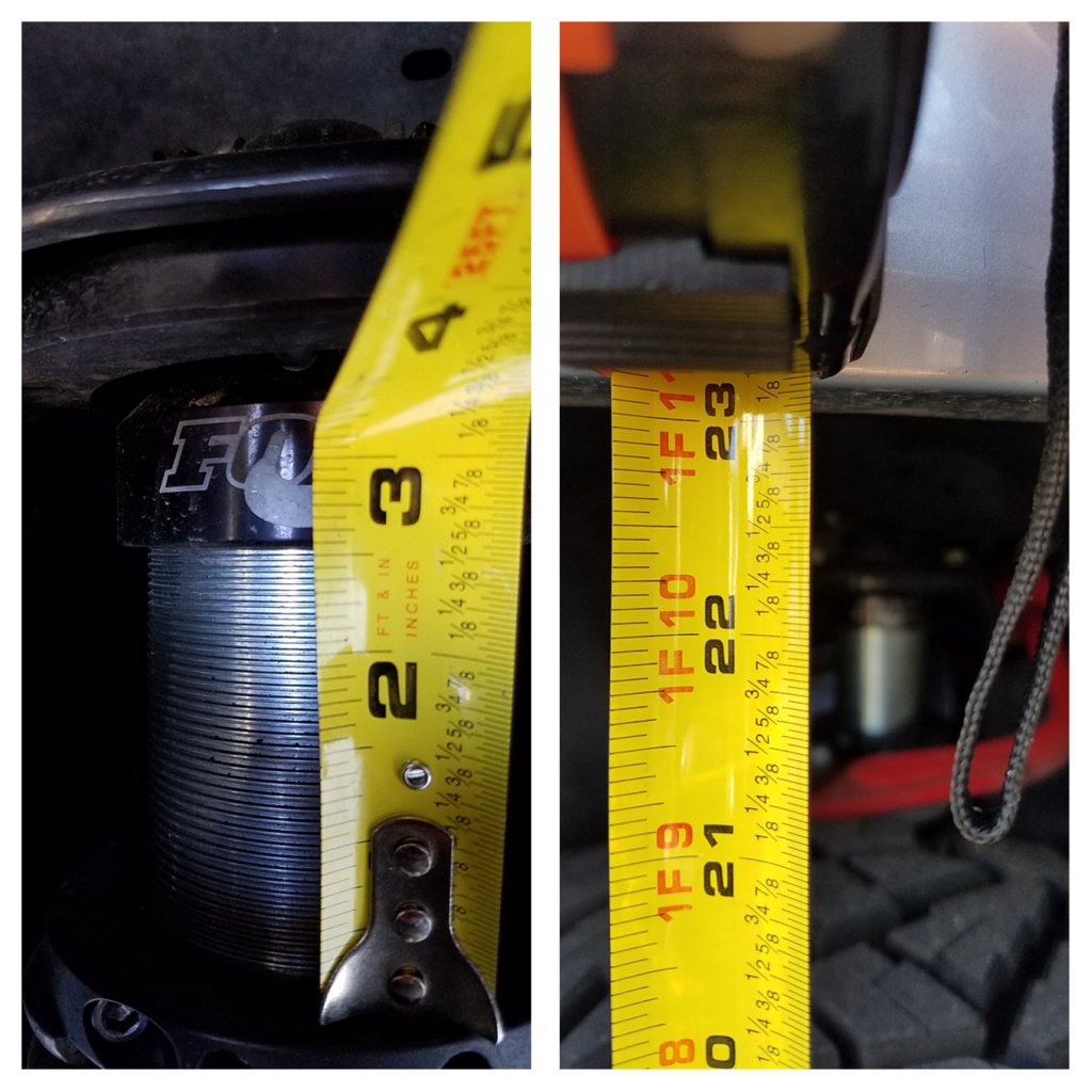

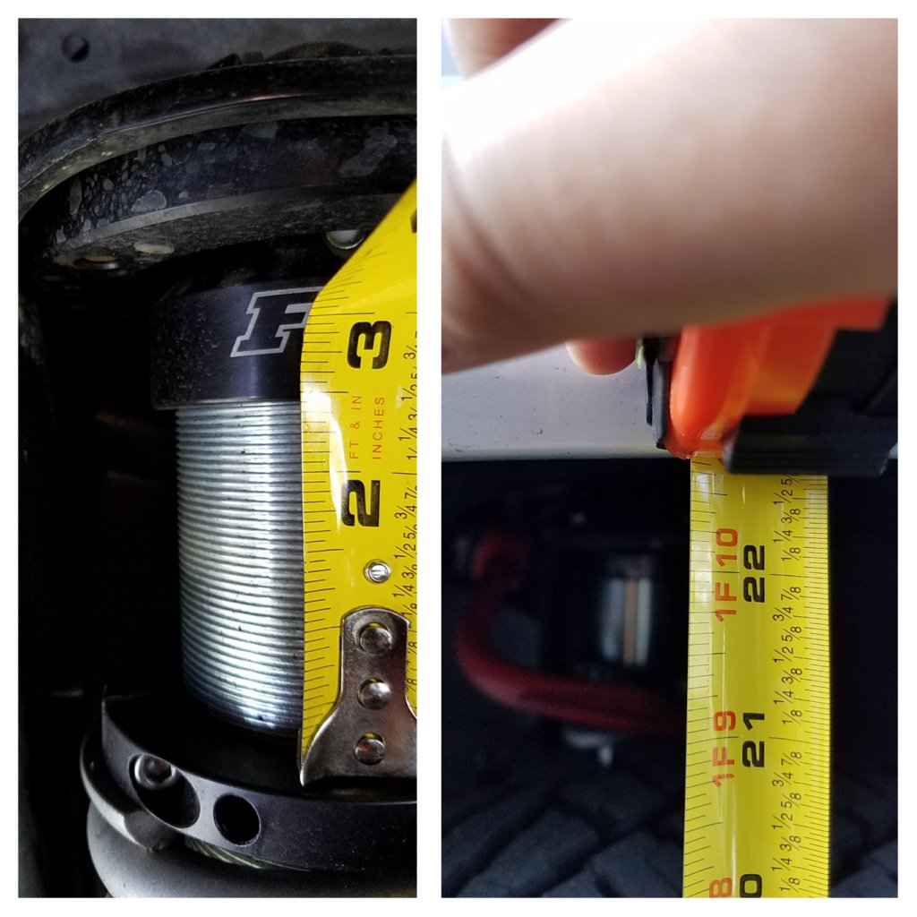

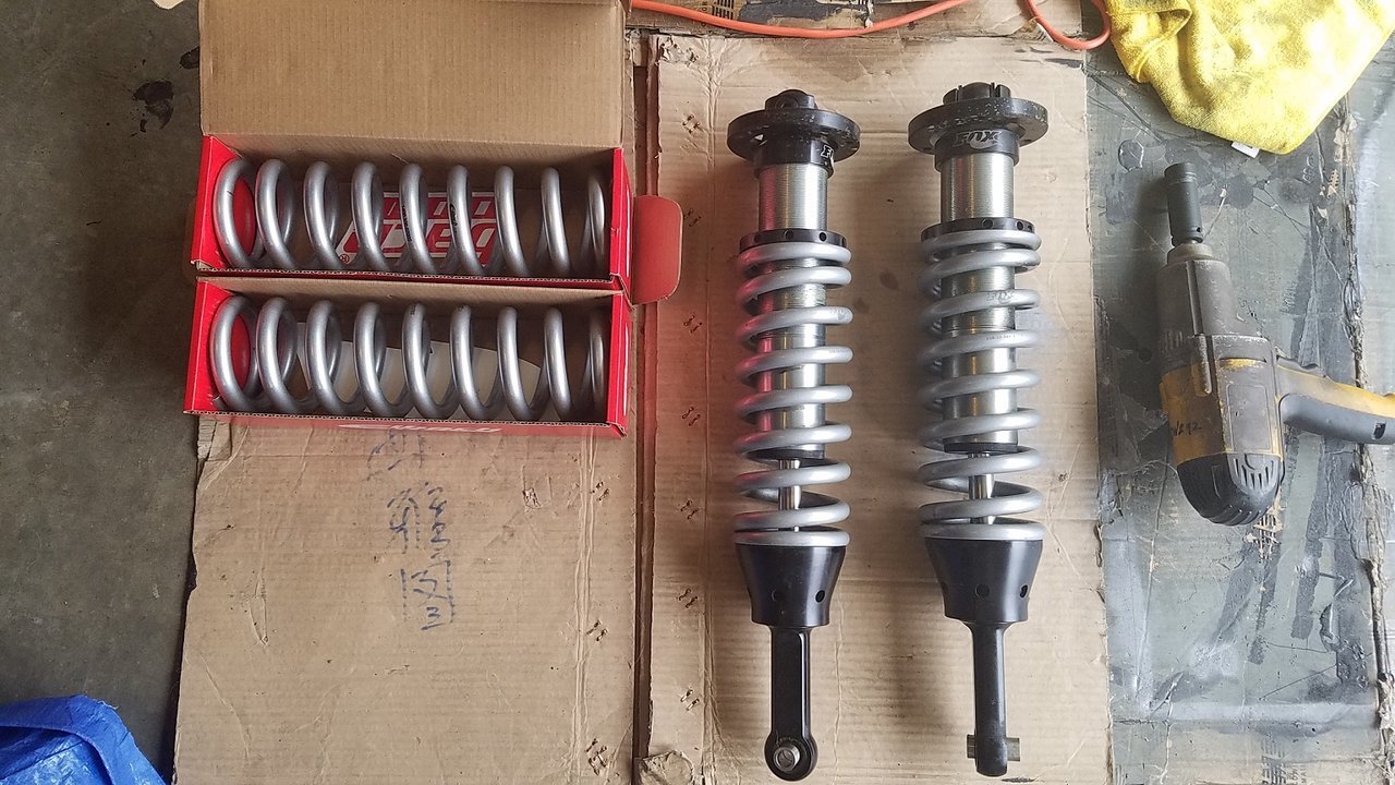

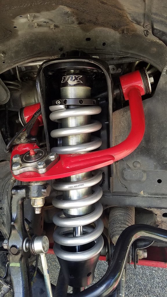

    Update to my thread. I installed the 14" 700# Eibach coils onto my 2.5 IFP. Rides a bit stiffer, not as plush as the stock Fox/Eibach coils. Feels better IMO with additional weight up front. Here are my before and after measurements of preload and hub to fender.
    Before: 13" 600# Fox/Eibach coils.
    Driver side
    Passenger side
    Current setup: 14" 700# Eibach coils
    Driver side
    Passenger side
