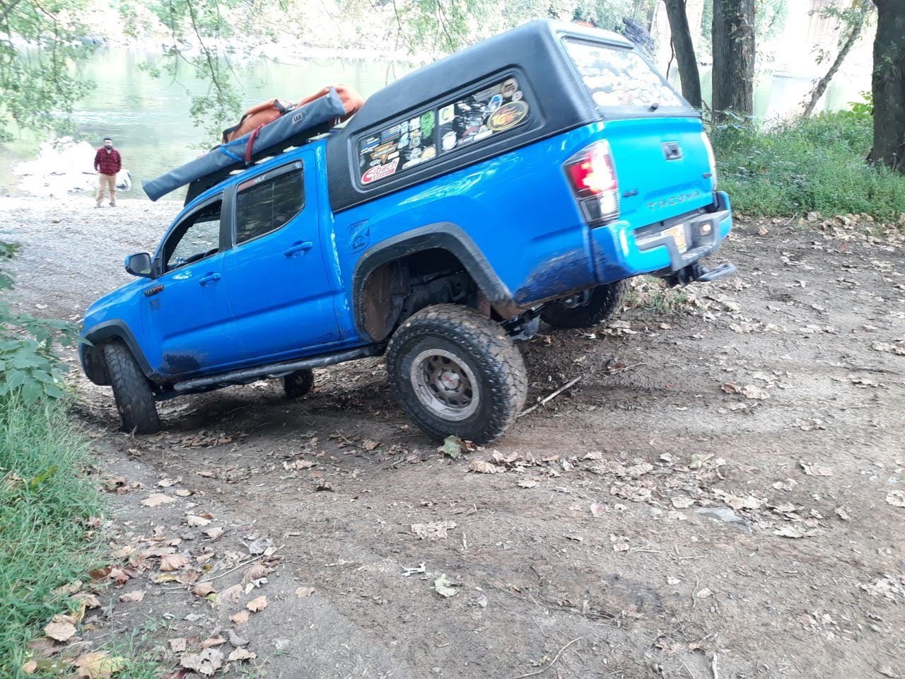

    I watched the key points of the video and this demonstrates perfectly what they wanted to show. I've got to say though, I am not surprised.
    I hope they do a follow up after cycling each truck in these conditions a couple hundred times. Especially after adding a considerable amount of weight to the axles. I'd also like to see the difference of each truck on older fire roads and forest trails to see what they think about comfort.
    I was surprised the first time I took mine (stock suspension) off road after adding 33's. It did exceptionally well.
