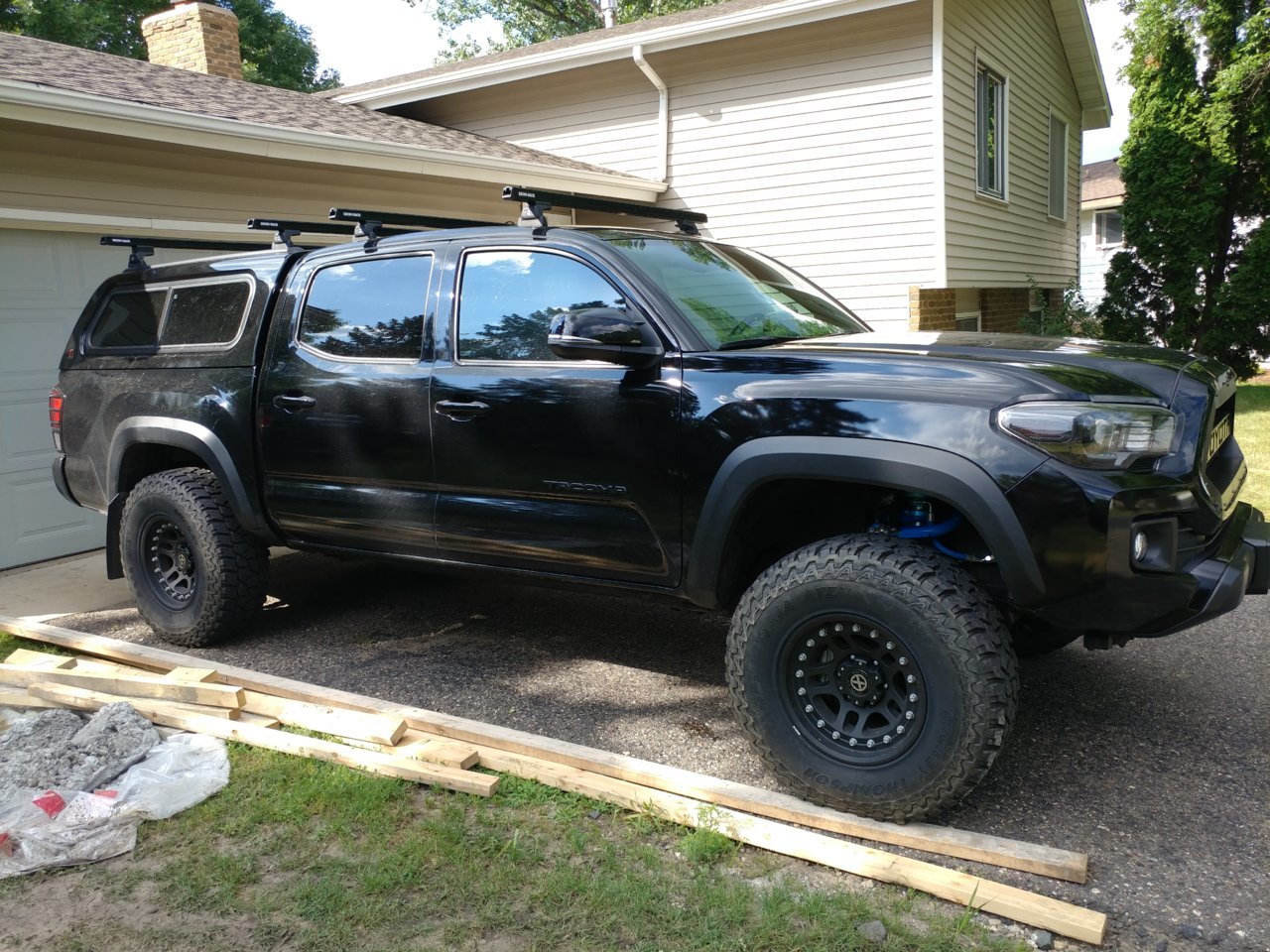

  9. Jul 30, 2018 at 3:18 PM
    Ravnikar610
    Ravnikar610 [OP] Well-Known Member
    Sep 9, 2016
    #196826
    330
    Minnesota
    2016 OR DCSB
    Cali. Shit lighting in the pic but here it is to give you an idea.
    SilverII likes this.
  10. Jul 30, 2018 at 3:22 PM
    tcjacado
    tcjacado Well-Known Member
    Aug 29, 2016
    #195947
    41,586
    The front sits higher than the back.... add the weight to the front and it will soften it up. Mine rode like shit for a while until i added the front bumper. I was a little over 5 inches in the front and 4 in the back. Once the bumper was on it leveled out and rode like a dream. Unfortunately I lost power steering as my rack shit the bed on its second trip with the bumper. I am not running a larger tire as of yet.

  19. Jul 31, 2018 at 2:23 PM
    #19
    Ravnikar610
    Sep 9, 2016
    #196826
    330
    Minnesota
    2016 OR DCSB
    No. I messed up and installed the fixed mounts on the cab. It's okay though because I want to carry lineal shit and it's now far enough forward to mount a light bar in the future.
