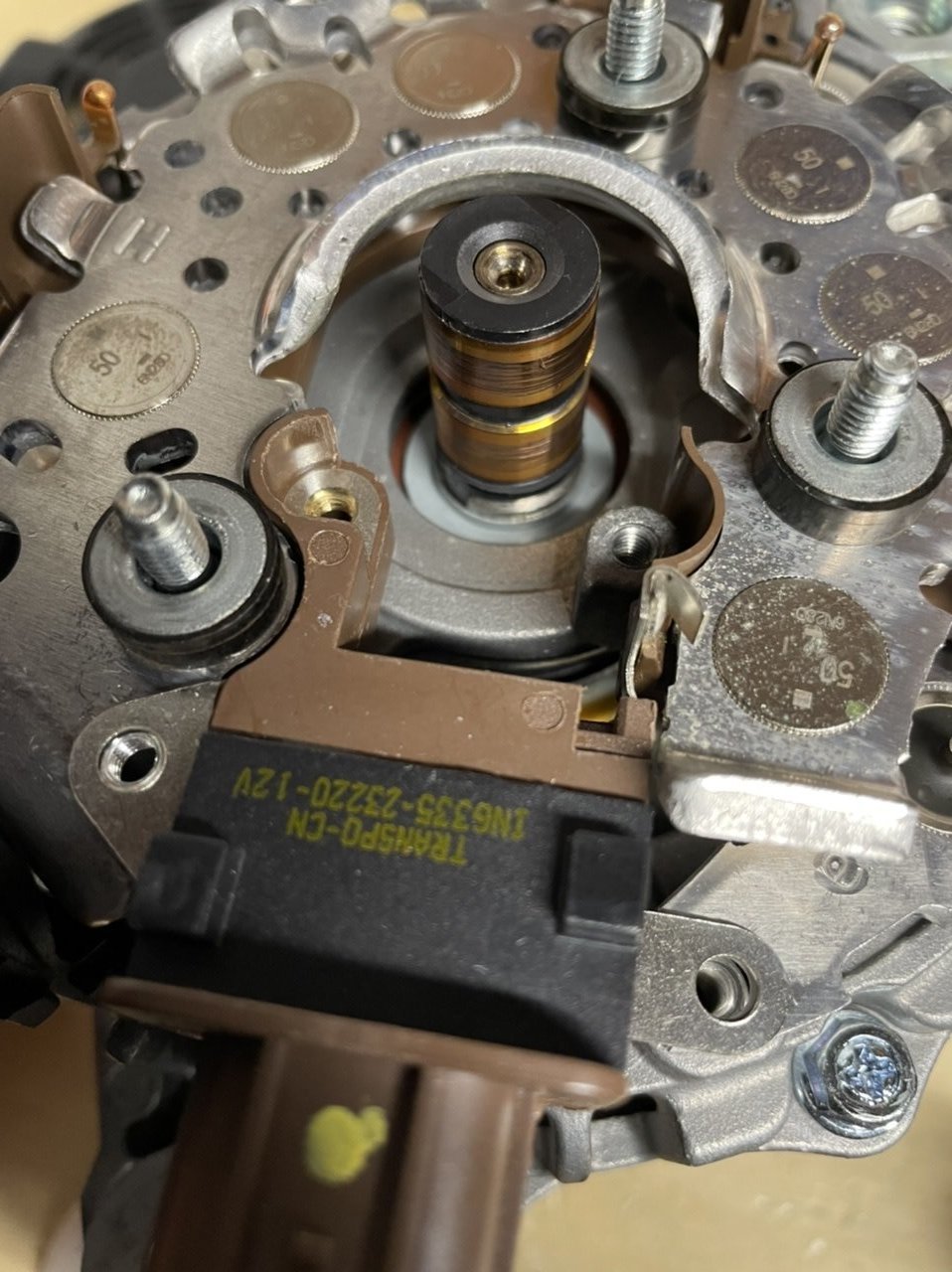

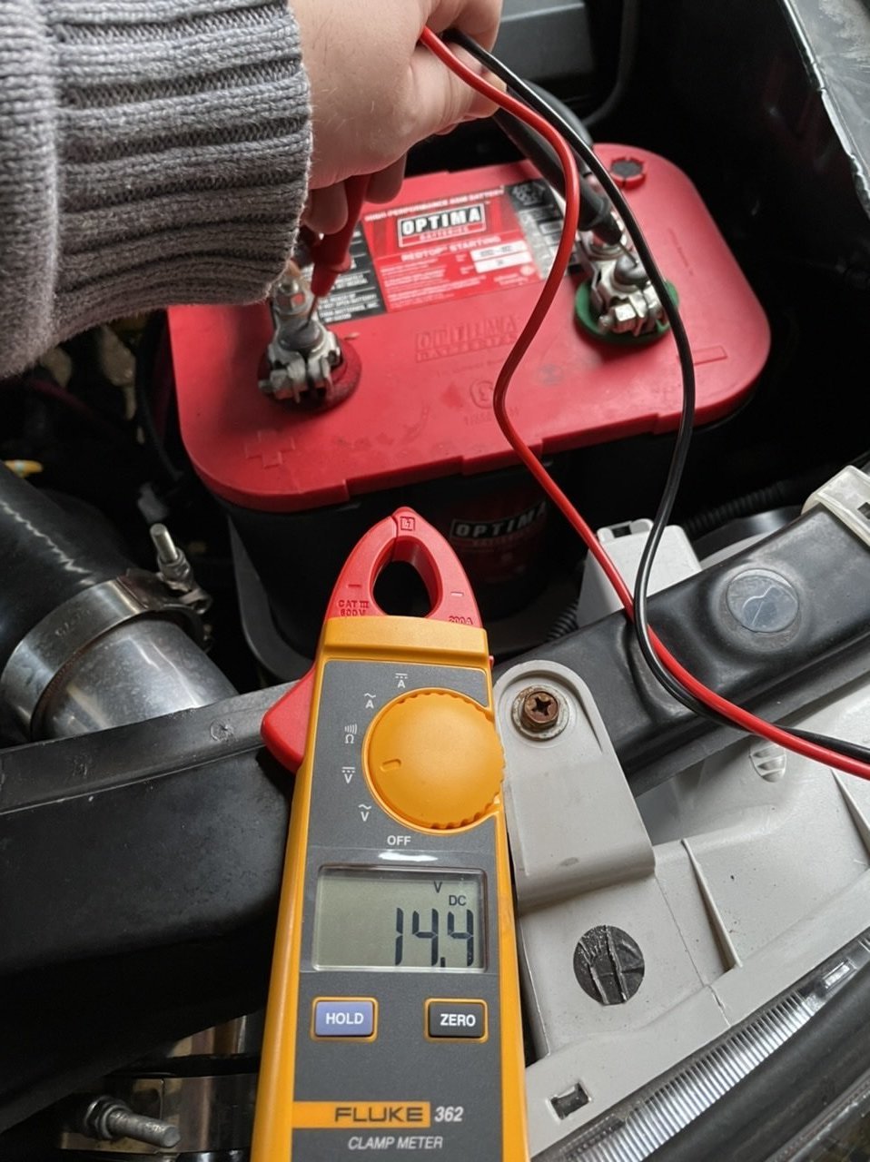

    I searched high and low for a higher voltage regulator to swap into my alternator for better AGM charging, the diode mod isn't ideal and monthly trickle charging has become annoying. I didn't find one however I did find a vehicle with the 2TR in another market that comes with a 130 amp alternator. This alternator regulator has the same voltage output as ours, not the best for AGM battery charging, however it’s a newer design and potentially had a different selection of regulators to swap for a higher voltage output. I found a regulator with advertised 14.5v that seemed to have the correct circuit so I took the chance and pulled the trigger. I installed it today and I measure 14.4v at the battery :D

    IN6335 Regulator

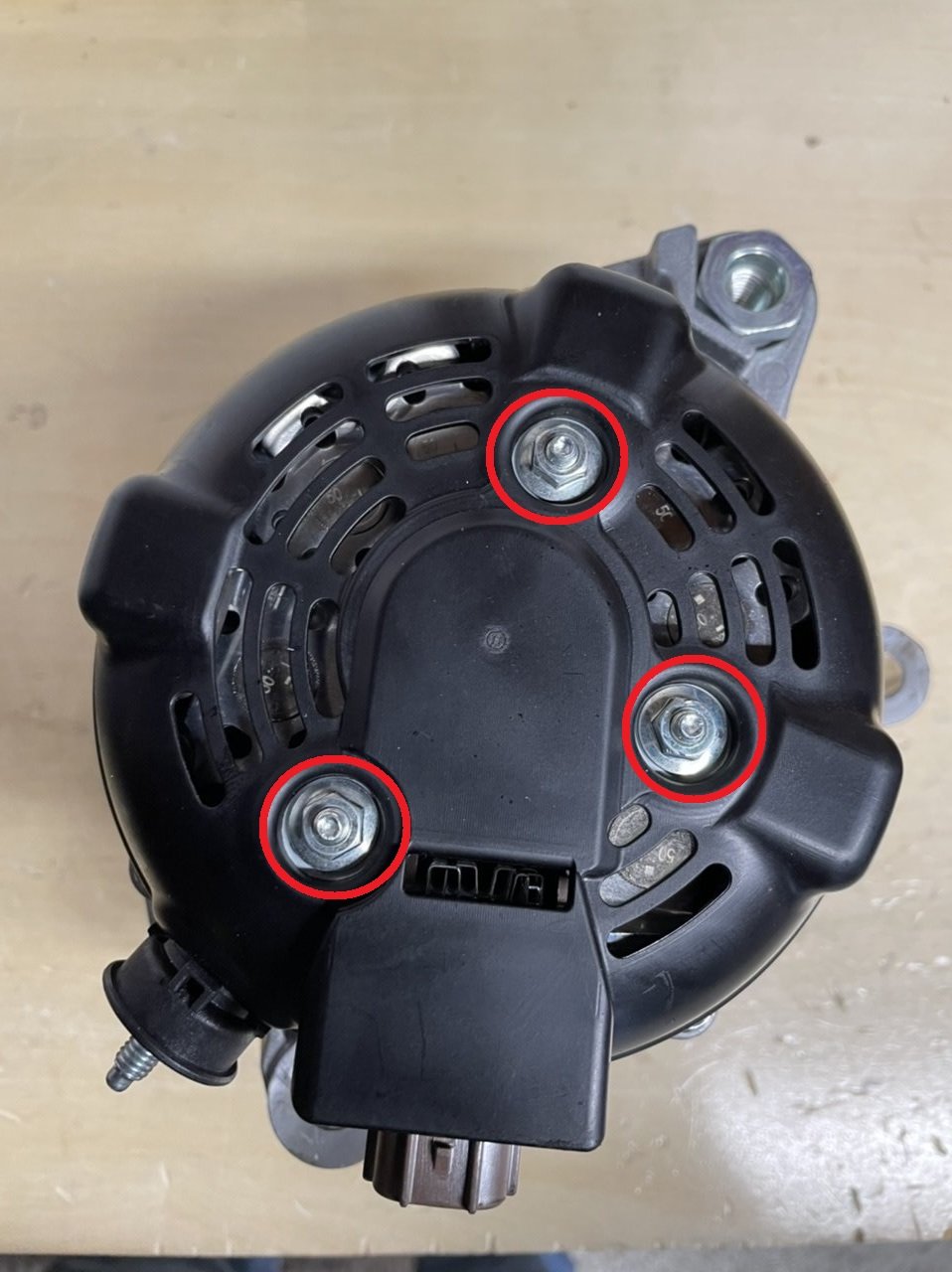

    To swap the regulator, first remove the three cover nuts and the plastic cover easily pops right off.

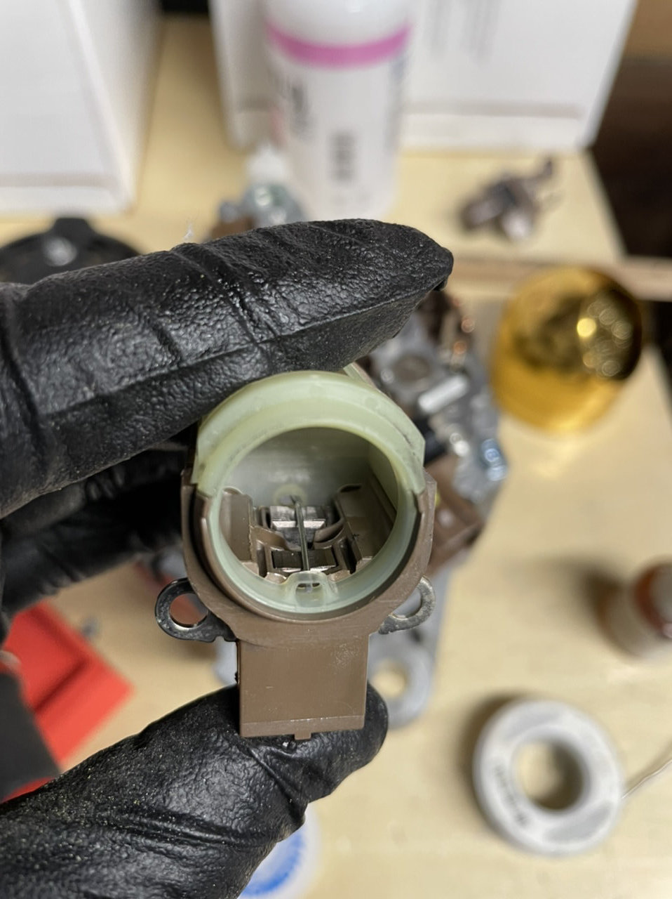

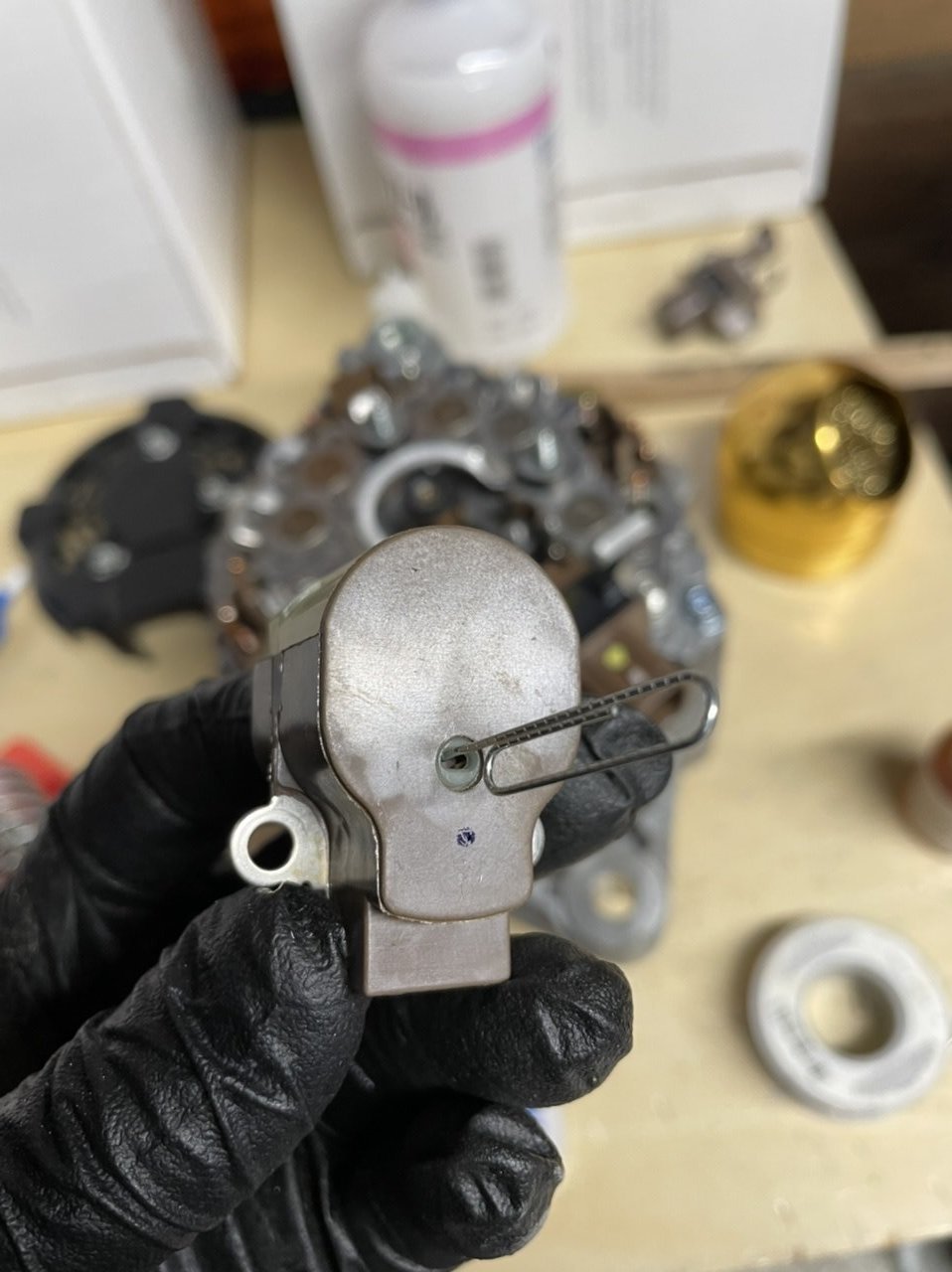

    Lift the brush assembly straight up. Straighten a paperclip and insert it to hold the brushes back for installation later.

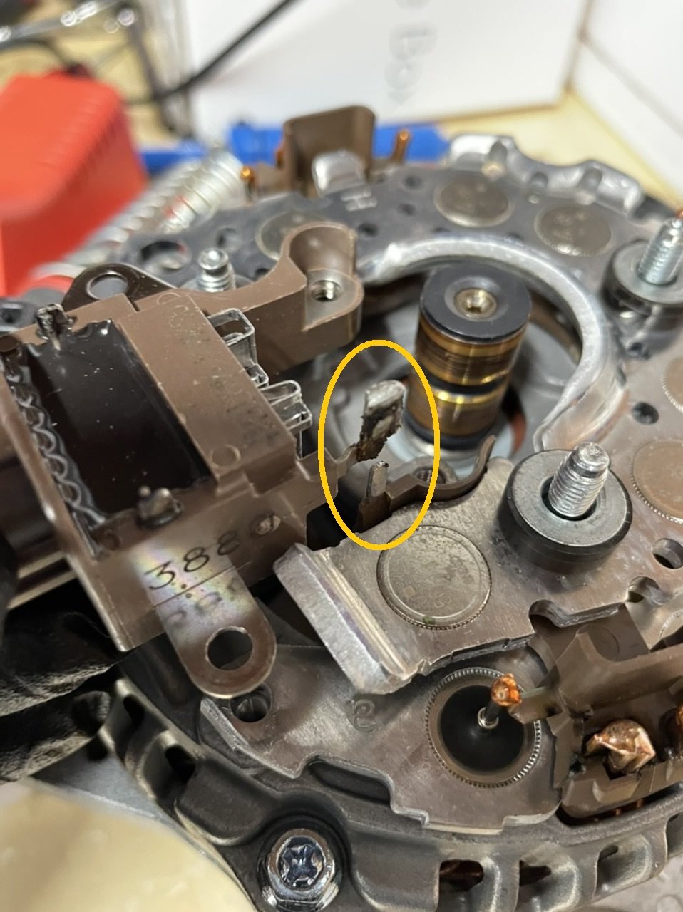

    Heat the solder on the regulator pin and once fluid lift the regulator up and off.

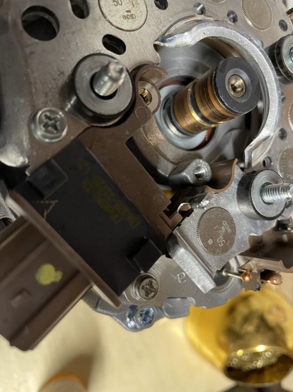

    Place the new regulator and screw into place, positioning the tab on the post.
    Crimp the tab to the post and solder.
    Drop the brush assembly into place, screw it down and pull the paper clip.
    Reinstall the cover and three nuts, that's it!

    Got me wondering, I changed to a red top optima last week in my 2004 Tacoma. All stock equipment.
    At a low idle (auto trans in drive), I am still reading 14.26 volts on my Fluke.
    I didn't have any electrical loads turned on other than the radio, so maybe that is the difference.
