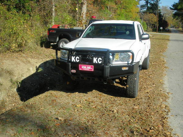

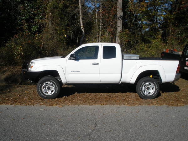

    This is my Taco [​IMG]

    As you can see the tires need some work

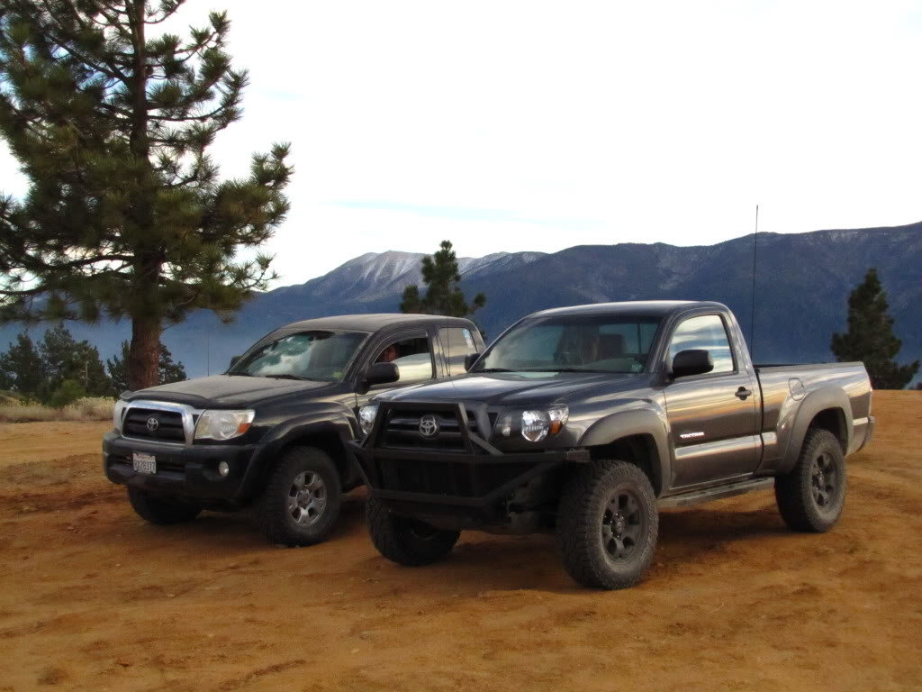

    im running 265/75R16s on TRD rims
    the stock 245/75R16s shouldnt be that close. Also, a 70series tire wont make a difference since that pertains to tire height not width. a 245/70 would be smaller diameter.
