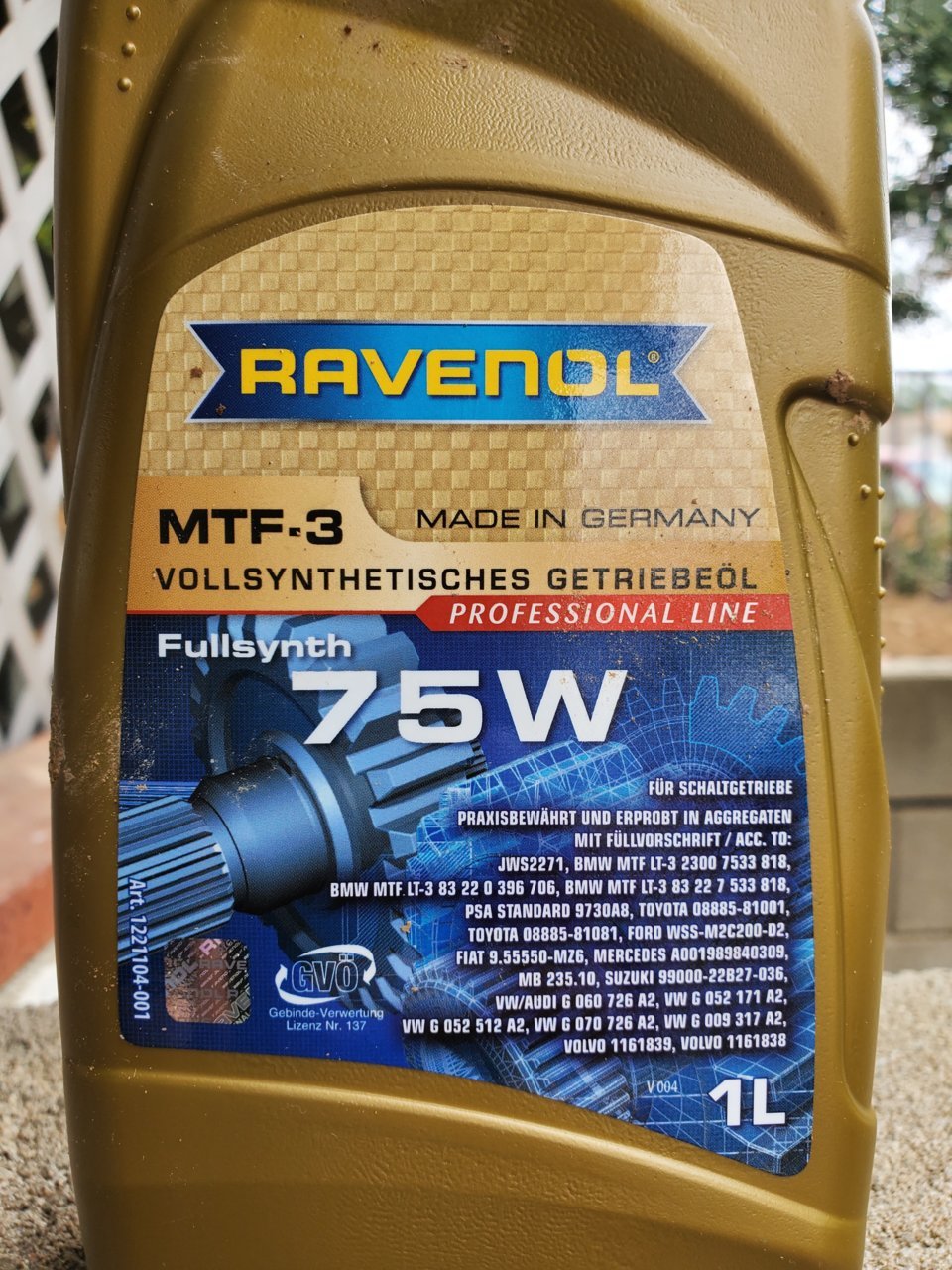

    I used 75 90 mobil 1 for front and rear and revanol 75 w for the transfer case

    How do you like the Ravenol 75? Any noticeable difference?

    That ravenol is the shit man. I'm a huge fan.

    I did 75w-85 ravenol for front and back, toyota super special golden 75w fluid for the transfercase.

    I replaced the transfer case fluid at 30k miles and while obviously I didn't send it out for an oil analysis or anything like that i think I could have waited until 60k before changing it
    But anyway with that being said I haven't noticed a difference so far, engages in 4hi and 4lo without any issues just like before.

    I'm glad I didnt because my dumbass forgot the crush washer on the drain bolt and didnt realize it until I torqued it down. I'm OCD so hell yeah I drained that shit out and replaced it. It sucks because you have to buy 2 bottles (it takes a full bottle and a tiny bit of the other so I just dumped the rest of the 2nd one) i think they were only $18 each but I would have shit my pants if I had to shell out $300 ($75 each for the Toyota OEM stuff x4)

    Yea my wife's GX also uses the fluid and my dealer sold it to me for $50 per so I went with what the book calls for, especially because she has a center diff, not a transfer case. There is a virgin oil analysis of the Toyota fluid floating around somewhere and there is no other equivalent fluid
    You only need 1 bottle of the Toyota fluid for our transfer case. Our transfer cases call for 1.1 QUARTS of fluid. Toyota sells the golden fluid in 1 L cans. 1 L is 1.05669 QUARTS.

    You’d be fine with the 1L Ravenol bottle. The TC calls for 1.1Qt which is 1.056L. I’m sure 1/25th of a Qt stays in the case.
