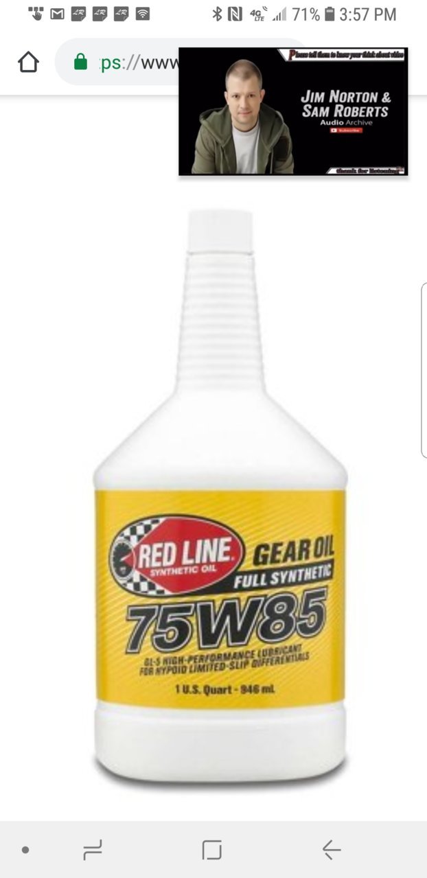

  9. Sep 18, 2018 at 12:18 PM
    TireFire
    TireFire Superunknown Member
    Feb 6, 2016
    #177349
    7,666
    Olympic Peninsula
    It's not better it's cheaper and you're not gonna see a benefit from going synthetic in the diffs! So anything but Dino is a waste of money.
    I do 80w90 in front and t-case and 85w140 in the rear because I tow and off-road!
    Whatever you do don't get that overpriced watery redline crap.
    Also, yay, daily oil thread

    I run this: find it online

    Was just going to say Redline, you can use 75W90. The 75W85 is for CAFE fuel economy standards.
