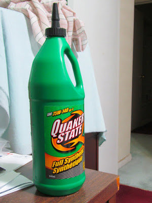

    Because Toyota adds 300% markup, then the dealer adds 35% on top of that...
    For Canadians:
    http://www.amazon.ca/Lucas-Oil-10121-Transmission-Differential/dp/B000BCKWVE/
    http://www.amazon.ca/Lucas-10122-140-Synthetic-Gear/dp/B000IG7PMM/ Lol it looks like a bleach bottle.
