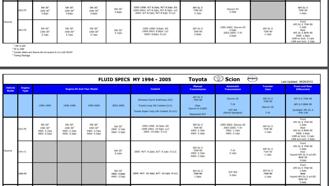

  9. Mar 19, 2023 at 8:21 PM
    Area51Runner
    Area51Runner Well-Known Member
    Jun 26, 2014
    #132748
    11,775
    Northern California, Bay Area
    02 3.4 DC TRD PreRunner 4WD SWAP
    Bivouac likes this.

  11. Mar 19, 2023 at 9:05 PM
    ricog101
    ricog101 [OP] Active Member
    Nov 1, 2017
    #234757
    33
    Pacific NW
    2001 Xtracab 2.7l 4wd Auto (3RZFE Engine)
    Hiatus Camper OME Complete Lift Kit (~1.75") LED projector headlights Maxxis Razr AT-811 265/70R16
    Thanks so much for posting that table. Do you know why they call for 75W-90 for the front diff and t-case, but 80W-90 at the rear diff? I know I'm probably splitting hairs here, but just very curious.
    Area51Runner[QUOTED] likes this.
  12. Mar 19, 2023 at 10:31 PM
    Area51Runner
    Jun 26, 2014
    #132748
    11,775
    I don't but it's toyota, if they say it works then good enough for me. :thumbsup:
    Nessal likes this.
  13. Mar 19, 2023 at 11:18 PM
    Nessal
    Nessal Well-Known Member
    Dec 30, 2012
    #94081
    1,425
    Texas/Bay Area
    2003 V6 4X4 TRD DCAB
    I use 80w90 in the rear diff as instructed by Toyota and 75w90 everywhere else. Everyone has their preference but I stick with the book.
