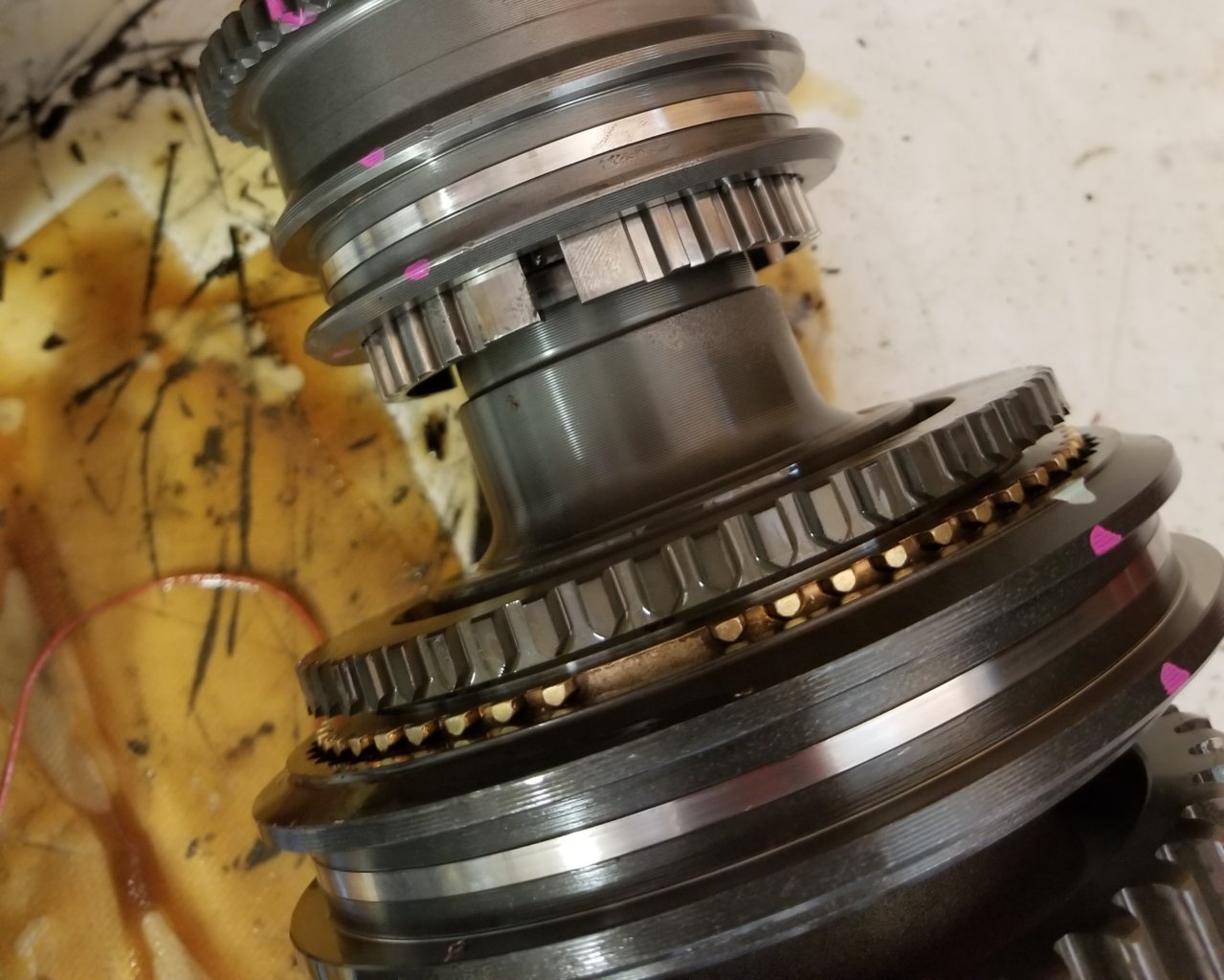

    Are you looking for the specific metal in the synchro or just that it contains one?

    All of it...lol.
    I was pretty sure the transfer synchro was, but wanted confirmation.
    It's my understanding, GL-5 with active phosphorus, doesn't just start eating up yellow metal through chemical degradation, just from contact. It will bind to yellow metal and requires pressure and heat to physically corrode it. This would be more of a concern in a manual transmission than a part-time transfer case. Some GL-5s claim inactive or buffered phosphorus and are yellow metal safe...
    I prefer to err on the side of caution and just use the OEM LF fluid. I would consider Redline MT-LV if I could find a VOA and get a look at the additive package.
