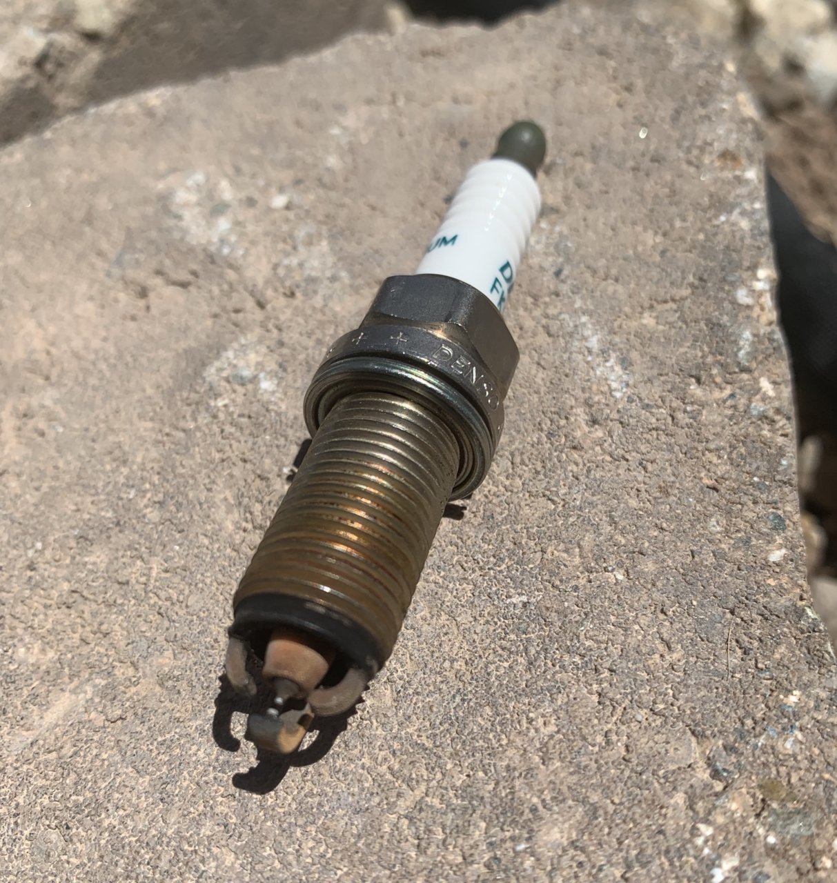

    You are the first person I've heard of that actually checked gap.
    It's usually, "plugs looked good..."
    Skydvrr likes this.

    Justin
    Southern California
    18 TRD Off Road 4x4
    U did plugs right on time. 60k miles is recommended interval

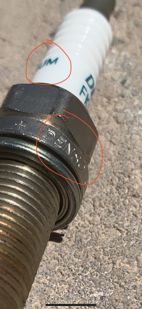

    Thank you, I didn't see the iridium on the plug.

    2020 OR DCSB AT 4WD
    Don't use anti-seize on plugs, multiple manufacturers state this. They come plated with zinc for that purpose.
    zoo truck[QUOTED] likes this.

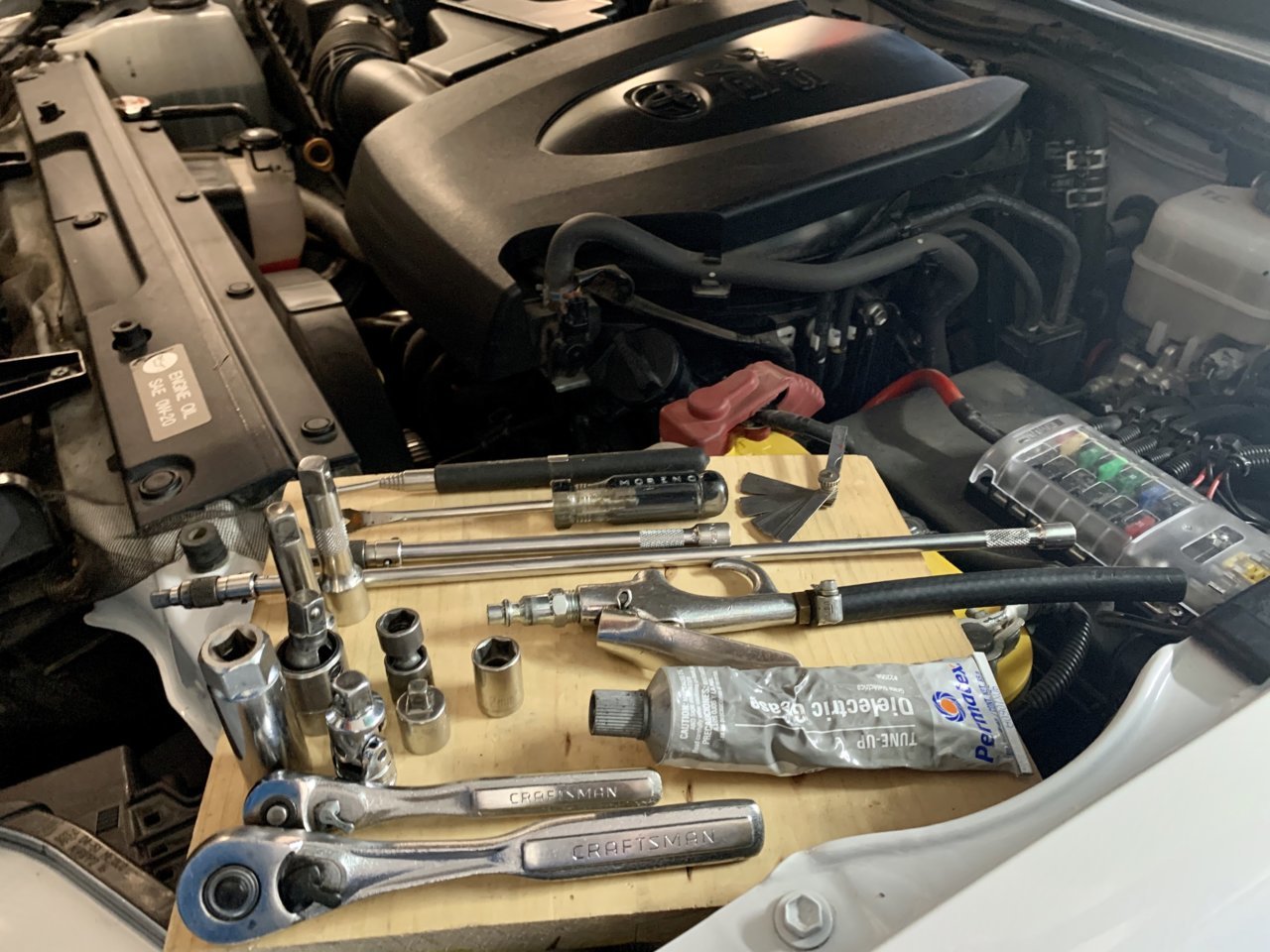

    These are the tools I used on the Tacoma plug change. Basic tools, 3/8 and 1/4 ratchets, extensions and swivel 10mm socket, spark plug socket. The swivels help you snake into the tight spots. The magnet I use in case you drop a bolt, air blow gun to blow out any debris from spark plug hole before you pull the plugs, small pry tool to unclip the coil connectors, plug gap checker just to make sure gap is within specs, dielectric grease for the coil boots. I didn’t show it but you need a mechanics mirror to look into the spark plug hole to verify no debris is in the plug hole!
    There are a couple of intake brackets that I recommend taking off. For that you go through the fender well using a 12mm socket/swivel and extension.
    I’ve been working on cars since the 90’s, let me know if you guys have any questions. The plug removal in these trucks are not bad at all if you have
    the right tools.
    MECtacoOR and eurowner like this.

    Iridium/Platinum plugs I've used warn not to gap them because it can scrape off the plating.
  20. Apr 26, 2020 at 4:41 PM
    #40
    splitbolt
    splitbolt Voodoo Witch Doctor
    Mar 7, 2010
    #32761
    7,858
    NW Arkansas
    2016 TRD OFFROAD DCSB MGM
    Check gap or adjust gap?
    Checking gap is fine...unless you're a ham-fisted brute.
    Adjusting gap? Yeah...that's a no-no.
