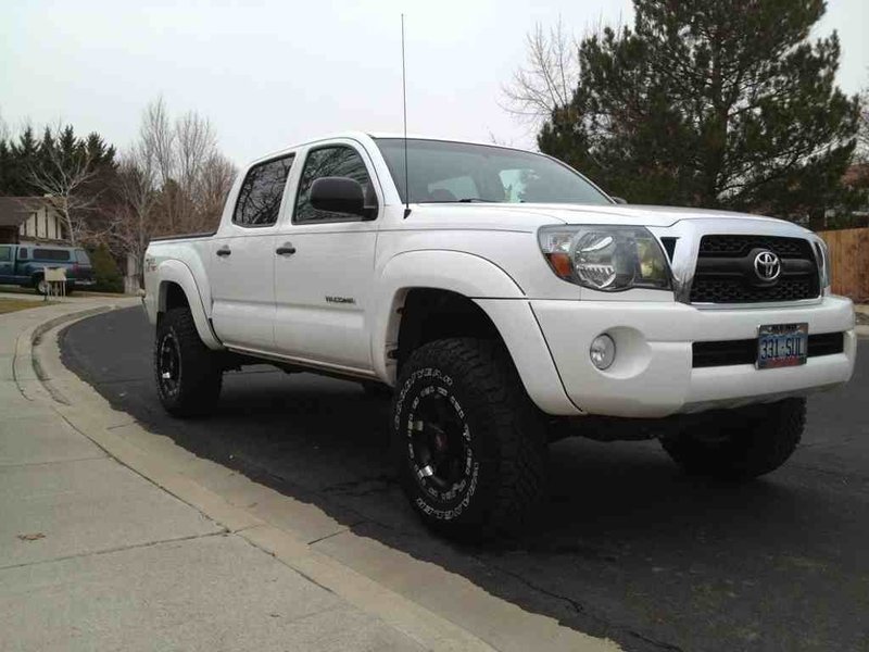

    Nice what lift??

    !.5" Wheelers AAL in the rear with 5100's, and 885 OME coils with 5100's set at .85. Sooo stoked! Now i just need to get it aligned.

    Looks good.

    Truck looks good man!

    Looks awesome!
    how much lift did you get? and let us know how the alignment goes. you gotta be at like 3-3.5" with a pre-runner with 885's and 0.85 on Billys.

    Yeah front is about 3.5", rear was 1.5". The alignment went ok, could still use a bit more caster. I see some new uca's in my future. Lol

    I'm running 265/75/16, and with the new lift I just put on it sits perfect, with no rubbing.

    haha figured as much, but im sure youre happy with how it looks. I have the same stance, except i'm 1.5" lower on front and back. I think a level truck looks sweet.
