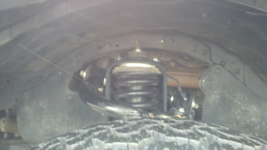

  15. Dec 18, 2012 at 7:07 PM

    Here you can see a "preload" spacer with a top plate spacer.

  17. Dec 18, 2012 at 7:10 PM

  18. Dec 18, 2012 at 7:13 PM
    #458
    92LandCruiser
    92LandCruiser Well-Known Member
    Feb 20, 2010
    #31761
    8,324
    Nevada
    80 series Land Cruiser
    Cummins, tons, 40s
    Not necessarily. Not much different than my set up. I have a higher rate/longer spring and a top plate. He has a spacer inside the coil and a top plate. As long as the coil doesn't bottom out on itself it'll be fine.
  19. Dec 18, 2012 at 7:16 PM

  20. Dec 18, 2012 at 7:21 PM
