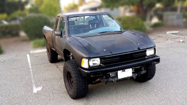

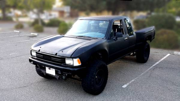

    Good to get a thread like this going with someone willing to help others out. I'm still searching for my crappy gas mileage fix. New plugs, wires, air filter, fuel filter, timing is set at factory specs, maf sensor (brain fart on the name for our set up, I know its not maf) works well, no vacuum leaks, brake booster seems to be ok, idle is correct, tps was just replaced, not sure what else to check anymore.
    But it could be that this thing has different gearing than stock as it is way too peppy in 1, 2, 3, and 4 with 33s on the street. Swapped in a diff from a donor truck awhile ago, didn't check the gearing.

    at first i thought it was an RC truck lol
    the CL post was flagged for removal
    I have never been around the prerunner type trucks since i am from the midwest.. But it would be fun if i lived somewhere that i could use it

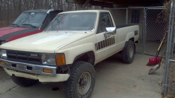

    just uploaded a pic of my old mans 81 "big red"
    its been a long debate between my sister and I as to who gets it.
