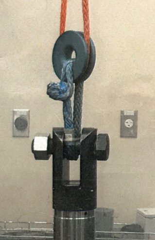

    Just got back the testing results for the pull test on my pulleys. The soft shackles broke at the knot at about 40,000 lbs with no deformation of the pulley itself.

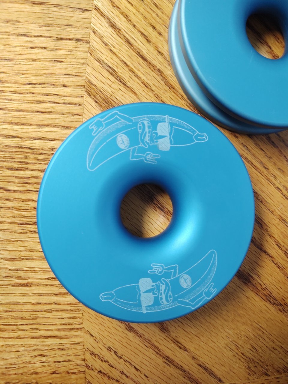

    Made a custom engraved recovery ring for someone....hit me up if your interested in some custom engraved quality recovery gear.

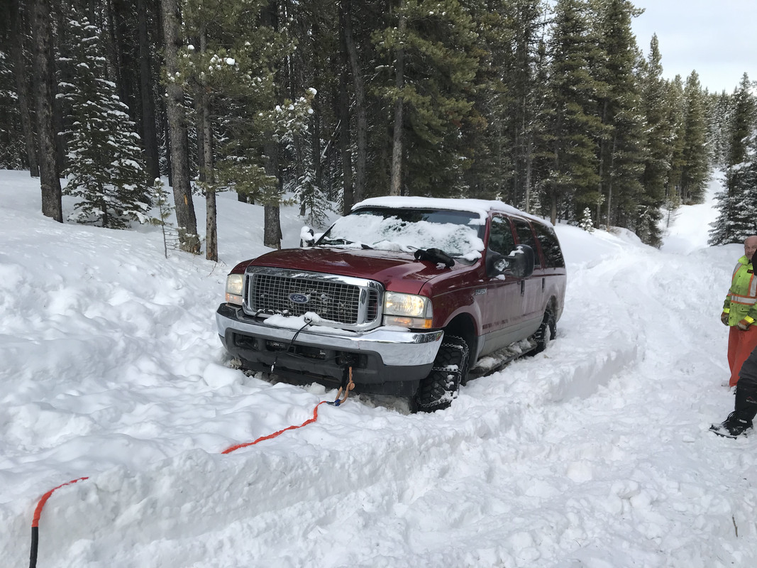

    Doing a single line pull on this excursion, I broke my winch line before he moved.
    Should’ve run a two part from the get go. With the two part line setup. I was barely able to break him loose. Almost had to run a 3 part. This thing is heavy and was frozen in. I had tied myself off to a tree as well
    https://youtu.be/CDHEnfDWyTg

    Jeebus that thing was stuck! I think one of the biggest benefits of the double line pull is being able to recover a vehicle much bigger than yours, as you have demonstrated. Thanks for sharing that, Archimedes would be proud!
