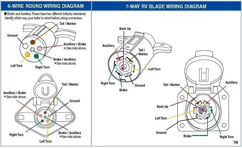

  6. Sep 23, 2014 at 5:03 PM
    RND2
    RND2 Well-Known Member
    Apr 20, 2014
    #128082
    276
    In my head swimming around
    12 DCSB
    RCD 4"

    Thanks rnd2 that helps. As for the draw on the system it's a 18amp pump on a 30amp fused system. So as long as my wife doesn't take the truck tomorrow I can play around with it.

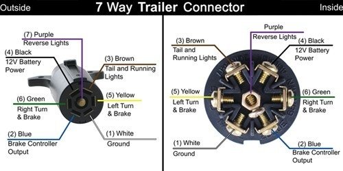

    I used these for a similar project
    aff607312706a026268f262e5ba2b2b3_3ab15c80dd81c4e7e575ec6d493b78e5c722a220.jpg3397737cf63b302b7920d6dc95c7a2f1_1f942b053ef91fb44edd989be4232d43258756c1.jpg

    Interesting, I didn't realize there was a constant hot on that connector. Do each of the lights go hot or to ground when they are active? I think they go hot, so if so, what would one need the 12v+ on that connector for except to power a compressor?

    for charging batteries on the trailer.
