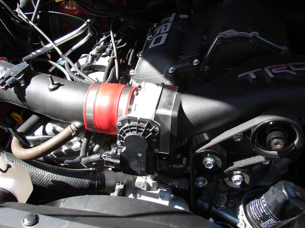

    I'm not sure how it installs on the prev gen tacos, but on the TRD S/C for the 4.0L it is placed just behind the throttle body and controlled by a piggy back ecu (APR X-1). So you can have it firing whenever you would like. :thumbsup:
