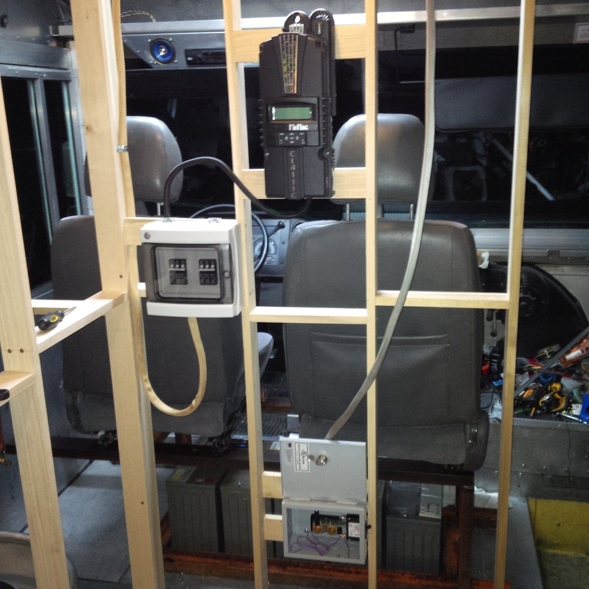

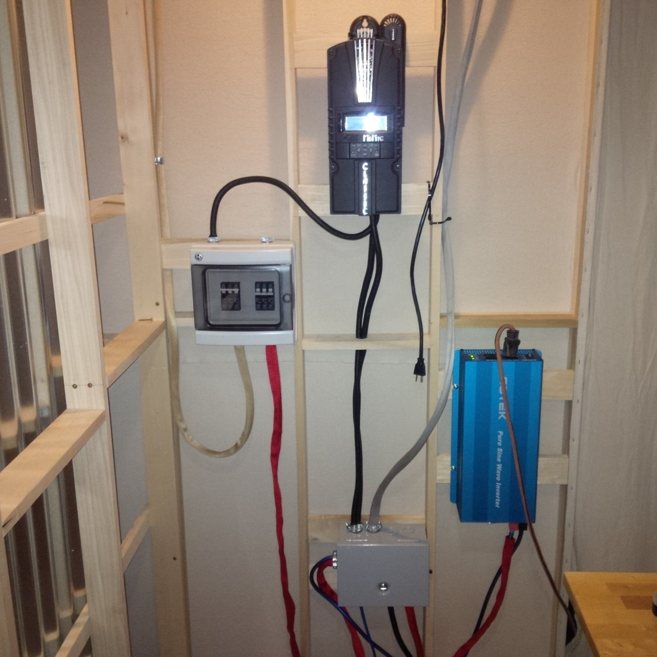

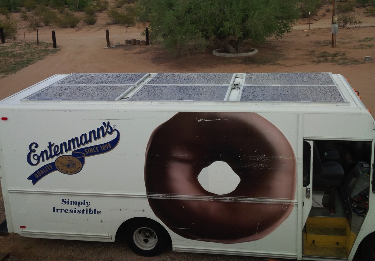

    Figured I would add these to show the solar setup I had on my last conversion:
    Here are my solar panels, I think they're 230 each, total of 1,340 watts.
    This is my inverter, breakers, shunt, charge controller and so on.
    This is my battery bank, I had to fabricate the seat mounting to fit two Honda Passport seats and mount the five AGM batteries under it securly.
