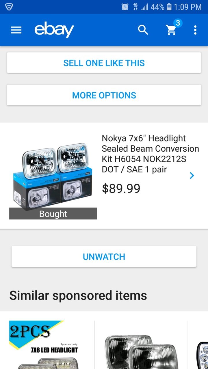

    Yeah glass is better for sure. Plastics tend to degrade/yellow/haze over the years. (Still haven't asked my brother how his are holding up).
    Ahhhhhh bummer.. Moment's too late it looks like. "Bought". But are the metal housings any easier to work with for hacking?

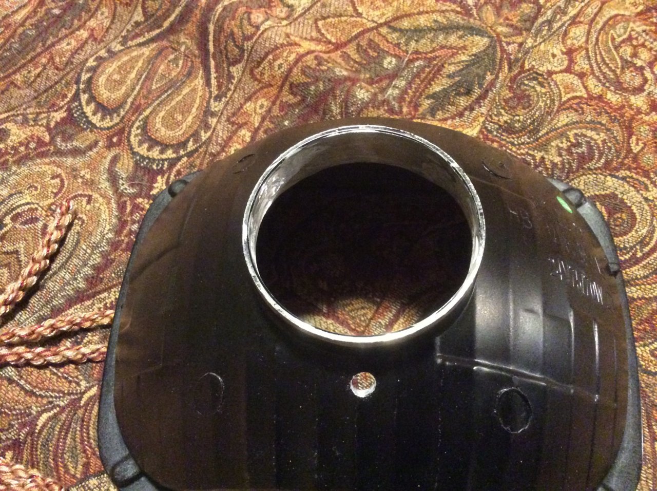

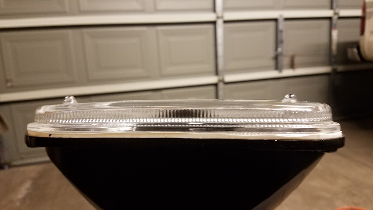

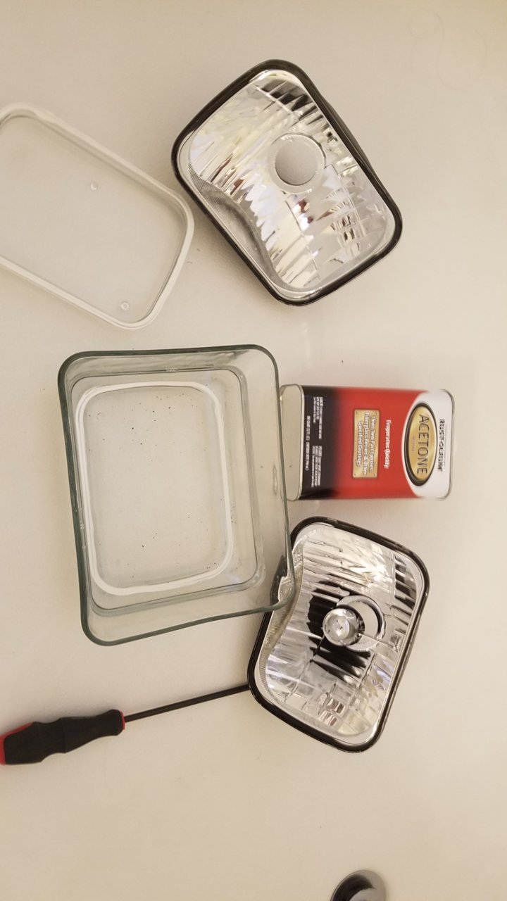

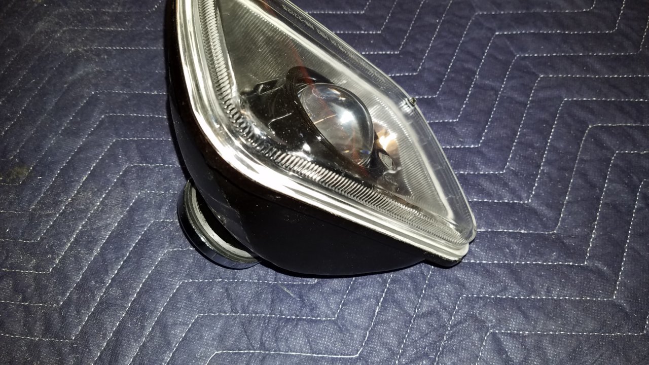

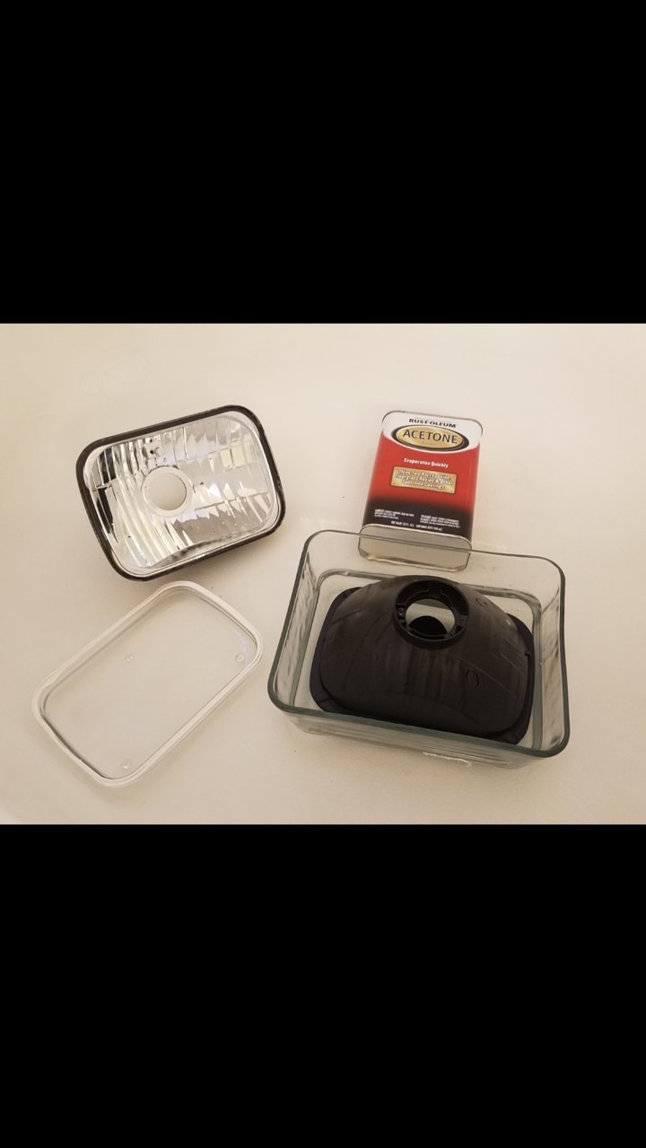

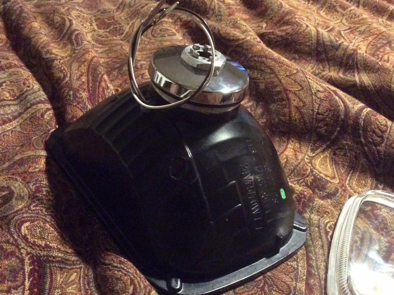

    The process has begun,
    I decided I want the glass lens and aluminium brackets,
    I know the metal buckets will be harder to modify over plastic but I'm wanting metal and glass lens quality
    1st step was to get a quart of acetone
    and filled the inside and the lower part of theens over night in the acetone and the glass literally falls right out of the bucket.
    Step one is done,
    Now to cut out.the fat in the round bulb section next.

    Nice work. I was wondering how one would get the lenses off of those. I have never had much luck with them.
  16. Dec 13, 2019 at 8:07 AM
    #36
    1997tacomav6
    1997tacomav6 V6 5sp,RegCab,TVS1320 Supercharger,Haltech, 800k
    Oct 5, 2013
    #113940
    10,391
    John
    Denver
    97 reg cab, v6 5sp 300hp supercharged, Methonal Injection, 800,001 plus miles, Original Owner
    V6 5sp,RegCab,TVS1320 Supercharger, 56mm pulley, methanol injected Haltech ECU, AC Tvs1320 supercharger,(MUST DO) every 125,000- 150,000 needs rebuild Projector headlights HID 5 speed manual Amsoil for all drive train Smaller 56mm custom pulley, (MUST DO) 2004 DESNO fuel injectors, zero ping ping, 2004 side door mirrors Dick Cepek Rims, Michelin tires LTX, ATM Pathfinders Dynopro ATM ( that last 100,000 miles) Now running Dynopro ATM mud and snow tires KN cold air intake Cat back dual exhaust with ss exhaust tip, Raised exhaust tail pipe to 2" below body line Optima*dry cell battery,red top Alpine sirius radio, 200 watt amp, focal is165 split door pod speakers Focal door speakers Subwoffer behind seat Viper alarm, Electric Locks Dark tinted windows, bucket seats corbeau lg1 Tacoma Rubber floor mats TRD fender extenders, Bilstien shocks, King shocks JBA UCA trailer iv hitch, electric brake control, Drilled slotted brakes, High carbon steel (MUST DO) EBS green stuff 7000 series pads(MUST DO) TRD engine oil cap TRD stick shift, Marlin crawl shift kit. Rear sliding window 2002 4Runner functional hood scoop cut into Tacoma hood, 4Runner dual overhead map light Gentex Auto dim + Compass + Temp, garage,rearview mirror Snow Methonal kit stage 2 Custom 3 core aluminum radiator Linex bed liner Haltech stand alone ECU, Intake supercharger gauge. Stainless steel brake lines, Custom leather wrapped steering wheel, Haltech stand-alone ECU,
    Acetone doesn't hurt the paint and the glass lens seal completely lets loose, so simply.
    I had some acetone and decided to try it.
    One lens literally fell out when I picked up the bucket and the other lens needed a small push from the inside of the bucket with a screw driver.
    Bingo
    burntkat[QUOTED] likes this.

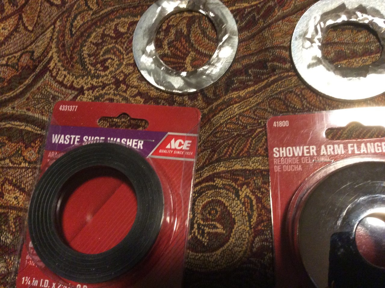

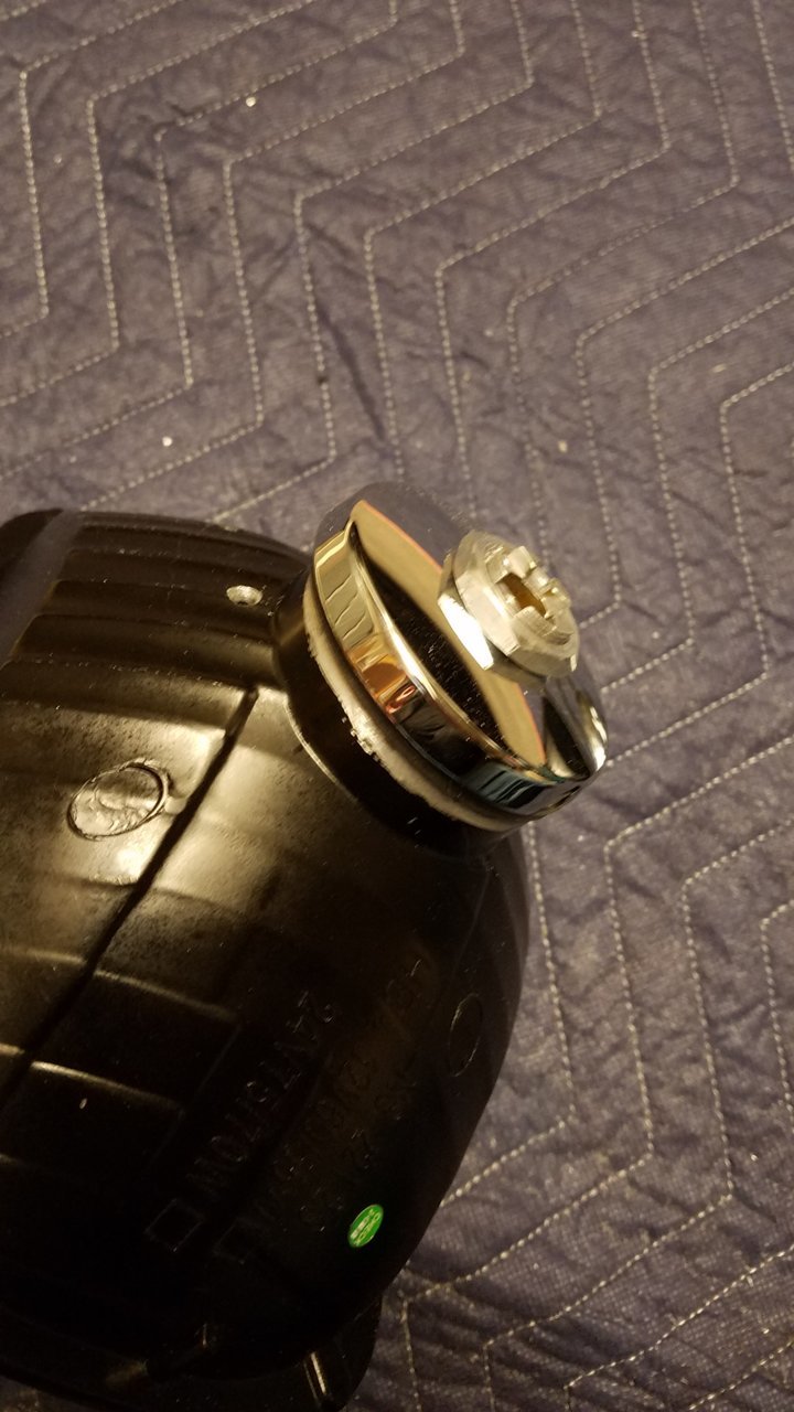

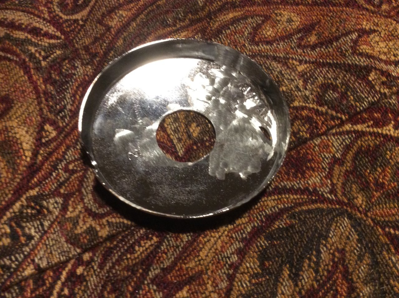

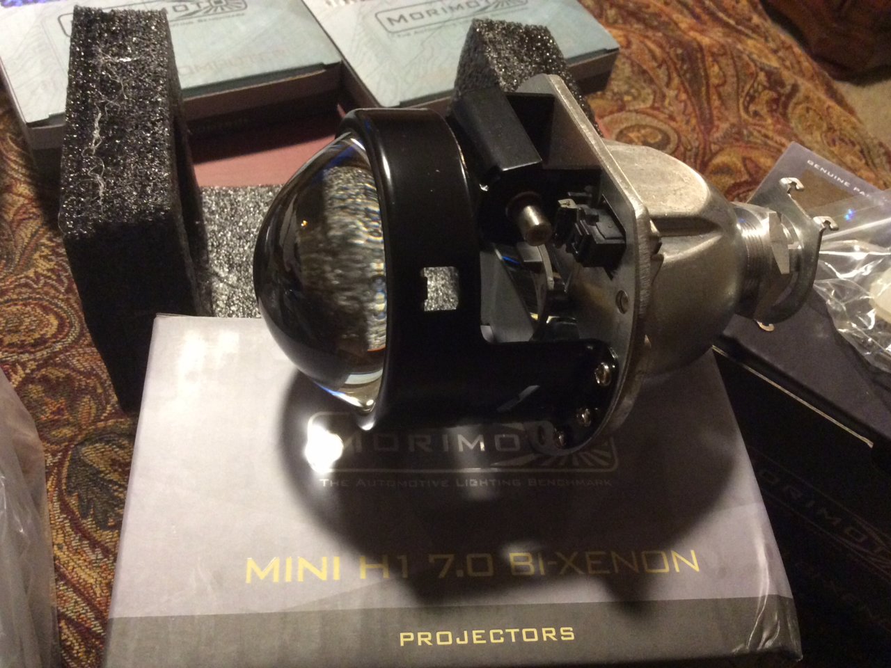

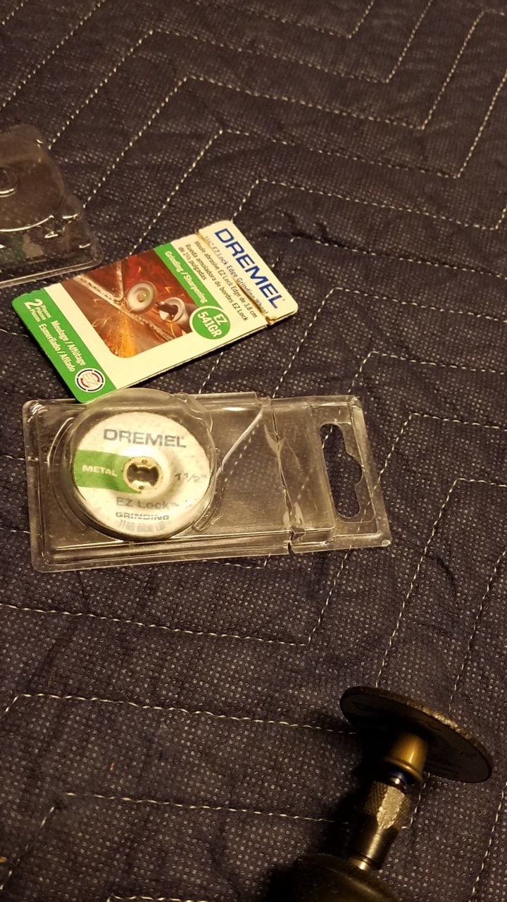

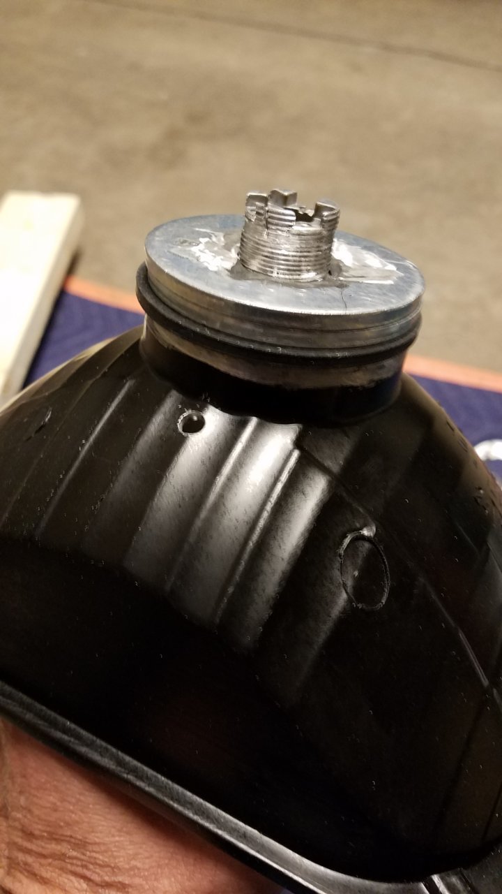

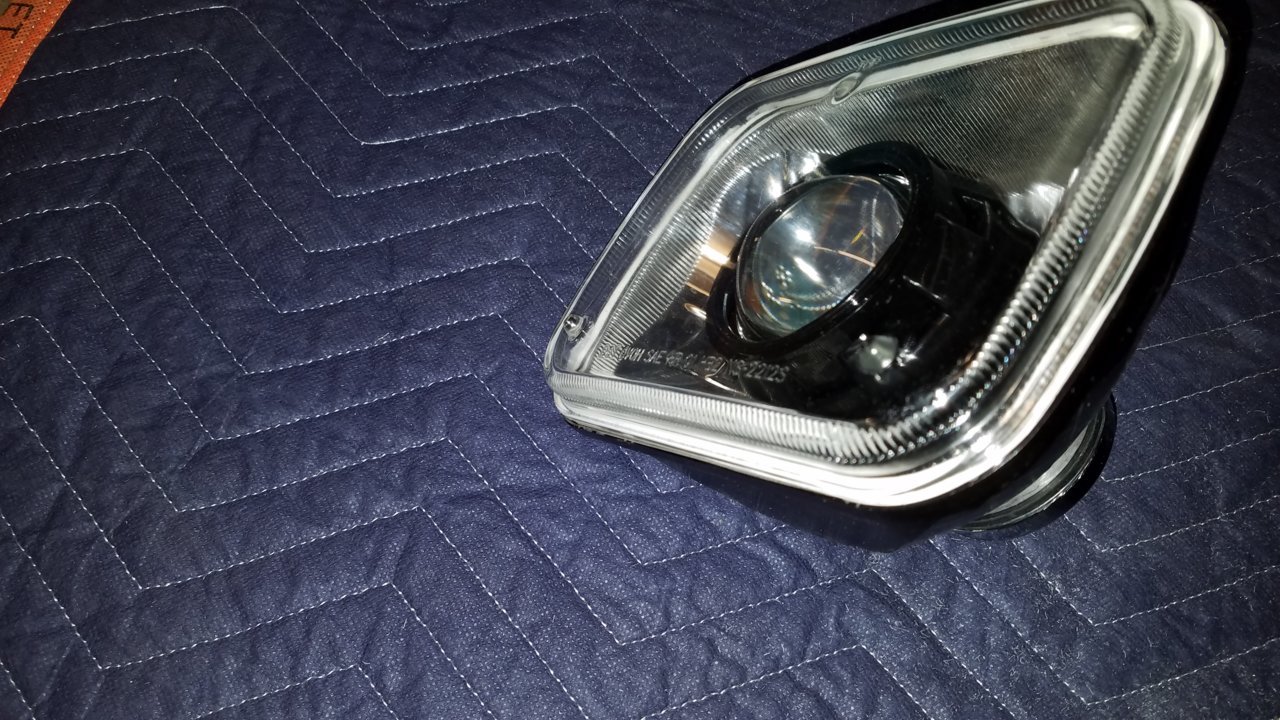

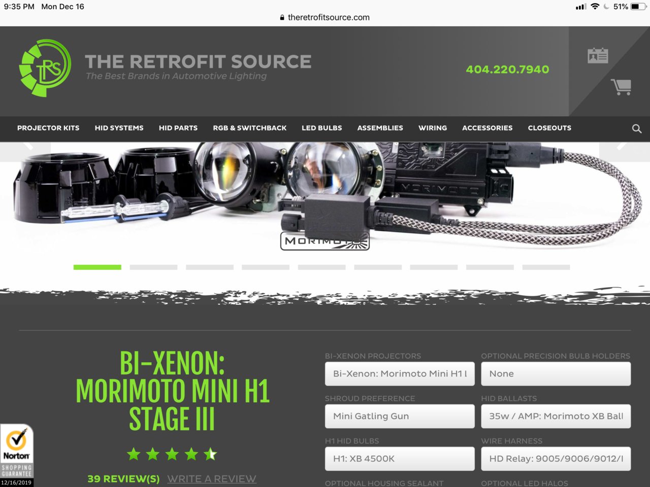

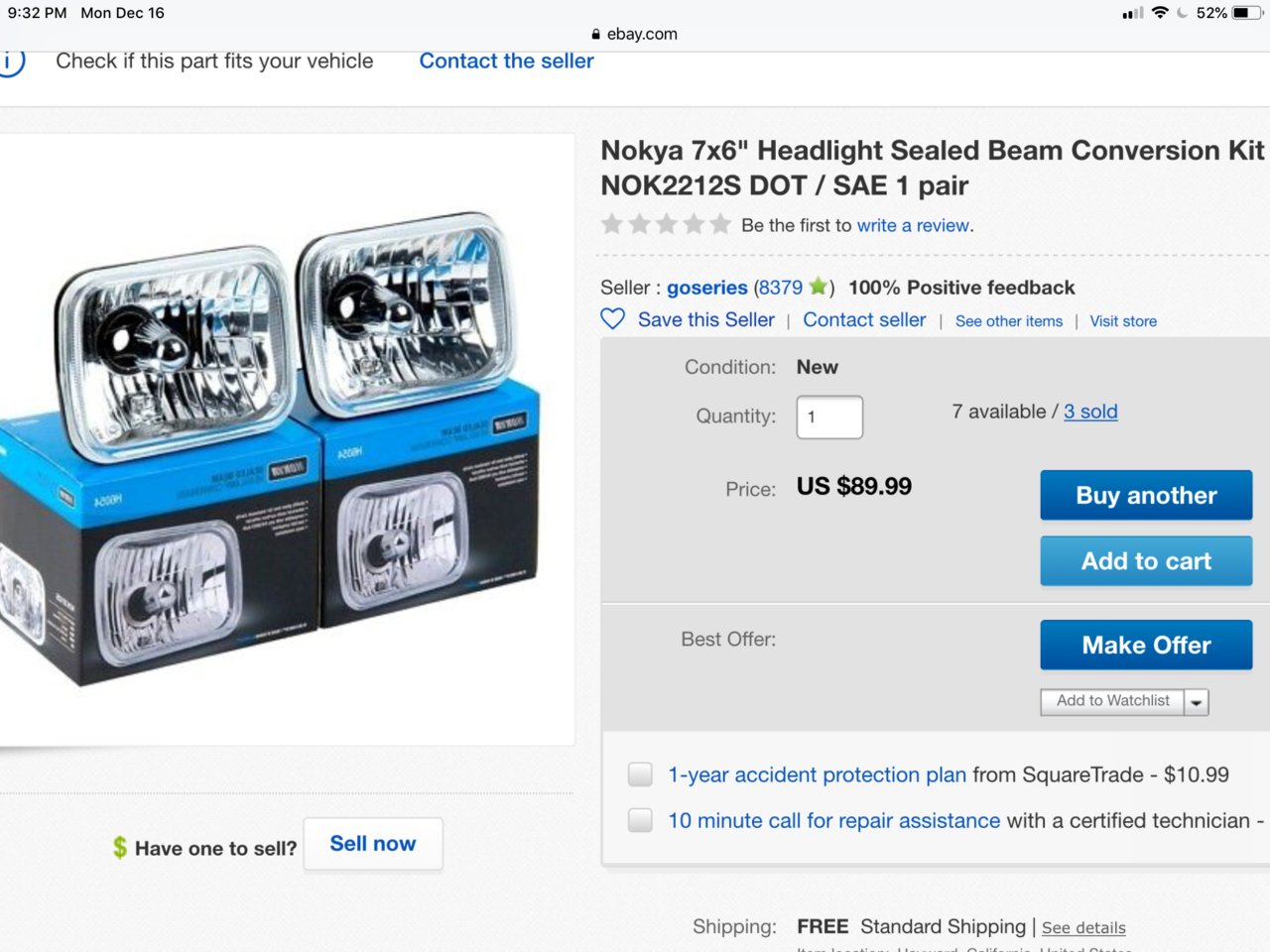

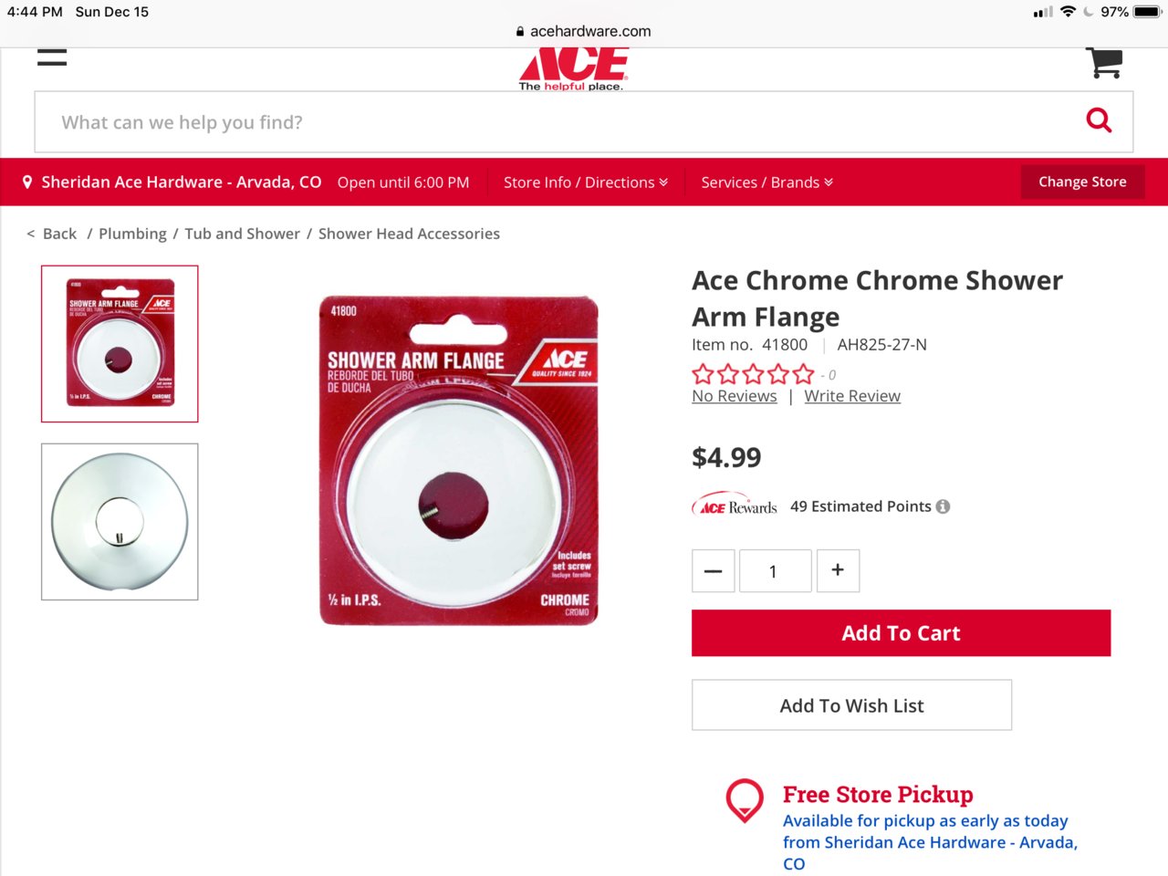

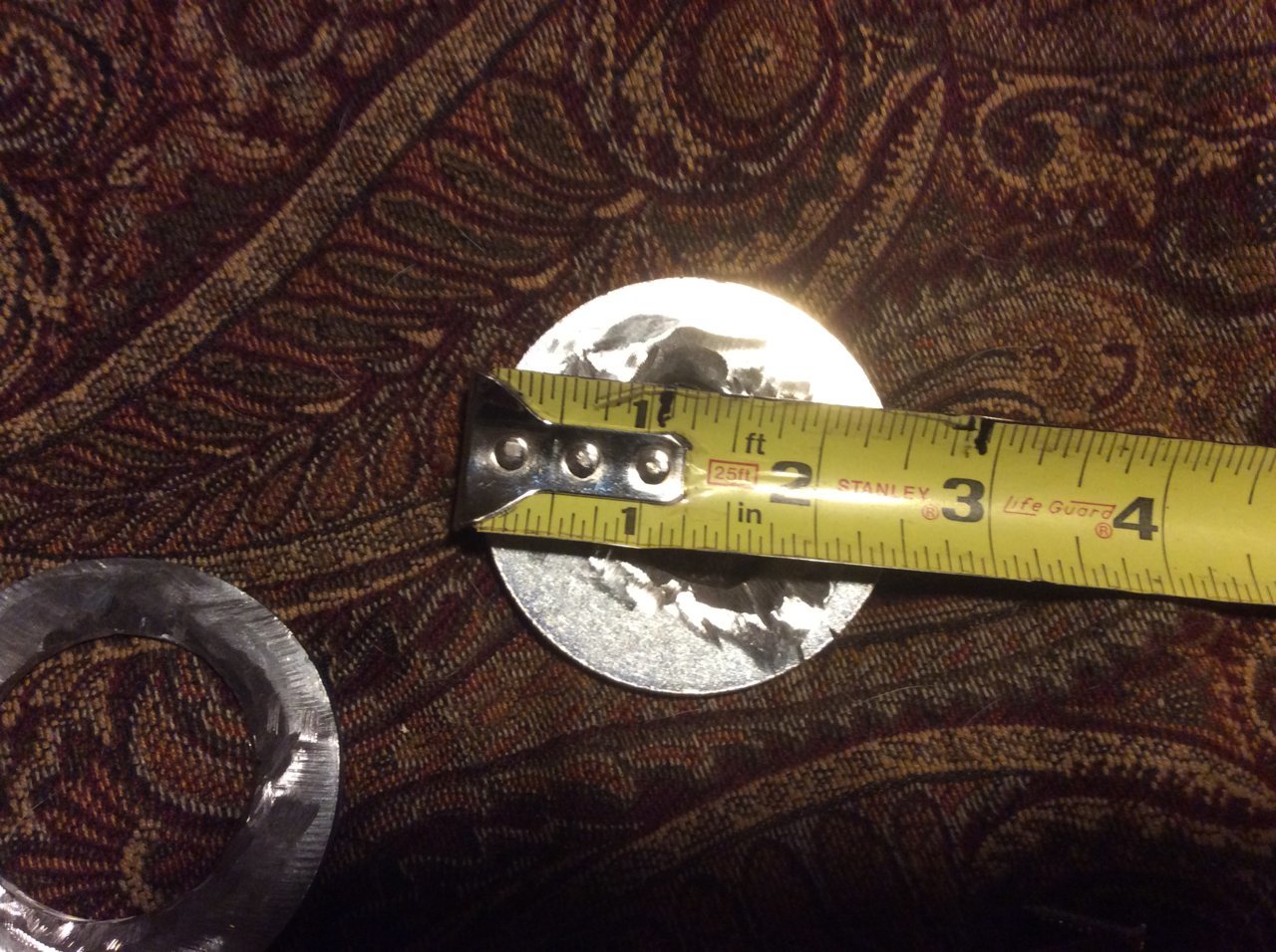

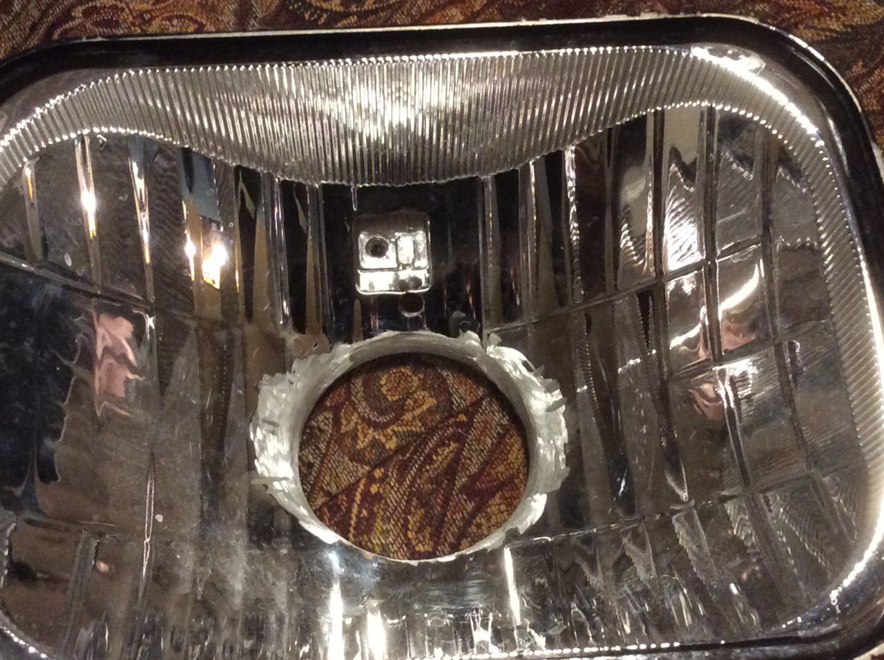

    So I got all my parts and tools needed.
    Here is my setup with glass and metal buckets
    https://www.tacomaworld.com/threads...on-morimoto-mini-h1-7-0.643068/#post-22251039
    If you have an air tank compressor with a air grinder this will go a lot faster
    Dremel
    Dremel grinding wheel, NOT cutting wheel.
    Four 2.5” THICK 1/16 steel washers that will need to be ground out in the centers
    Two shower flange covers, these are very thick and need the back metal supports ground off.
    Two rubber tub seals
    Two glass with thick aluminum buckets, either Nokya/Rampage H6054 will work.
    You will be able to install these completely without the projector hitting the glass lens, but it will be tight.
    In order for this to happen the thick steel 2.5” washers with the rubber gasket are needed because the bucket back flange needs to be a bit deeper to hold the projector tight and get the added depth for the glass lens to not hit the projector.
    The 1st 2.5 washer needs to be trimmed extra wide inside to allow the back of the projector to come through.
    If you get thin washers you will have to stack them to get the added depth.
    You probably could use layers of thick plexiglass and would be a lot easier.
    The advantage to not cutting the bucket up is with the structural support of the metal bucket and metal
    washers the projector will line up true to the bucket inside and not be pointed in a different direction.
    The round back INSIDE of the housing has to be all trimmed out round.
    The inside of the lens where the projector hits will need to be ground down for that extra 1/16 “ for the glass lens to clear. The projector is not perfect rounds,
    So the EAST and WEST sides need to be ground in particular.
    The bucket metal is very thick and needs a lot of grinding.
    Go slow and try the different options as how much needs to be ground from the washers to the lens
    lip where the projector hits.
    This will end up being a super high quality setup now.
    If you get a bread pan glass and set the lights in upside down and put acetone inside the lens
    and in the pan, the lens will fall out from overnight or maybe a little push from the inside. Don’t let it fall and break tho.

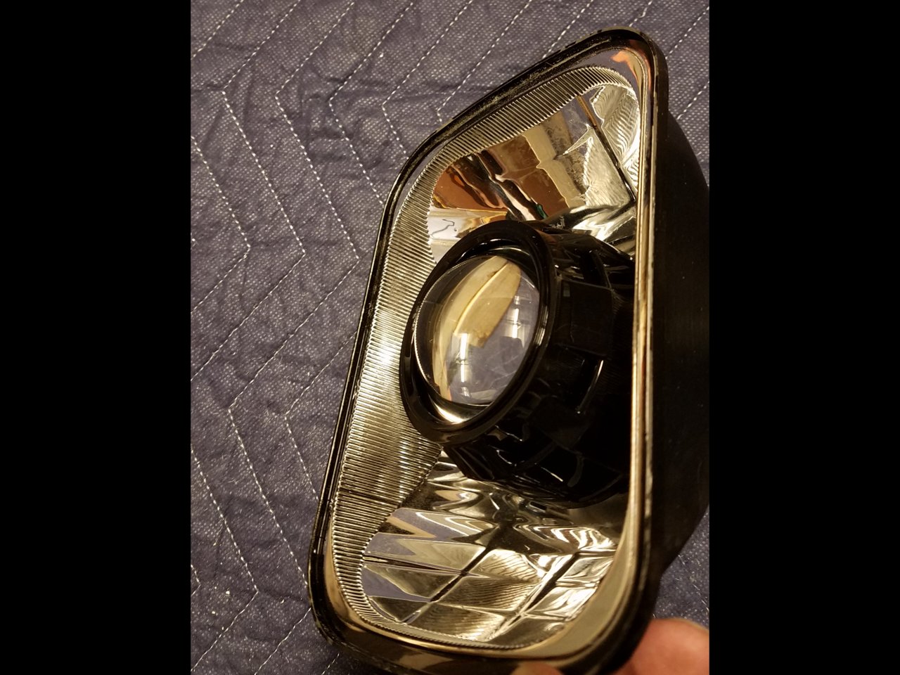

    Well got them all wired in and installed them today.
    So my problem is I went to align the lens and I’m seeing that they are not solid in the housing assembly.
    They have a little play in them, if I grab the lens it will move if I twist them.
    If I put a thicker layer of Butyl, will that help?
    Or maybe I need to wrap the outside seam between the glass and housing to maybe get them tight?
    Did your have play between the lens in the housing assembly ?
    With the play there you can’t align the beams,
    And one of the high beam solenoids quite working almost immediately
    So I have to get another replacement for that.
