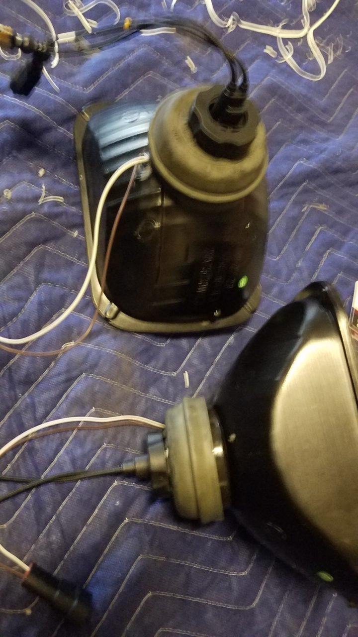

    Im pretty sure the issue is the wire connector socket on the solenoid.
    Did not bake the seal, I think I just need more build up in between the Glass lens and the metal housing

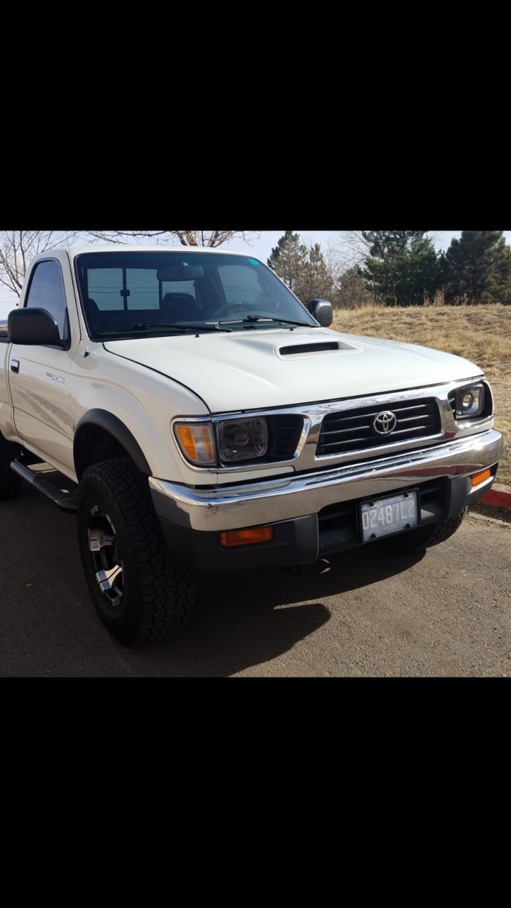

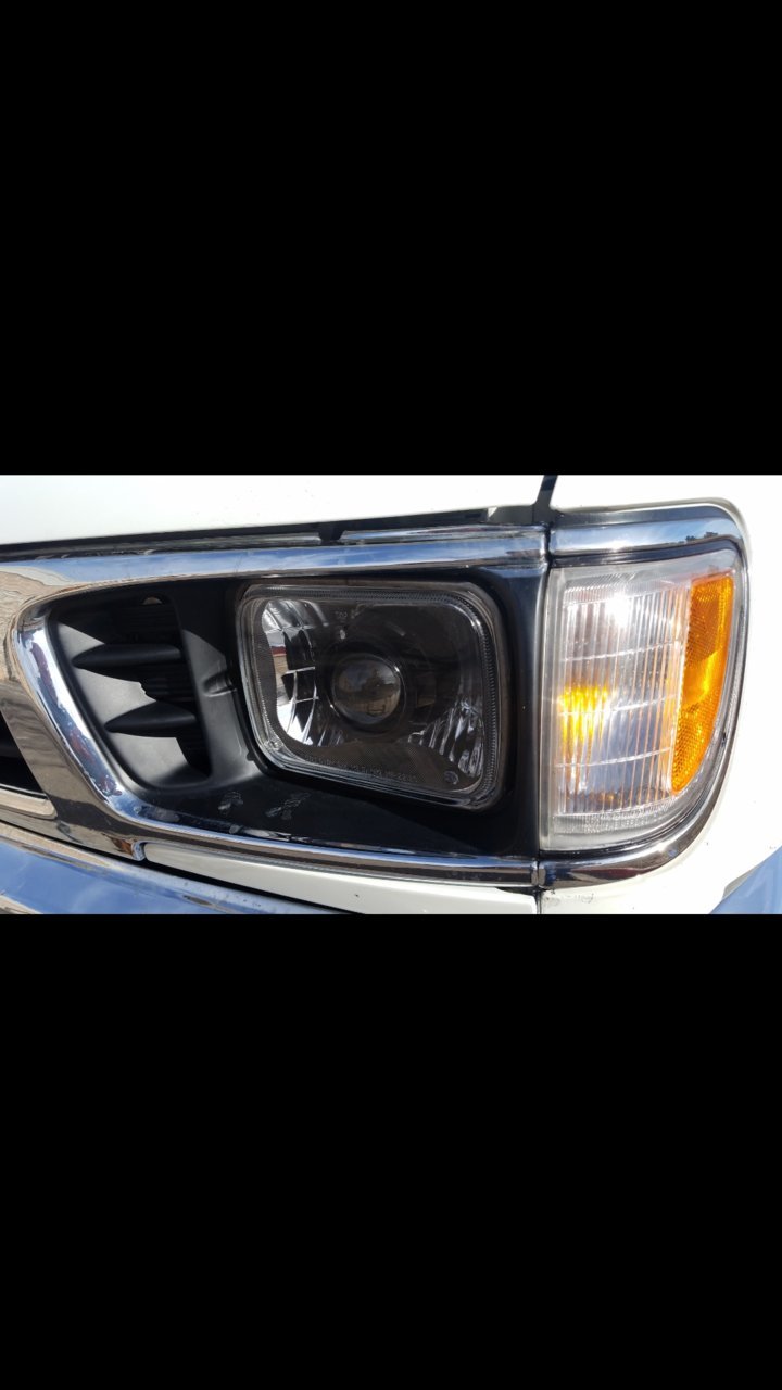

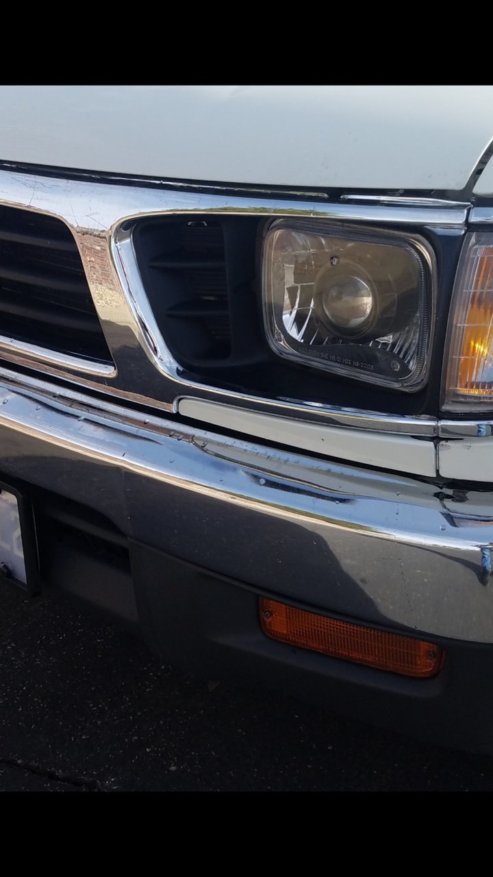

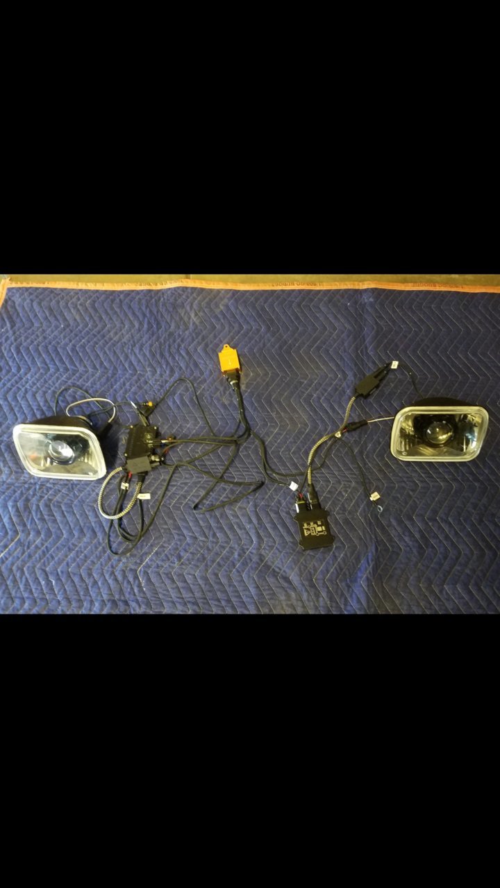

    Came out well in the end, alot more work because of the metal buckets, better quality material and wouldn't have to worry about any heat issues

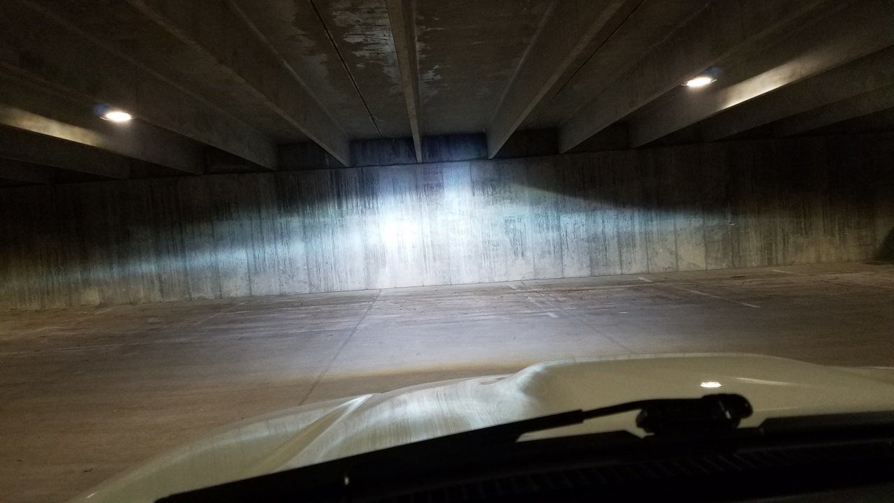

    These are definitely the BOMB,
    Didn't know what I was missing.
    Takes a bit getting used too, the High beam is SOO bright and shoots really high.
    Im having a little trouble getting the socket lined up horizontally as there is no adjustment in the headlights.
    Have to keep rotating the socket trial and error is all one can do to get the horizontal beam correct.

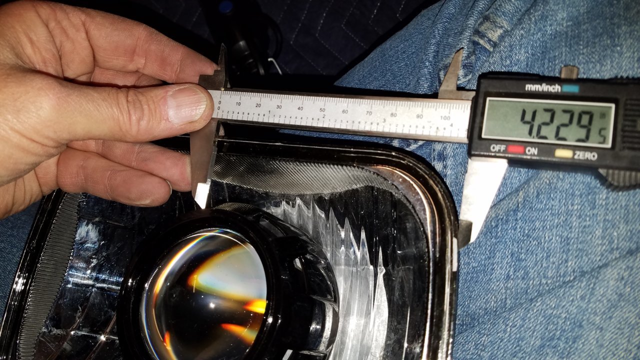

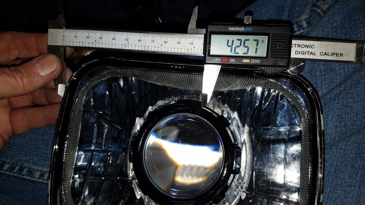

    Yea, ok, 7x6 are smaller and the mini h1 barely fits in as it is.
