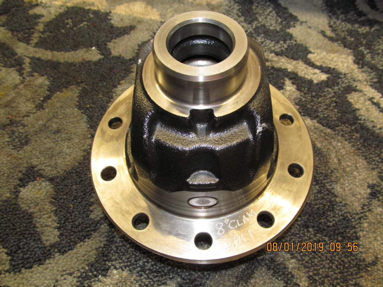

    any help appreciated
    me and ZUK are discussing wheter or not there would be an issue to do this mod, and be able to install the ecgs bushing. I dont know why it wouldnt fit but I also dont know jack about the front diff
    Athlaos likes this.

    The bearing is installed in the housing

    I understand, that's why I believe there will be no interference. zuk just wasn't positive

    yeah the tube definitely fits, I think the ecgs bushing will to. I guess Ill pull the trigger on this and see what happens. I found a torsen unit for $200

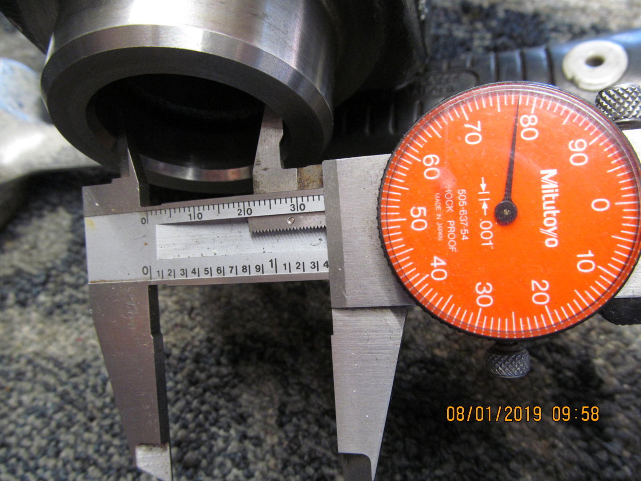

    That ECGS bushing is machined for the factory open carrier used in the clams.......there is no guarantee that it will press in the Torsen carrier without a little lathe work. GT7 and I discussed that and might need it sent to the savvy guys at ECGS for some magic lathe work. The magic # is 1.378" for the bushing.
