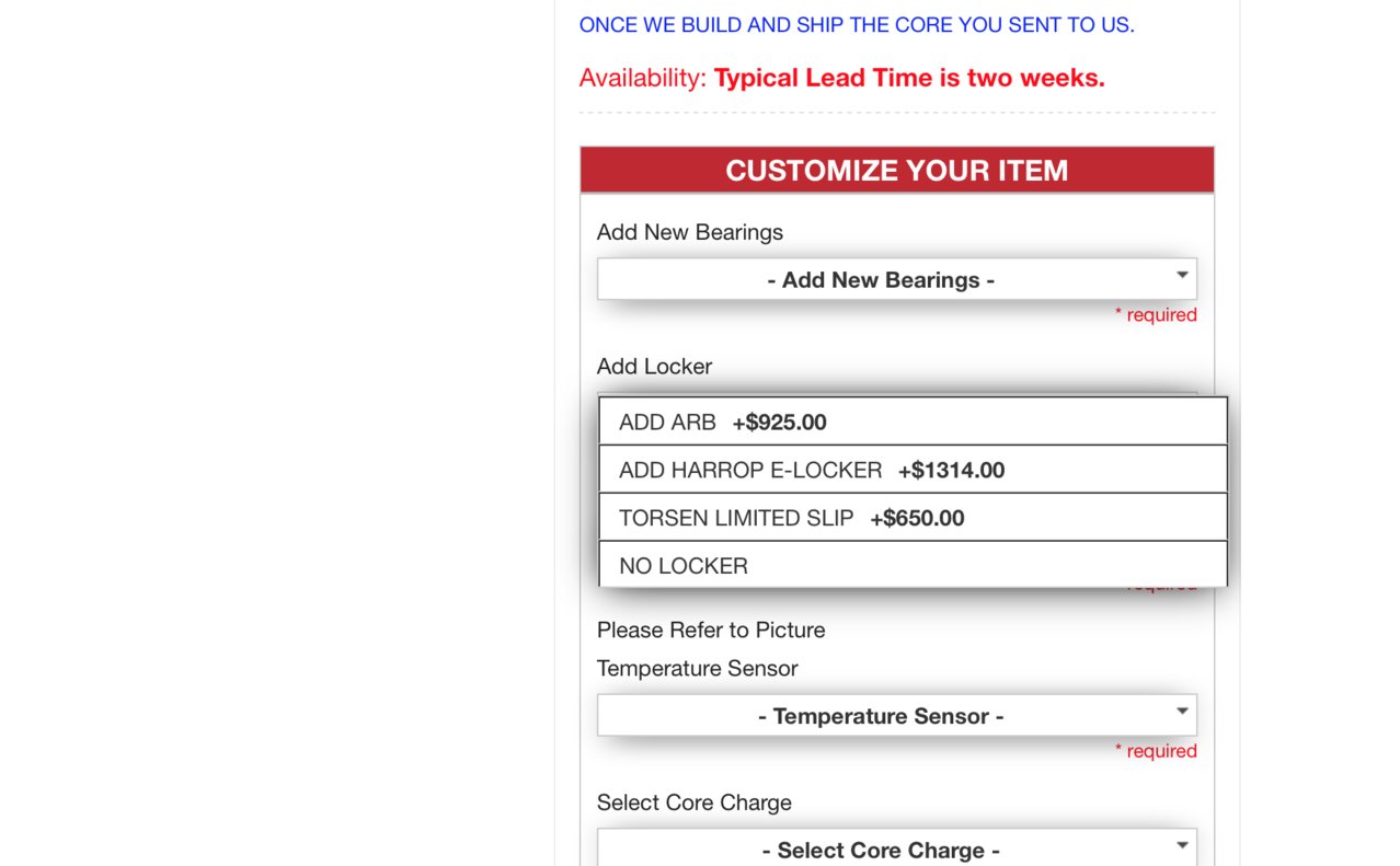

    Came across this thread and wanted to share. East Coast Gear Supply offers a Torsen for the front clamshell, I noticed it when I was putting my order in. ecgs Torsen.jpg

    Wonder if it is the same one I posted above, since I looked in the past and hadn't seen any on the market. Hence the OPs thread about how to make one happen.

    I was thinking it could be the same one too. I gave it some thought when I was ordering, I ended up with ARB. I'm fairly certain the Raptor has a Torsen in the front stock, but I'm not sure.
